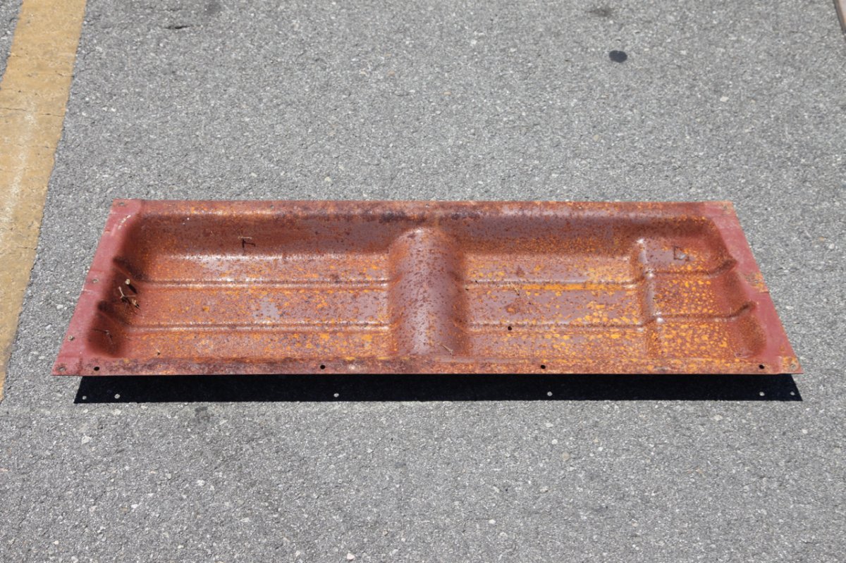

  1. Originally there was a metal pan under the seat. It was formed downward about 3 inches to provide a storage space. Something you might consider (too bad I didn't catch you sooner). This site might be useful when you do the front floorboards: http://stevewatrous.com/modelaford_p2.html

    Thanks for the heads up @Charlie Stephens If I can find one of the storage trays I'd use it. For now this will do. The blueprints will be helpful.

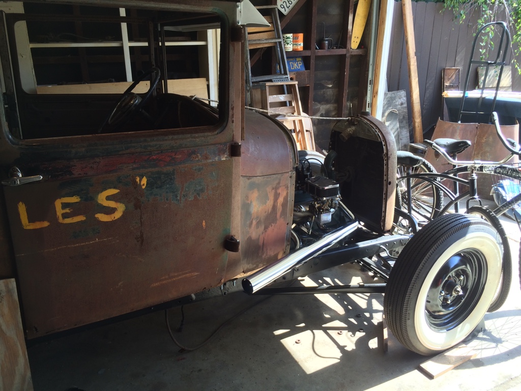

    Special thanks to Matt over at @geardrive !! Put my new lake header on and looks perfect!
    Had to make up a couple of aluminum spacers for the intake. Sandwiched them together and drilled a hole through half of each one.
    Working on finishing the floor today and hopefully have that done by tonight.

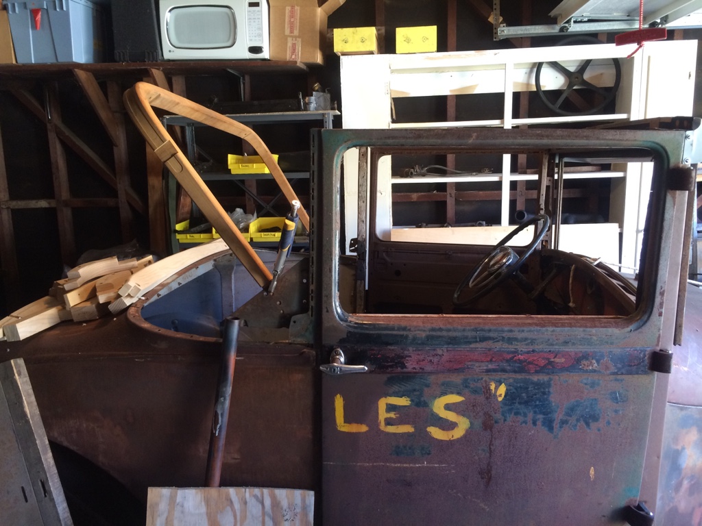

    Belt rail, rear bow and b-pillar wood on. Needs a nice size chop. Waiting to get it on the road for the final decision on how much to take out.

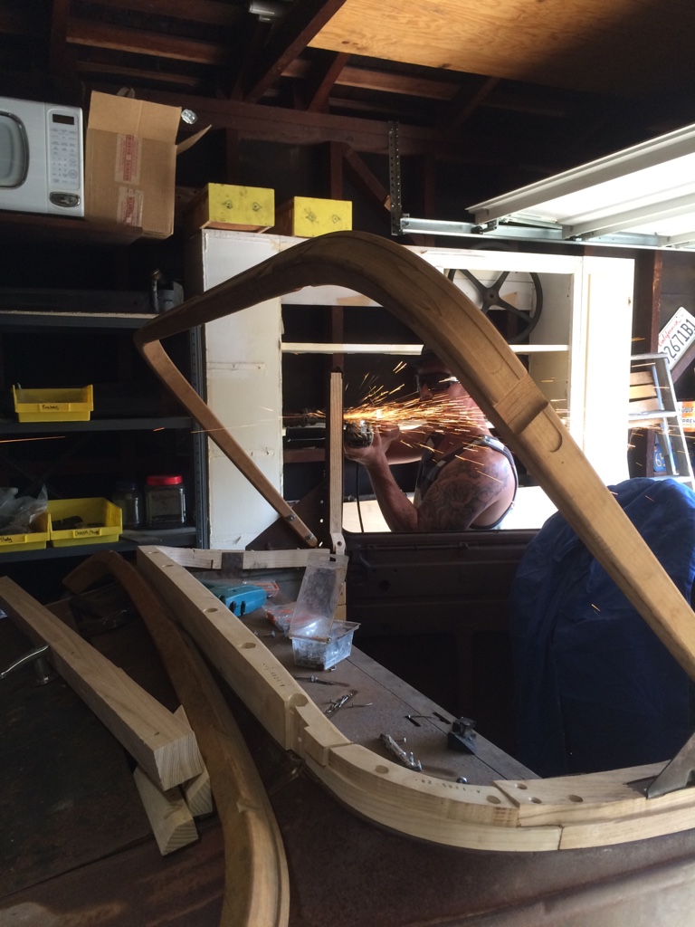

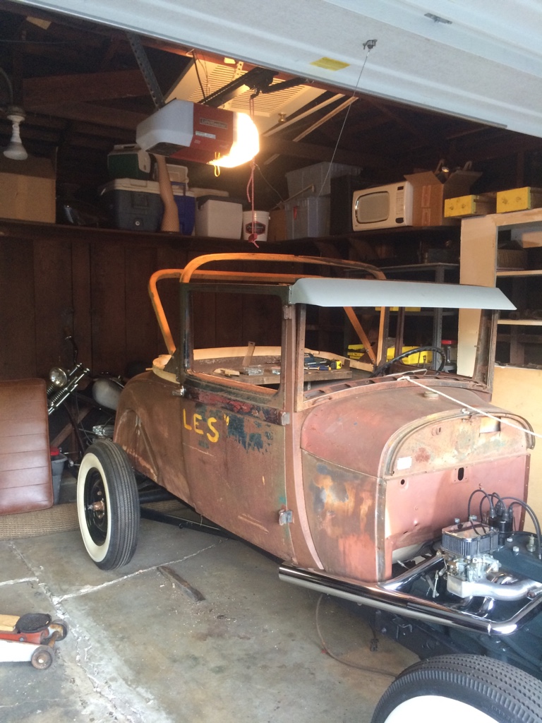

    Got after the car again this weekend.
    Finished the floor with some copper scraps I had laying around, for the battery and master cylinder access panel.
    Annnnnnd gave it a 4" haircut!
    My friend Tyler had an extra grinder so he was invited to participate in the fun.
    Pretty much buttoned up, just need to make some pie-cuts and finish a few welds then grind smooth.

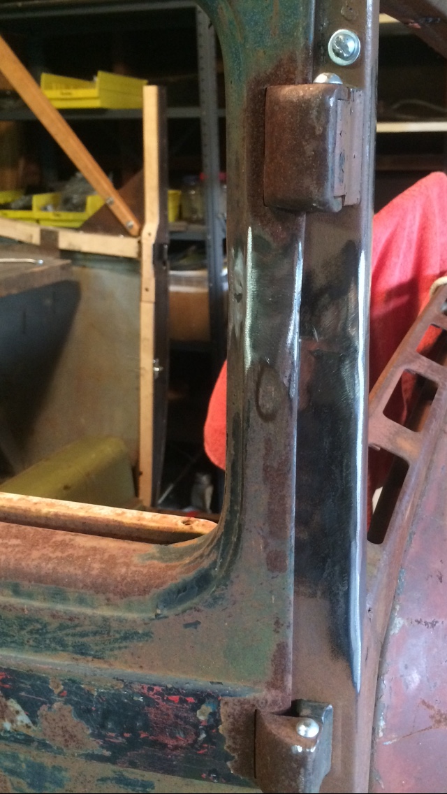

    Made some cuts to the A-pillar. Welded it up but forgot to snap a pic. Had to stop for the evening so the neighbors don't hate me.
  28. kevinwalshe
    Joined: Apr 22, 2010
    Posts: 428
    kevinwalshe
    Finished cleaning everything up last night. It's most definitely not perfect but also not the worst I've seen on a first try. ImageUploadedByH.A.M.B.1467325902.012664.jpg
