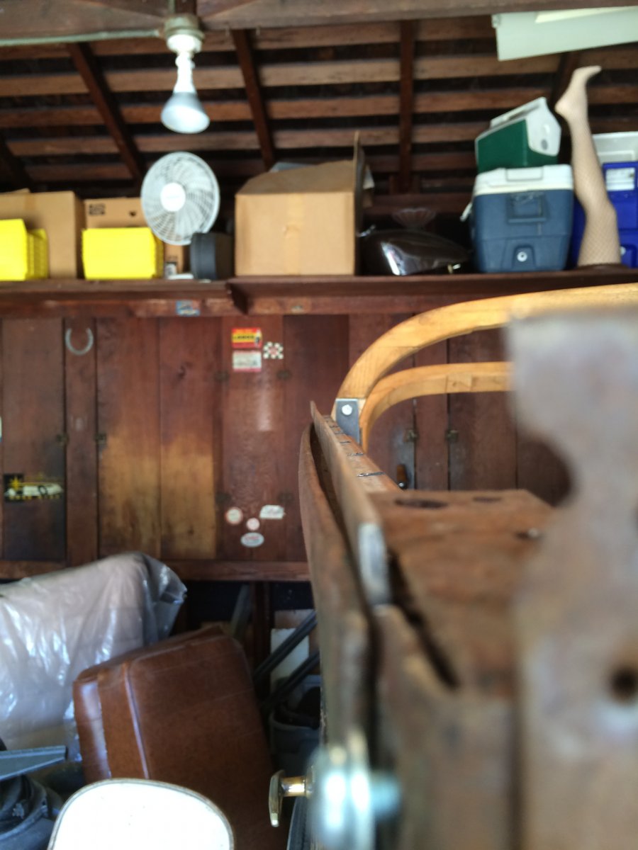

    Gas tank is still soaking with a regular rotation/shaking. Got the top bows in their final resting place. Both doors now open and close smoothly (just need the drivers side latch).
    Didn't have a shrinker/stretcher so I made some cuts and welds in angled steel to support the cowl.
    Got them to match the radius of the door pretty well on both sides.
    Drivers side:
    My plan is to cut and install wood above the doors. This way I will have somewhere to attache ****ons for a canvas top that I can easily put on and take off. Here's another shot.

    Thanks @bengeltiger I got some more done tonight. I had to cut the tie rod because after I bent the arms on the spindles it must not have been perfect and I ran out of adjustment. Cut, grind, weld, sleeve, weld.
    Got a little help from my pops last night. He got me the use of a bandsaw and table saw to cut the wood above the doors. Turned out really good by using some old-growth pine left over from my kitchen remodel. The wood has the tightest grain I've ever seen.

    Some lady that lives with me and has a ring on her finger has been getting upset about my mess. Anyway, after cleaning the yard I mounted up the wood above the doors for the top to secure to.

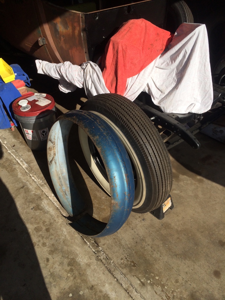

    Picked up a spare tire cover for my soon to be cycle fenders in the front.
