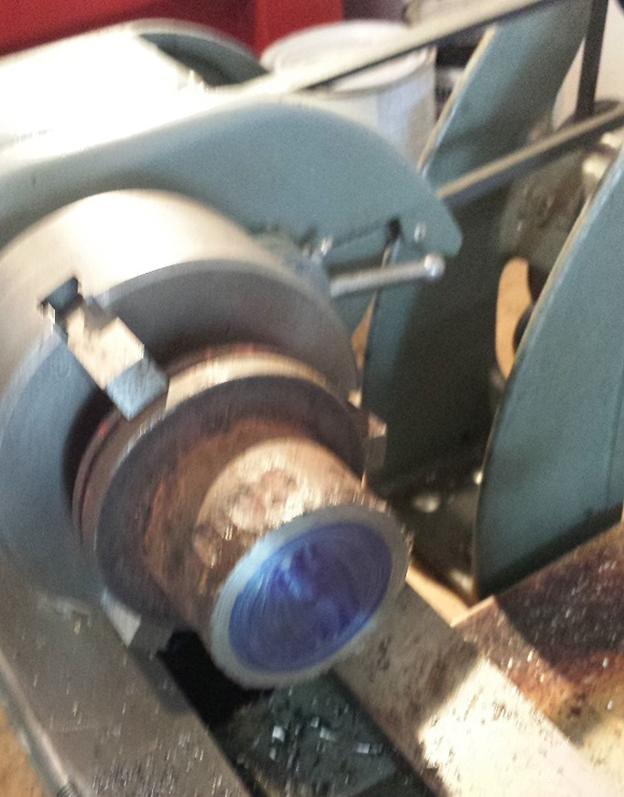

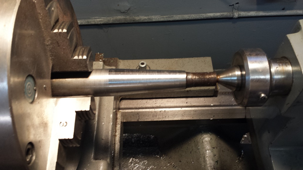

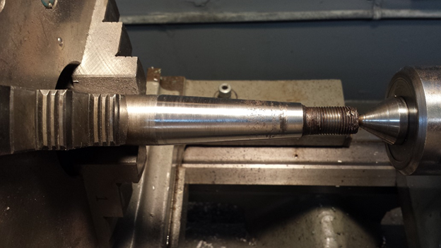

    Took a couple Axles over to my buddy’s shop Wednesday night, he has a lathe big enough to chuck the axles in, and gave the tapers a polish. I’ll select the best two.
    I started with 80 grit, then 120 and finished up with 240 grit. I still need to give the axles a good cleaning and will lap the hubs to the axles when I get that point to finish them up.
    This one didn’t make the cut – Here’s the before
    And the after
    This one had some pits and came out ok, but I have better. Here’s the before
    And the after, this one should be serviceable and I’ll keep as a spare
    This one looked ok – The Before
    And the after – better has a little put at the end
    This one looked good before polishing.
    And looks great after

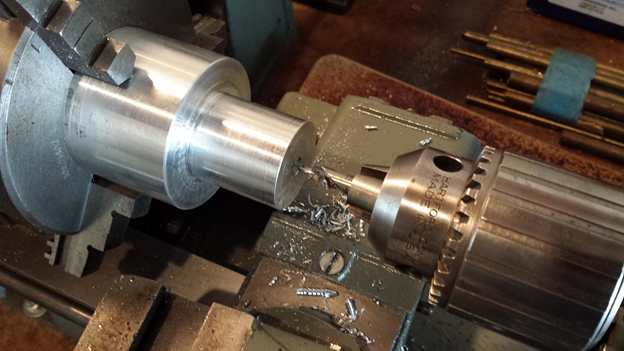

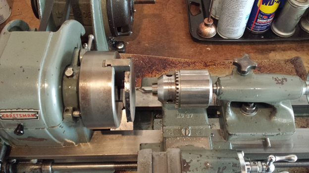

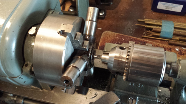

    Even though I have a bunch of parts that still need cleaning I decided to spend the day today making the carrier pre load tool. A seasoned machinist probably could whip one up, a seasoned machinist I am not. just learning as I go, and remember always wear safety gl***es.
    First I started with a 2 inch diameter chunk of aluminum, that I "borrowed" from my buddy's round stock pile.
    One side wasn't cut straight so I started facing the end
    Then after a bunch of turning and making many aluminum bird nests, we have a alignment bushing.
    Smaller diameter fits in axle tube and is 1.25” in length and 1.20” in diameter.
    Time to drill it. Always start with a center bit
    I used a “T” drill bit from drill set. It’s a tad large than the 5/16 threaded rod.
    Fits like a glove!
    Time to drill out the spare pinion yoke. Originally I thought I would drill from the side that already had a hole but I just couldn’t get it to sit flat. Flip it over and all was well. Started with the center drill.
    Now I got lazy and forgot to take picture of tapping, tapped it 5/16, beveled the end of the threaded rod, threw on a couple nuts and viola, carrier pre load tool.

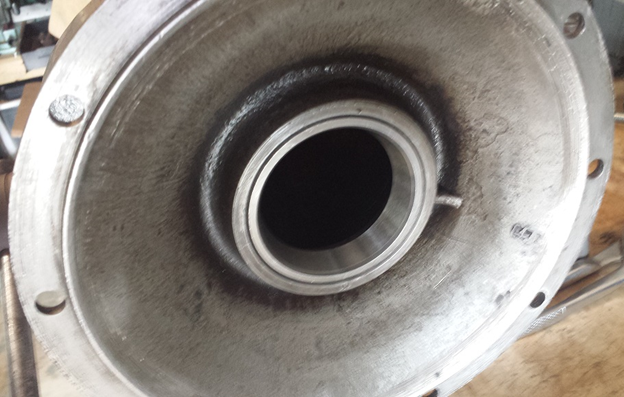

    At this point I figure I would install the bearing races in the axle tubes. Only one problem though
    Time to clean up and figure out what to do about this.

    Not bearing a person that likes to be defeated I had one of those Ah Ha moments after a few cups of coffee this morning. Well if KRW could make a bearing race install tool so could TJM. I already had the carrier preload tool and figured it just might work as a race installation tool with a different attachment.
    So I dug around in the s**** pile and pulled out this nice flat round that was a little bigger in diameter than the bearing race.
    Next to drill the center and instead of trying to mark the center and drill in the drill press I just chucked it up in the lathe. Just had to swap the inside jaws to the outside jaws on the chuck and viola! Used a center bit to get things started.
    Grabbed a 7/16 drill bit as I had used 7/16 threaded rod on the preload tool. I didn’t have a machinist length bit so grabbed a normal ever day drill bit. This isn’t a precision job and it worked out fine.
    I give you the TJM Ford Banjo Rear Axle Tube Installation Tool!!!
    Now for the BIG test, let’s see if it actually works. Mounted the axle tube in the vise.
    Started the bearing race by hand and bolted on the end plate of the installer tool. Never mind the aluminum hammer. :)
    Started tightening the bolts from the other end and holy **** it actually started pulling in the bearing race. Once I couldn’t tighten any more I backed everything off and took look. Shined a light in there to check to see if it was seated all the way and looks good.
    Now while I am strutting around the garage like a proud pea**** pleased as punch I realize I didn’t install the grease seal inside the axle tube.
    So now armed with the seal install tool, this one I bought, and a length of pipe I installed the seal very carefully not to nick my newly installed bearing race.
    Next axle tube I installed the seal first then the race. It will take a few good whacks to get it seated. The sounds goes from a ringing to more of a muffled plink when it is all the way in.

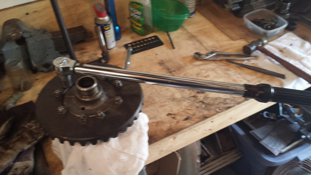

    Now on to the carrier ***embly to set preload.
    I had previously given everything a good cleaning but I went back over everything to give it a GREAT cleaning. I wire brushed out all the bolt holes and bolt threads. I then sprayed everything down in brake clean, carb clean, and Mas Air cleaner as I ran out off one.
    After figuring out what side of the carrier the ring gear goes on, it’s the one without the pin, I dropped the ring gear on and grabbed the modified yoke for the preload tool. Note do not install spider gears or axles at this point.
    During dis***embly I marked both halves with a punch so everything would line up correctly going back together. I started bolting it together and with everything nice and clean the bolts dropped right in.
    One thing I have found during this project is Old Henry used precise machined holes and if something doesn’t go in nicely the bolt is dirty and/or bolt hole is filled with crud and needs to be cleaned out.
    After running all the nuts down by hand torque to 35 Ft Lbs.
    Now that the carrier is bolted back together.
    Time to press new bearings onto the carrier, but firsts things first. I needed to find a piece of round that I could use to press the bearing on. Dug around in the s**** pile and found what I think used to be skids for a snow plow. This just happened to have the same diameter as the center collar of the bearing. Perfect! But….
    Thinking a little more I realized the center of the carrier protrudes just a bit above the bearing once it’s installed. Being that I love making things on the lathe time for a little modification to this lump of metal.
    Chucked it up in the lather and faced the end to make it nice and flat.
    Next I held the bearing up the newly machined surface and marked the end with a blue sharpie. This would tell me the area I need to bore out to fit over the center of the carrier end.
    At this point I actually centered and drilled the piece of stock, then made a few p***es with the facing tool till I had removed enough material that with fit nicely over the end of the carrier.
    It’s not pretty but it works!
