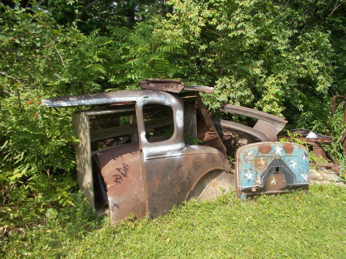

  4. sloppy jalopies
    Joined: Jun 29, 2015
    Posts: 5,256
    sloppy jalopies
    Will trade a left coupe quarter that "needs", for the sportie qtr you have before you cut it.... i am at mile 75 of I95... DSCN7323.JPG DSCN7188.JPG DSCN6830 - Copy.JPG

  5. sloppy jalopies
    Posts: 5,256
    sloppy jalopies
    The '28-'29 sc beltline beads have squarer edges and no bead that runs across the tulip panel...also no bead around the wheelwells ...
    did you buy them as sport coupe quarters or as '30-'31 sport coupe quarters ?
    '28-'29s have a different bead from the B pillar to the rear.... and don't have the bead across the tulip panel... they also only have one bead from the B pillar back...
    please post a pic... '30-'31 sport coupe shown...
    .cabriolets were different still...
    oddly they used the same quarters, tulip, decklid and panel below from '29-'31...

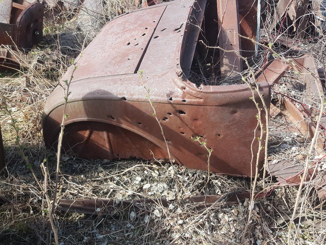

  8. Gigantor
    Joined: Jul 12, 2006
    Posts: 3,818
    Gigantor
    dana barlow likes this.
  9. sloppy jalopies
    Posts: 5,256
    sloppy jalopies
    That is a '30-'31 roadster quarter, check the distance between the trunk gutter beads and the lower beltline bead...
    the roadster tulip panel is about 10"...the sport coupe is about 5"...
    note the beads in the wheelwell do not touch at the top... roadster only.
    on coupe, sport coupe and cabriolet they do...
    post pix of your damaged qtr,
    i'll look to see if i have any small pieces for repair...
    '30-'31 sport coupe, front... '29-'31 cabriolet background...
