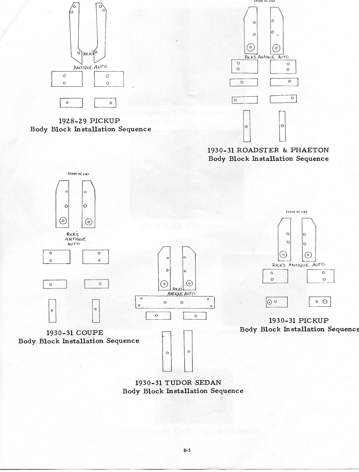

    I got a box o' blocks with my '30-31 Brookville body with no instructions as which goes where? Does anyone have pics showing where they get located? Or seen an online diagram? Or should I just call Brookville?
    Thanks

    Take a look at this link, http://www.jalopyjournal.com/forum/...of-model-a-wood-body-mounts-installed.632616/ Scroll down to entry #9 by Slick Willy. Hope this will help.
    Bob

    It may not be necessary to use the blocks, but you will be glad you did when it comes time to adjust the doors for fit. Attached is a diagram for the blocks.

    Thanks, this was the info I was looking for! Does anyone have a pics of wood alternatives?
