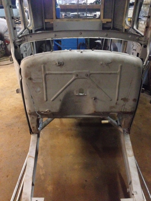

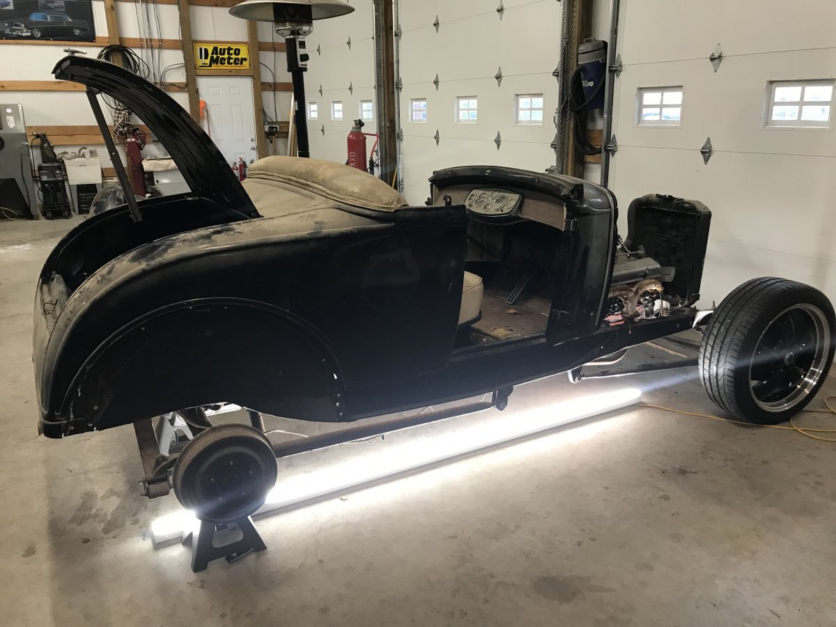

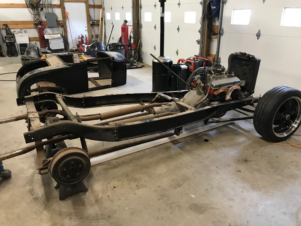

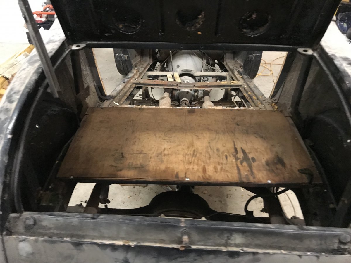

    Just registered.
    I have an old 1960’s era Street Rod that I inherited from my late Dad that’s been in the family (and in storage) for 40 years. It appears to be a 1931 Model A body on a chopped up ‘32 ch***is/frame and it is full-fendered. I want to keep it this way. I’m having it completely re-done, and here’s my problem: most of the experts I have talked to say that you can’t use fenders when putting a Model A body on a Deuce frame. You can only build it High-Boy style.
    Can you all look at the pics attached and verify that I have what I think I have, and let me know if there are any tricks to look out for? I want to buy a prefab ‘32 rolling ch***is from Pete and Jakes and they are saying I can’t use fenders. Thanks everyone.

    big duece
    from kansas
    What's wrong with the frame in the pics? Change the wheels, and you will have a bad *** hot rod. Wash it, then drive... repeat.

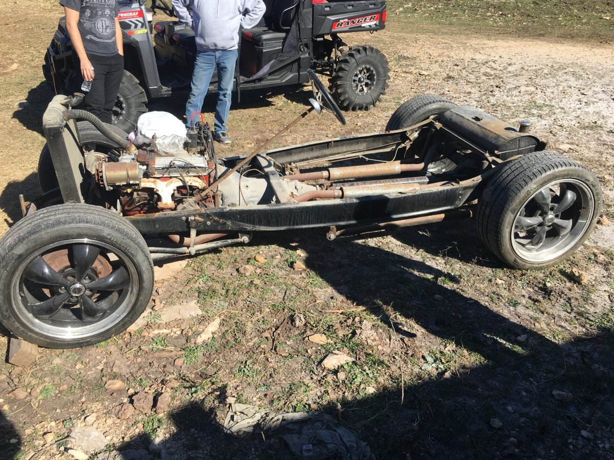

    The guys doing the rebuild said it wasn’t safe-lot of cuts and bad welds.

    from kansas
    I would question that idea with another opinion. Original frame and numbers is worth preserving if possible. Its just metal. Cut, weld, grind, repeat. '32 front fenders and running boards will mate up fine to the ch***is, only where the rear fenders meet the quarters might be an issue. Can't say I've seen a A body with deuce fenders.

    from ohio
    fix that frame and put it back together looks good --needs rims/tires changed don't get in too deep

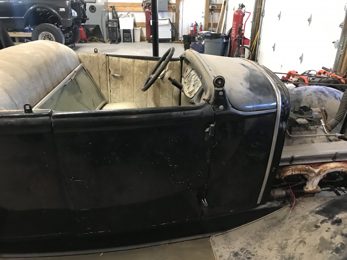

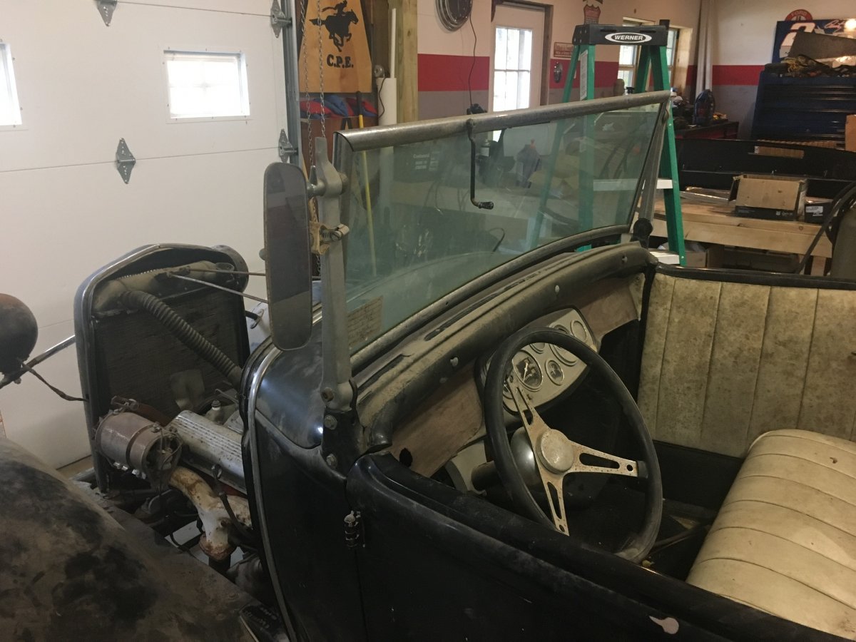

    Any close ups of the gauge panel? Looks cool as hell
    kidcampbell71 and Stogy like this.
  8. RiffRaffRoadster
    Joined: Dec 24, 2018
    Posts: 450
    RiffRaffRoadster
    I researched it for hours the other night and finally found it. It’s from a 1933/34 Pierce Arrow! I agree it’s cool.

    from california

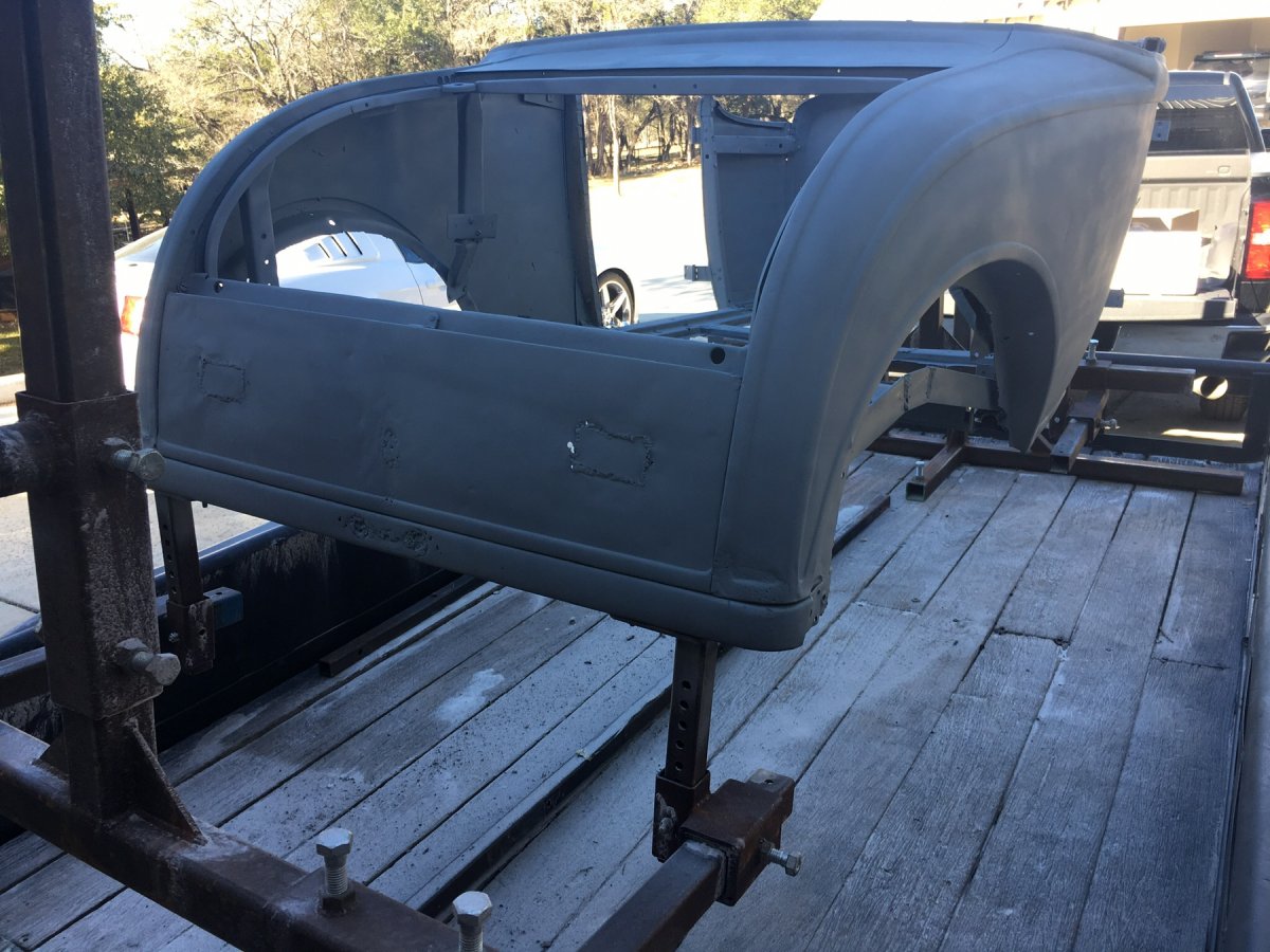

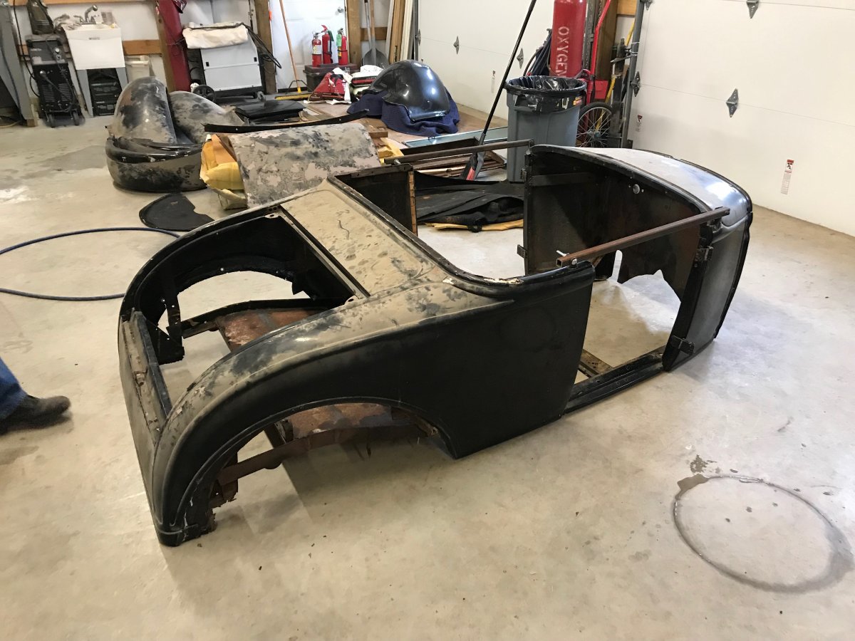

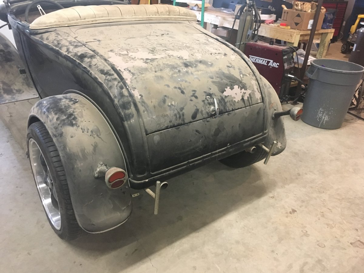

    Yes it can be done, heck your dad did it !
    I did a 29 roadster that way.
    '32 frame, fenders, & running boards, with the A body.
    with the fenders in the stock '32 placement, Set the A body on so that the rear fenders line up correctly with the body.
    When you do that you'll find that the firewall ends up in just about the perfect place.
    you will need a special height radiator & a special hood.

    Stogy
    You are very fortunate to have inherited your late fathers Hotrod. Generally the frames are boxed or partially boxed when upgraded to a Smallblock Chev. That is a 32 frame with a Model A Body with fenders so yes I guess it can be done...and yes it has. It's work but in Hotrod land making stuff work is part of the deal.
    Your new here...Welcome...this site caters to Hotrods built in a style or were built 1965 and older...Do you have more pics of when your dad had this on the road.
    As the other fellas have said you are better working with what you have and some of the advice at your end seems hell bent on spending money and ditching history. I ask, don't you have a desire to resurrect your fathers vision?
    Cutting that up into a streetrod is a bad idea that you should in fact reconsider.

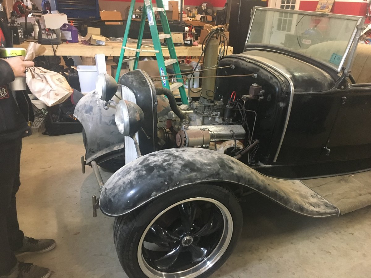

    I love that you guys are commenting on the rims and tires! The car originally had some old “Rally” style wheels. The shop guys just put these on to roll it around. Ugly-I agree.

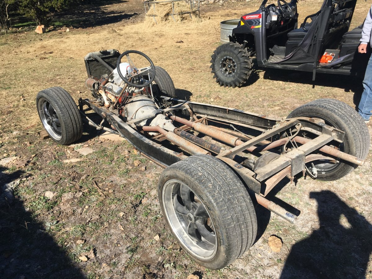

    I wanted this to be a driver, and safe. I would prefer to get a stable foundation under this thing.

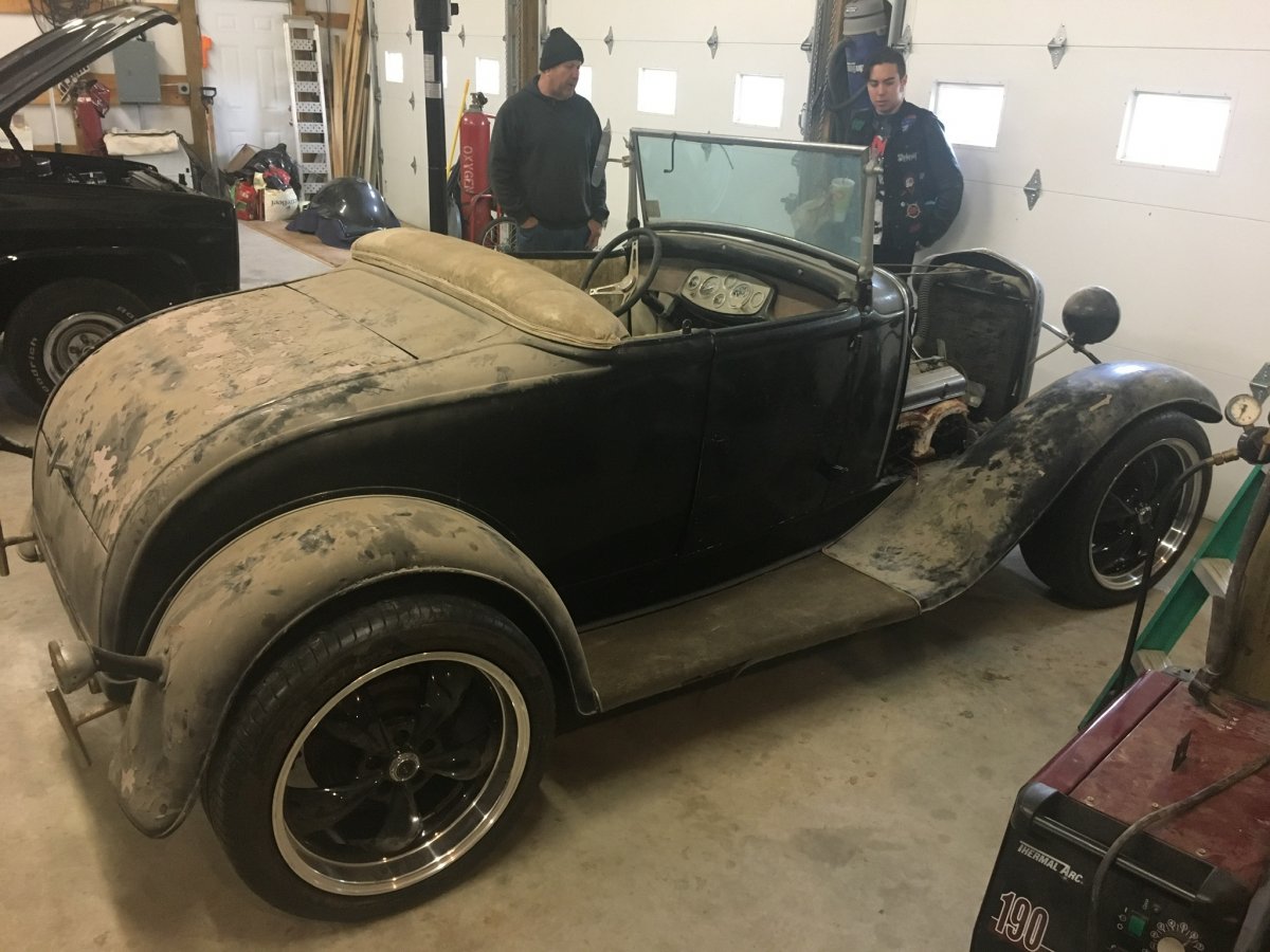

  15. I wouldn't have taken that car apart! Have the shops you talked to seen the finished car? I mean you have a Model A on a 32 frame with fenders, so somebody did it! That car just needs a good going over. Where are you located? Maybe you don't need an "expert" but just a couple of local Hotrodders that can help you out.

    Here are the wheels it had on it when my Dad bought it.

    Um, way better than the first pics... hotrod hard on there

    from kansas
    A "good" shop or hot rod rebuilder can make that frame safe and still preserve its history.

    31Apickup
    I think you've been talking to the wrong "experts". It looks like the frame has not been pinched which is usually done on fenderless model A's on 32 frames. If it was pinched, then the fenders were modified. You have a really nice period piece including the wheels that were originally on it. Even if there is some sketchy work done to the frame, that can be cleaned up and made safe. I would look up some of the Texas folks such as Brian B***, Keith Tardell or Austin Speed Shop who know traditional cars.

    mgtstumpy

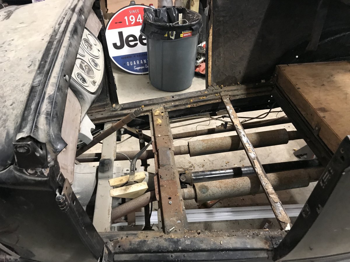

    Like a doctor, get a second opinion, cross members are easy to replace. Add a decent X-member and maybe split the firewall to widen the Model A body so it fits the 32 frame better. This is how HAMBER 'Flop' did it.

    RiffRaffRoadster
    Thanks! Would the Model A body fit on the ‘32 frame without being pinched? I thought he 1932 body was wider.

    RiffRaffRoadster
    My hunch is the frame was pinched and the fenders were modified to fit.
