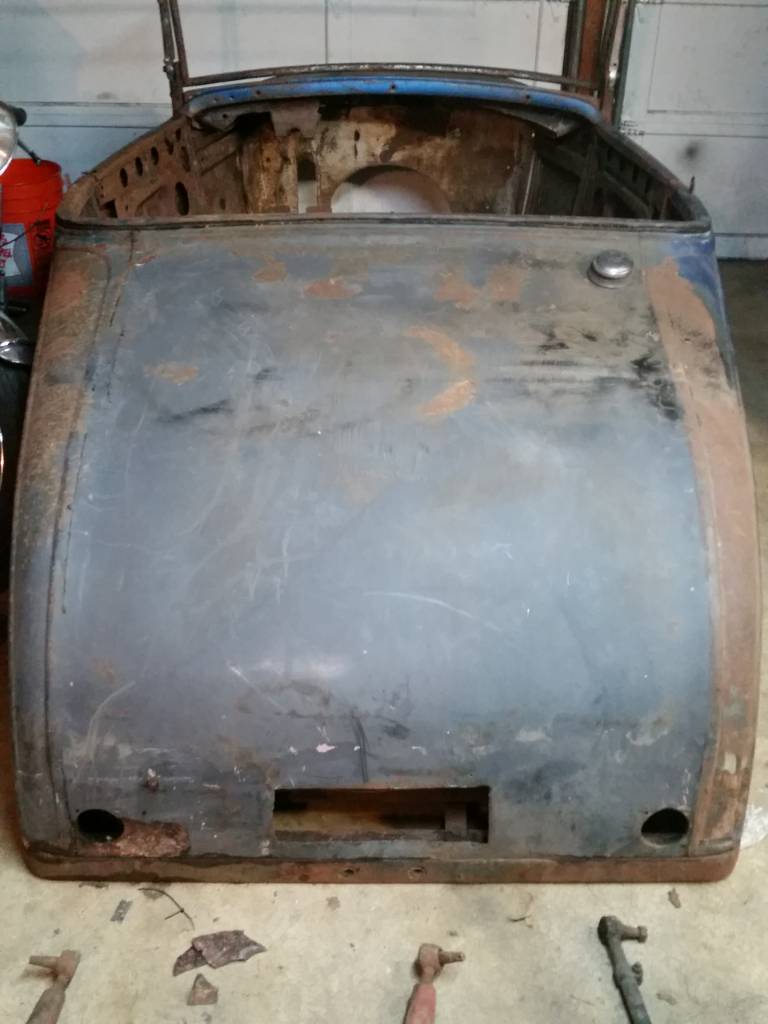

    That’s where I’ve seen them in photos-filler cap centered on panel above trunk
    loudbang and Stogy like this.
    Sent from my SM-G965U using The H.A.M.B. mobile app
