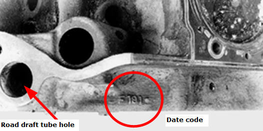

    Look at the ends, (either front or rear, both ends will have the same markings), of the cylinder heads. There are markings that will show what types of heads are on the engine. These markings will be a either a straight bar that is flat across the top, (2 bbl. carb.), or a straight bar that has projections going up from it. For example a triangle, (for a Power Pack, 4 bbl. carb. engine). A single rectangular tower, a double rectangular tower, etc. Later heads could have two humps, commonly called "Camel Hump" heads. These Camel Hump heads showed up in the early 1960's.

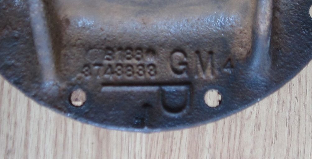

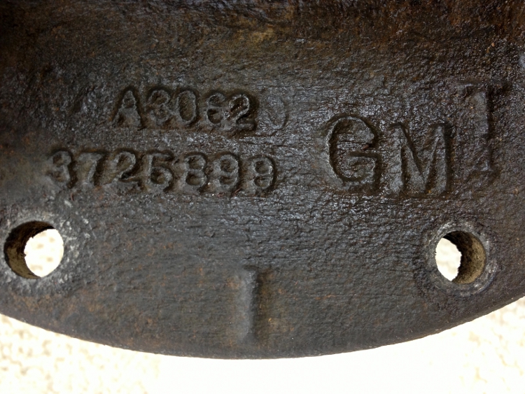

    On the major engine castings, heads, block, stock intakes, as well as the center section of the rear axle, there are date codes. Attached are a few photos of these date codes.
    If there is a big "P" on the center section, you have a Posi rear end, (or at least a Posi case). However, 57 Posi's did not have a big "P". Posi's were not available in either 1955 or 1956. The big "P" started in 1958.
    The date code in the first photo, (B188), decodes to February 18 1958. The date code in the next photo, (A3062), is January 30, 1962. Since that center section does not have a "P", it is an open rear end. All of the date codes will follow this pattern, although sometimes the year will be indicated by a single number, instead of two numbers. As in photo numbers 1, 3, and 4.
    Engine block date code, (at rear of block). June 19, 1961

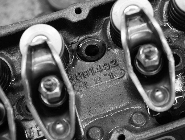

    Cylinder head date code, under valve covers.

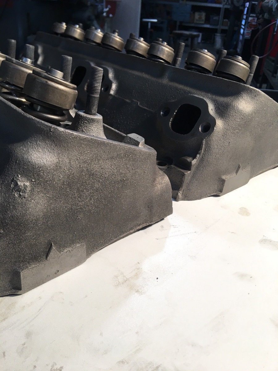

    The other photo is an example of the head marking for a 57 Power Pack head.

    The engine from what I can see from Riff's body off frame pics has a road draft hole beside the distributor and I think I see the power pack casting mark's on the heads. It may have been mentioned already but I'm just pointing this out in case it wasn't. Any starter attach point info yet? Were starter holes drilled into the block as time went on and transmissions were swapped out?
    I'm getting old but I seem to have a recollection of possibly doing this on my buddies 57 ions ago when he swapped out the cast iron auto.​

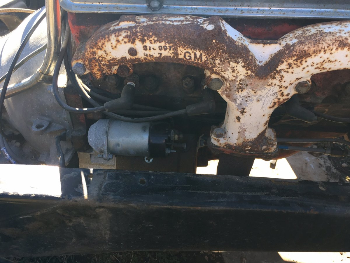

    It just hit me......An aluminum P.G. was swapped in, so it probably has a block mounted starter. 57 283's were drilled for block mounted starters. Actually, 57 Chevys with a 283 and TurboGlide transmission had block mounted starters from the factory. TurboGlides, (in addition to being ****py transmissions), were made out of aluminum.
    The cylinder head markings definitely look like Power Pack ones. Also, it looks like it may have an aluminum intake? The distributor might be from a 55 or 56??? Or a factory dual point??? It's hard to tell from the photo.

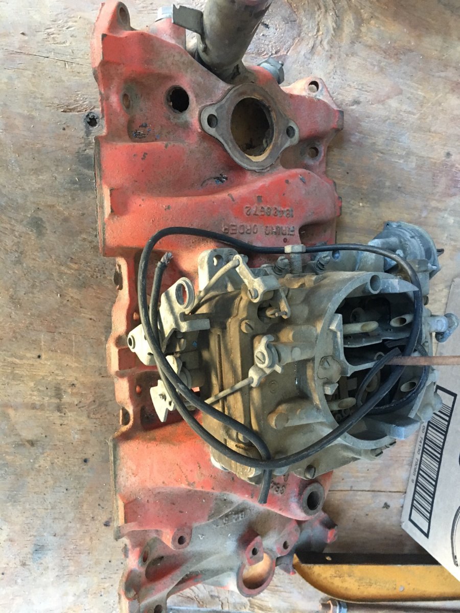

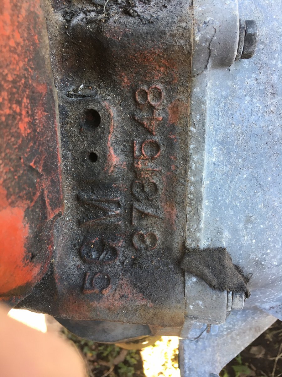

    Torkwrench-I just got back from the shop where the roadster is being kept. Attached are some photos of the engine.
    Here is where the starter is mounted:
    Here is the SN:
    And here is the original intake manifold and Carter 4 barrels carb that was on the engine:

    Engine casting # says it's a 283, built in 1957. I like where you're going with this!

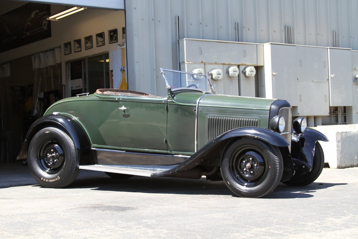

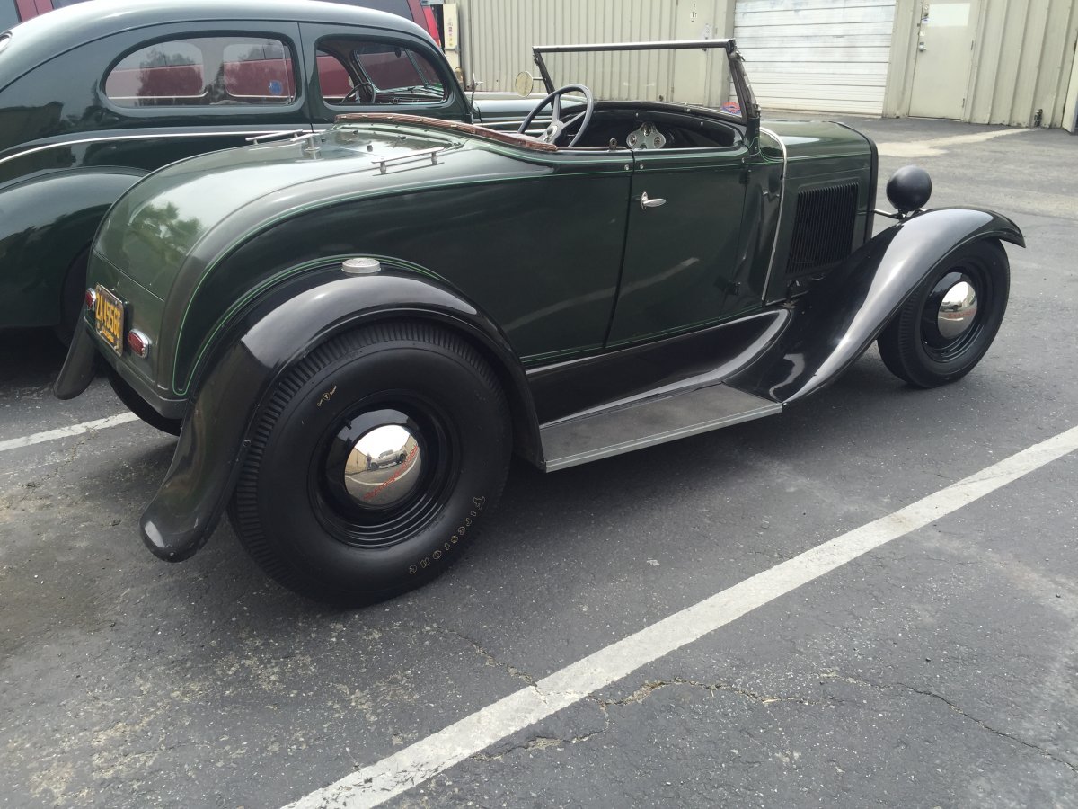

    I have looked for some Traditionally inspired vintage Roadsters. This is an inspired period build. I would suspect it's a little lower than back in the day but I think they did a very admirable job on this Hotrod.
    It is also not on a 32 frame but in reality they sit and on a quick glance look somewhat similar.
    https://www.jalopyjournal.com/forum/threads/1931-ford-deluxe-roadster.1024459/

    Very nice car. Is that the gas cap on the rear fender? Have you seen that before?
    Also has a similar paint scheme that I’m considering (black fenders with dark colored body).

    That's a step for the rumble seat, check out the handles on top of the quarter panels.

    Note the tailights too Riff...

    Duh! Should have known. I see them now.
