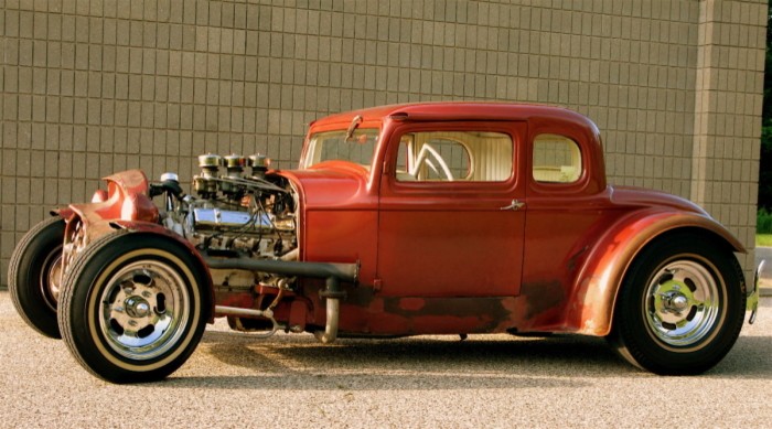

    I think you're a worry wart. Here's a 51 Ford PU ch***is a guy brought to our shop that did have a 455 Olds engine (torque monster) that he wanted replaced with an LS3. He said he thought the LS engine was more powerful maybe we should touch up the welds he'd done on the front clip and cross members. He said he had driven it 6 years with the 455

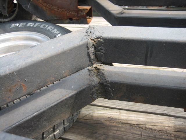

    Your close up pics reveal a 46 front axle that seems to have had the early (maybe Model A) perches welded directly to the axle. This was probably done because the 46 axle has a wider spacing between perches and the A spring wouldn't spread far enough.
    Make sure to have this area cleaned up and checked very carefully for cracks and other odd wear. This construction is not common at all, and actually looks a little dangerous if the builder used poor talent. But, it has been driven many miles and years, and not fallen off yet. It might last another lifetime if the welds are solid.
    If somebody (a good rod shop, not a 1-800 street rod shop) recommends replacing it due to poor technique, I'd say a slightly dropped A axle with stock perches would probably fit in the exact same space and give the same stance. I'm guessing the 46 axle was used because it has a slight drop over a stock A axle.

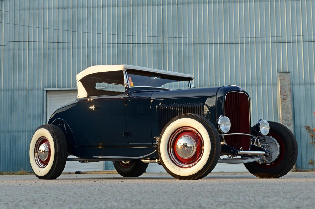

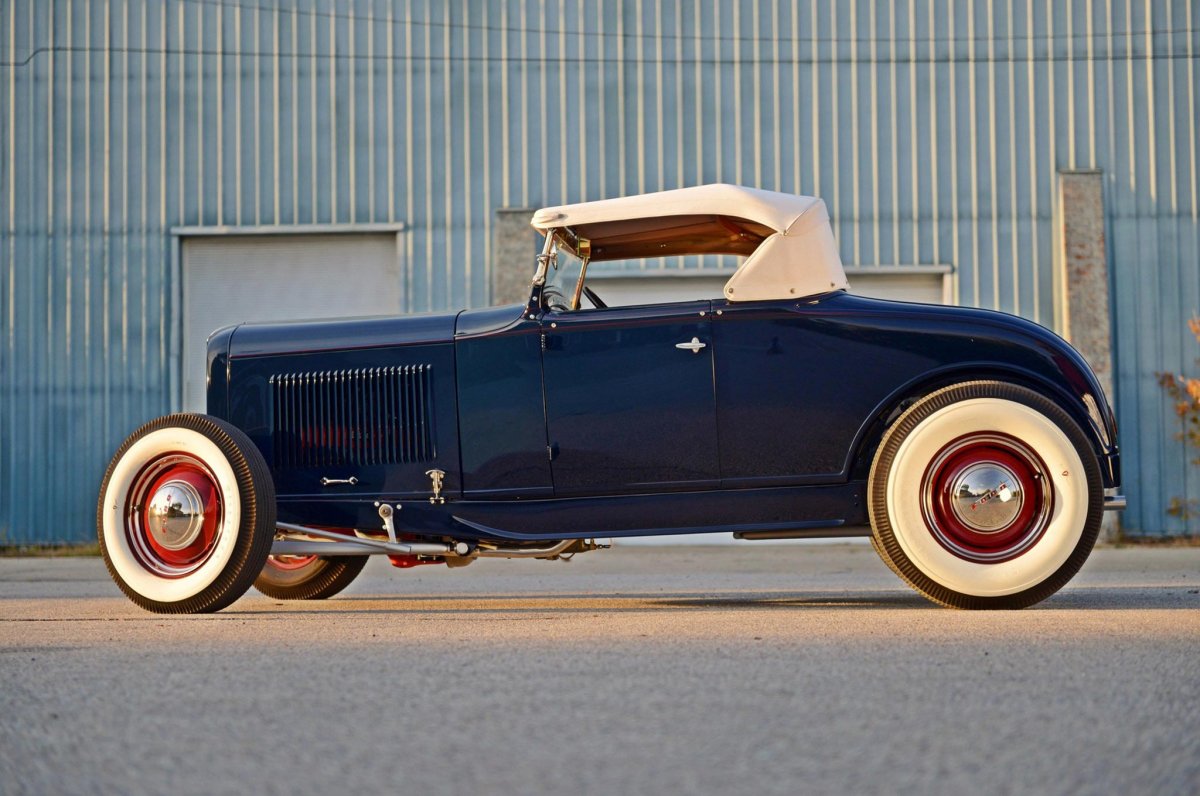

    Sorry they looked pretty close...maybe these are...era similar to yours by the way...this Hotrod graced the earth in 1956 but those wheels and tires are later middle 60s upgrades I think.
    Riff definately try the clean up methods there is threads on doing that I think. The rims on this one look great but aren't spot on either.
    Personally I like the driven look myself...aged doesn't bother me others can't stand it...its a personal thing I guess.

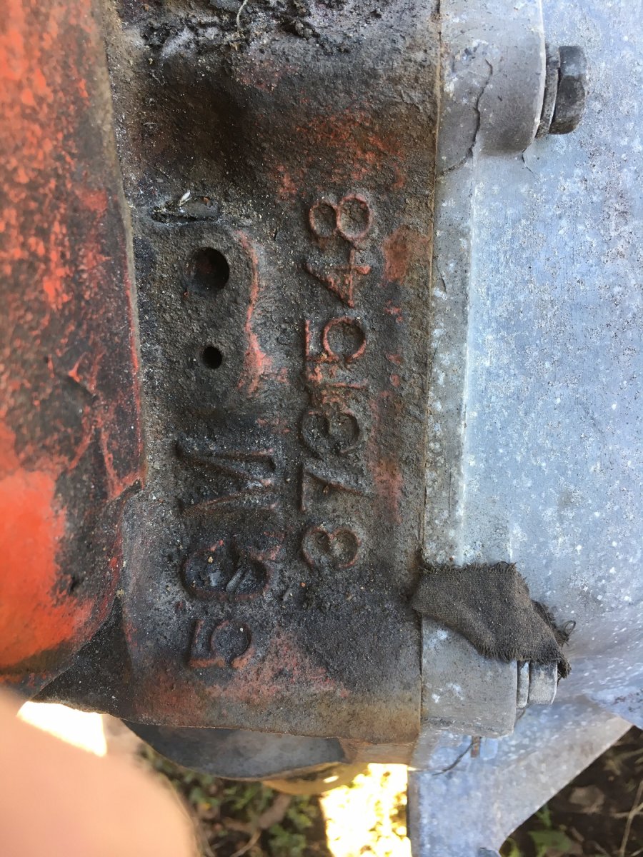

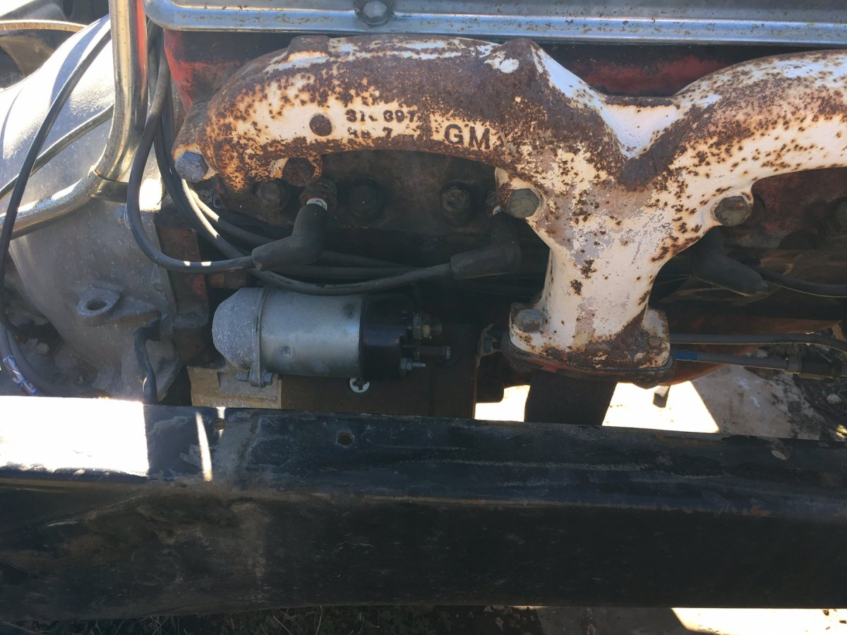

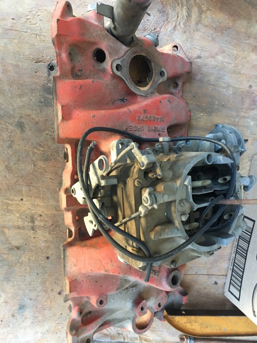

  10. Torkwrench
    Joined: Jan 28, 2005
    Posts: 2,752
    Torkwrench
    From the extra photos, it's definitely a 57 block. There are not any bolt holes around the front freeze plug. That's where the side mount motor mounts bolt up. Not side bolt holes = no side mounts.
    The heads have the Power Pack markings. However, those markings were used up through at least 1964. Did you notice if the valve cover bolts lined up, from top to bottom? If they line up, the heads are mid-59 or newer. If they are staggered, they are mid 59 or older. Here's a photo of valve covers with staggered bolt holes
    The Carter carb is 1960's. The date code on the original intake looks to be B 2 5. That would be February 2 1965. This is the day that the intake was cast at the foundry. The aluminum intake that is on the engine could be either factory Chevrolet, or aftermarket, (for example Edelbrock, Weiand, Offenhauser, etc.) Is there a name such as these, cast into the aluminum intake? The original cast iron intake and Carter carb. probably came off of a 327.
    From the close up photos of the steering wheel, the distributor is either a 55 - 56 Chevy, or a 57 dual point. This was figured out, by the clips that hold the cap onto the distributor. Chevrolet brought out the "Window" distributor in 1957. The "Window" style caps are attached differently than the 55 - 56 distributor caps. The higher horse power 1957 283's that had dual point ignitions, still used clips to hold the dist. cap on, however.
    As has been mentioned, the rear axel is a Chevy. There is not a drain plug that is visible in the photos. The 55 and 56 rear axle housings did not have drain plugs. 57 to 64 housings did have a drain plug. 55 and 56 housings are the same, and use one type of wheel bearings. 57 through 64 housings all use the same bearings, but these bearings are different from the 55 - 56 wheel bearings.

  13. Kerrynzl
    Joined: Jun 20, 2010
    Posts: 3,611
    Kerrynzl
    The 3731548 is a highly desirable block. The Tri-5 boys would kill for that.
    It can be either a 265 or a 283 [they used the same casting] and the 265 can be bored to 283 without sonic testing
    The 265's were painted Charteuse Yellow/green and 283's painted Orange.
    It is the only year 283 made without bosses on the side for engine mounts [it used front mounts]
    The other 2 years without bosses were 55 & 56 but they were 265" only
    The 57 SBC was the year that GM made an improvement modification to the rear cam bearing for constant flow to the lifter gallery [previous years had pulsed flow and required a special cam]
    The only bug with rebuilding early 283's, is you need a special freeze plug in the rear cam, and they have a rope rear main seal [a conversion is available and recommended]
