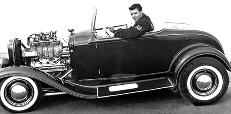

    ...and proof that A Model A body on a Deuce frame with ‘32 fenders was a “thing” in the ‘50’s.

    Not to be a smart-***...but me thinks it has 1-2" out of it...What's @big duece's take on it...and its packing a 409 for motive power too...or is it a 348?...
    The angle I believe is user set...I'm still waiting for some A Roadster Hambers to set me straight...:confused:...:D
    Your's and the Kerr Roadster are stock height...angle whatever you want​

    I think Stogy has an eagle eye. I too think the windshield is chopped on the A roadster in the RJ posters after studying the OP's first pictures of windshield before tear down.

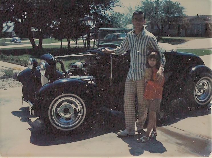

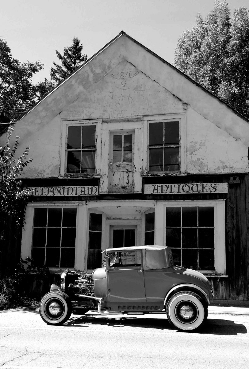

    Thank You...Riff...not to pile up your thread with other stuff but this is a loose theme on your Hotrod and the Hamb and, and...;)
    It is an inspired Hotrod built in 2010...aviation inspired, not overdone...and quite frankly I've followed @cactus1's no changes philosophy with it...why? For the simple fact what you see is why I liked it in the first place. Theres work to do but it's unseen stuff here and there. Here's the thread below but the red x's have really affected this thread although I added as many pics as I could find near the end. Jerry does very thorough threads and builds really awesome vintage Hotrods...;)
    Short list of details...
    29 Ford Sport Coupe, 327 Chev V8, 57 Chev Rear End, 6x2 Edelbrock X1 Manifold,
    with Holley 94's, drum brakes all around, transverse springs front and rear. It's noisy and fun...that's about it in a nutshell...oh and it's chopped about 3" has 50 Pontiac tailights and 29 Cadillac headlights up front. Oh and Bias Ply reproduction Firestone Piecrust www from Coker Tire

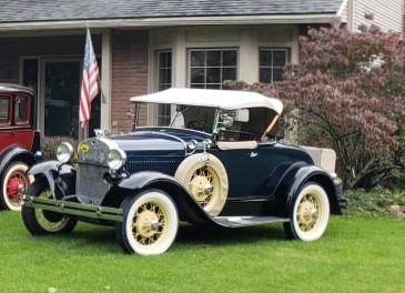

    jimgoetz
    Looks like it to me. This is my stepfather's stocker. Kind of hard to tell from the picture thou. Next time I get down to see him I'll measure it . Resized_20181022_172315003 (2).jpeg

    didn't model a's have two different height windshield posts stock? standard and deluxe?

    Correct for a 30/31 Model A. Deluxe were about 2 inches shorter. The 28/29 were all the same.
