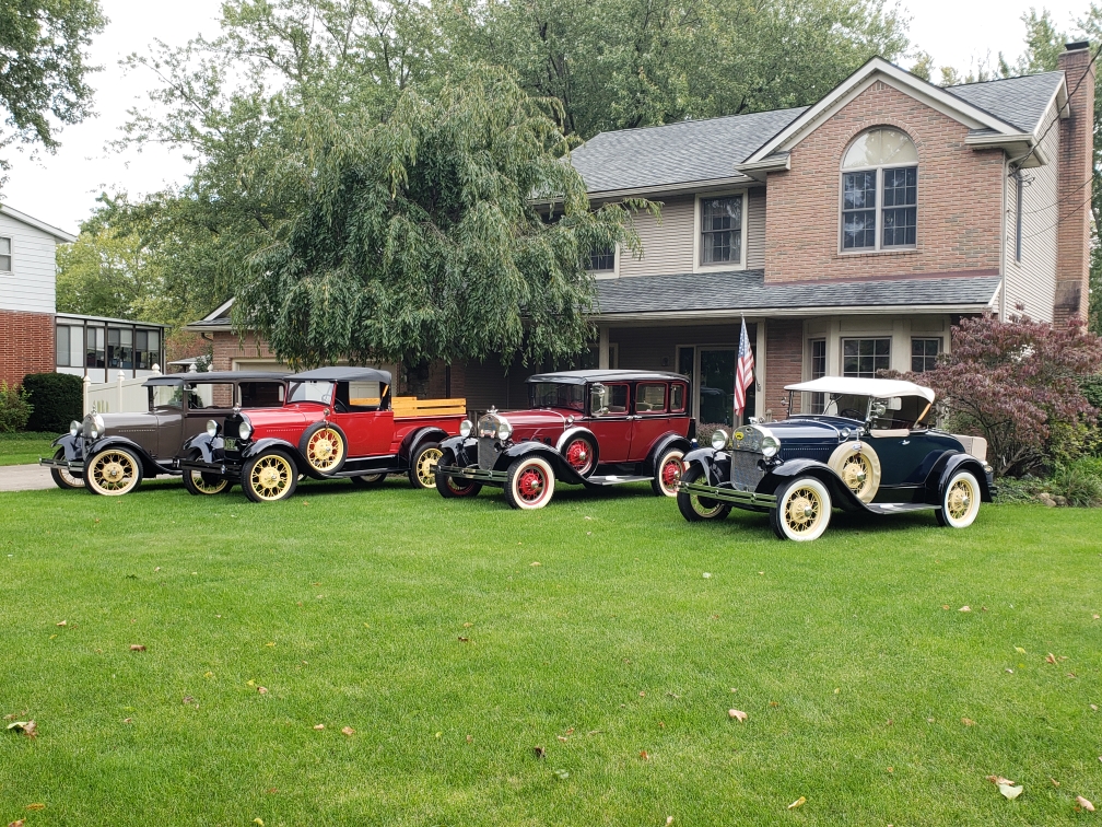

    Thanks. Here's his whole collection. He also has a beautiful 1917 T touring. Thier all to nice to cut up. Resized_20181022_172315003 (1).jpeg

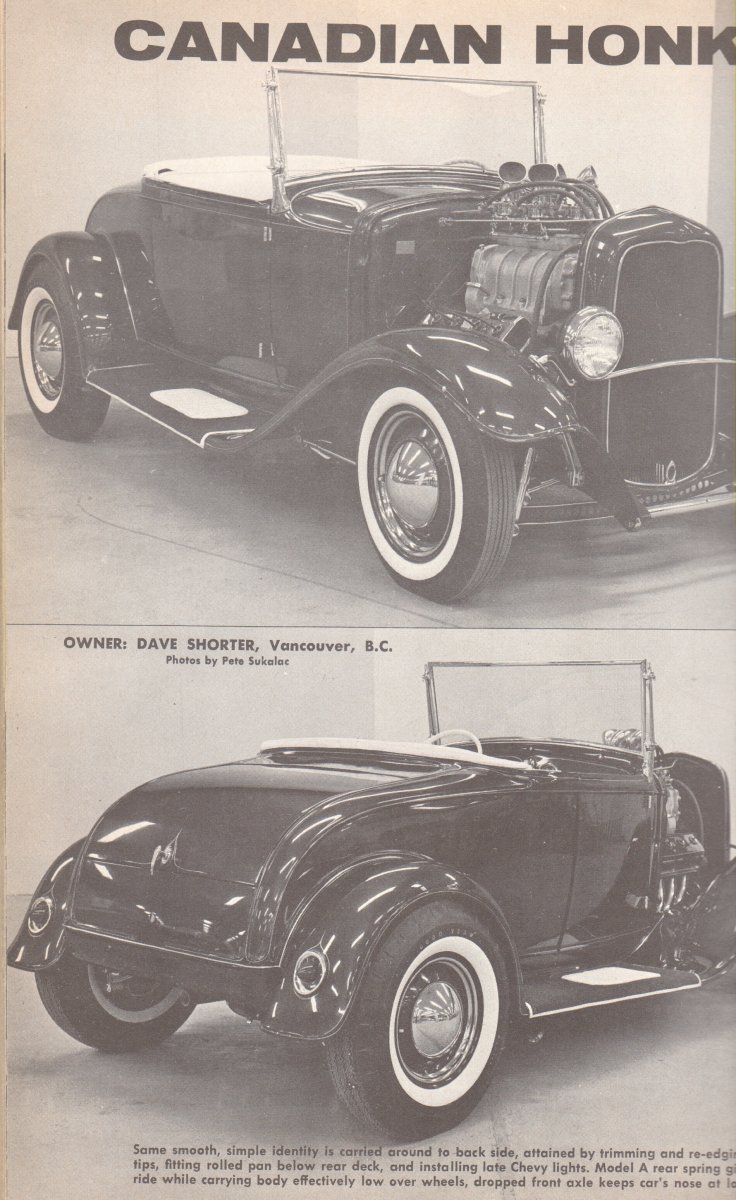

    So based on my observations your roadster has a Deluxe Windshield and this Shorter Roadster the Standard
    Perhaps your roadster body including the shield is in fact a Deluxe Roadster...I don't really know the differences
    One other detail I mentioned and you have mentioned it perhaps because I did was leaning the posts and I have since noted that the 28/29 A Roadsters had non adjustable posts at the lower end where the 30/31s did.

    That windshield looks like it has a curve in it ! I wonder what it's out of ?
  9. I think it's camera angle. The lower frame piece follows the arc of the Cowel top and notice there is no frame piece on the top edge. It looks like the top edge is cut to follow the lower edge and when in the partial open angle the complete gl*** takes on the bubble look.

    Makes sense to me. I couldn't figure it out.

    So that means Shorter is taller!

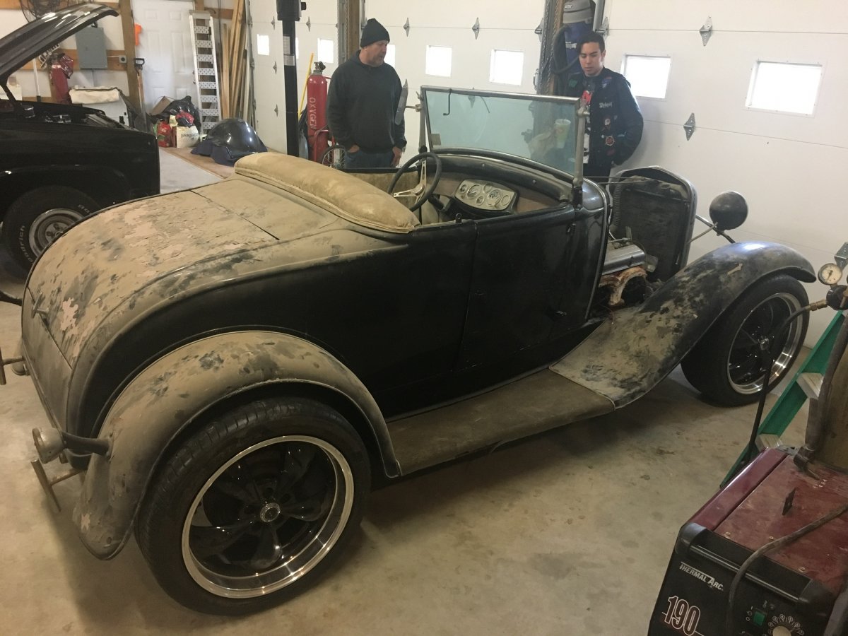

    Questions for you Hambers: looking at all the pictures of Model As and ‘32s over the past few weeks I’ve noticed the subtle differences to tell them apart, but there are still a couple of features I can’t discern. I’ve noticed the way the windshield frame attaches to the body is different: Model A has an additional triangular attachment piece where the ‘32 has a sleeker, rounded “foot” attachment point. Also, what I previously thought was part of the frame rails instead was a “splash guard “ along the lower body of the Model A, but on the Duece the tall frame rails are clearly visible and part of the exterior design. Slope of rear fenders are different. I don’t think the gas tank filler is on the front cowl of ‘32. So, questions: are there differences in the radiator shell? Headlight style? How about the rear dimensions from the trunk lid to bottom of body panel? Any other common visual cues? Thanks.

    There are no directly interchangeable body parts between '31 and '32. All the parts you mentioned are different between the two. Do a google image search for each year and we won't have to do it for you.

    The model A used separate aprons between the body and running boards, had the cowl mounted gas tank, and a grill shell where the radiator is directly exposed no grill. The 32 had the tank on the rear of the frame ( they cut that part off of yours) different windshield posts and one year only grill & shell along with headlights. The tail panel is longer on a model A.
