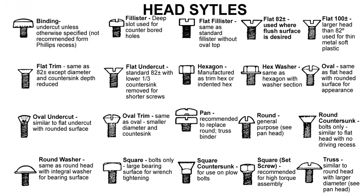

    Of course I meant “slotted”! I was just testing you to see if you would pick up on that!
