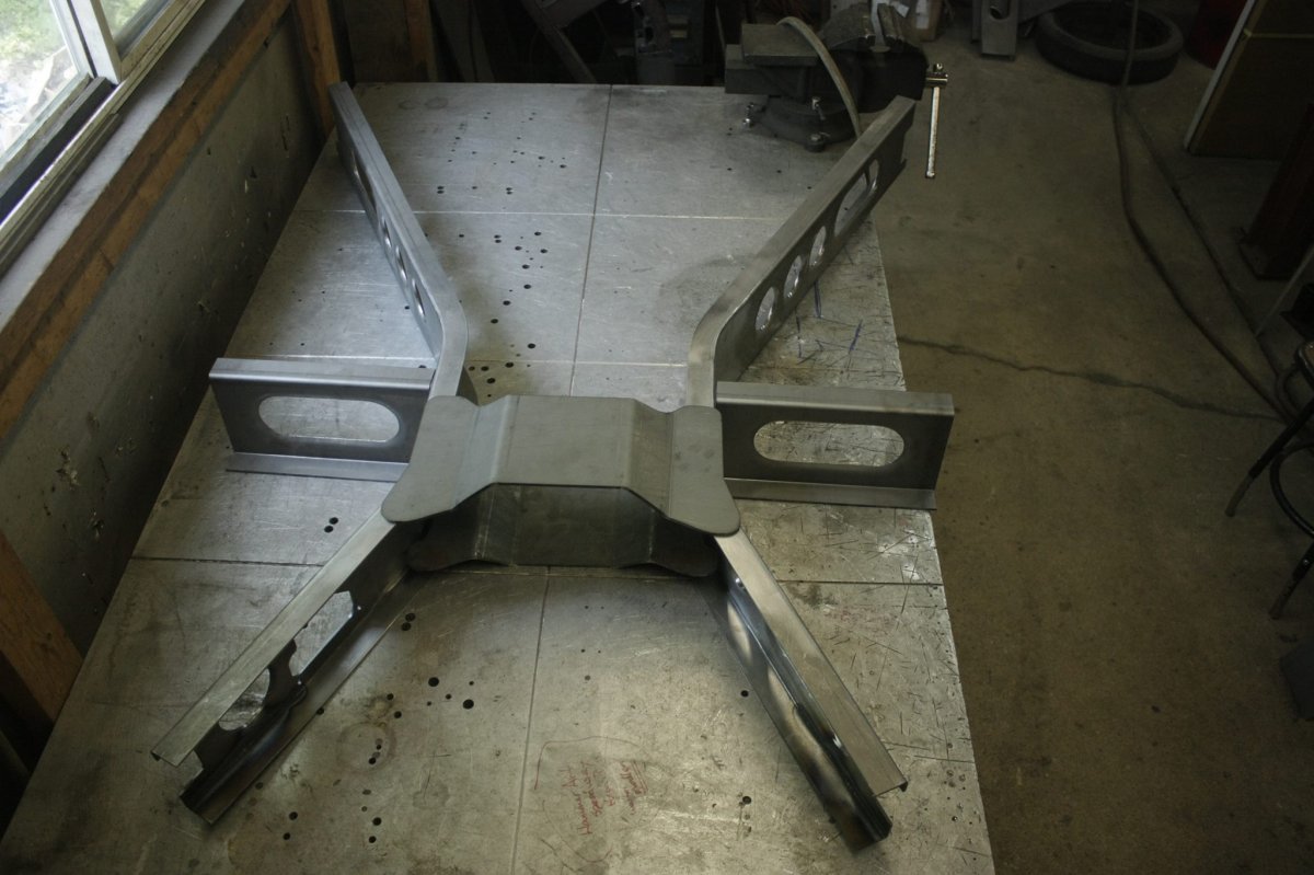

    This frame has been perhaps narrowed for its A Body and 32 fender Mods...so I know you have suggested to ditch the Pinch but couldn't the X Member in either case of these two vendors be just trimmed and fitted?

    I thought the frame measured out with stock bolt holes? , it would be pretty rare for an old hotrod to have a pinched frame

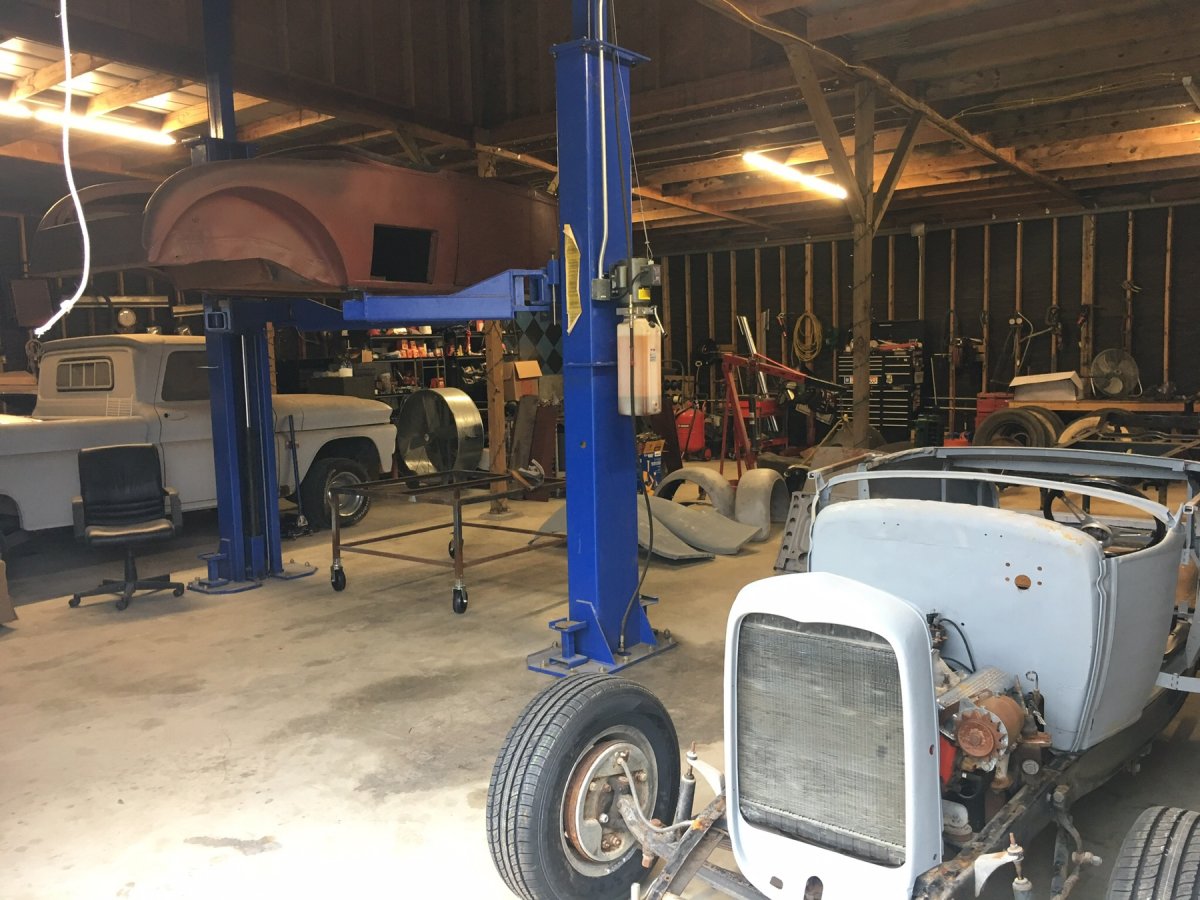

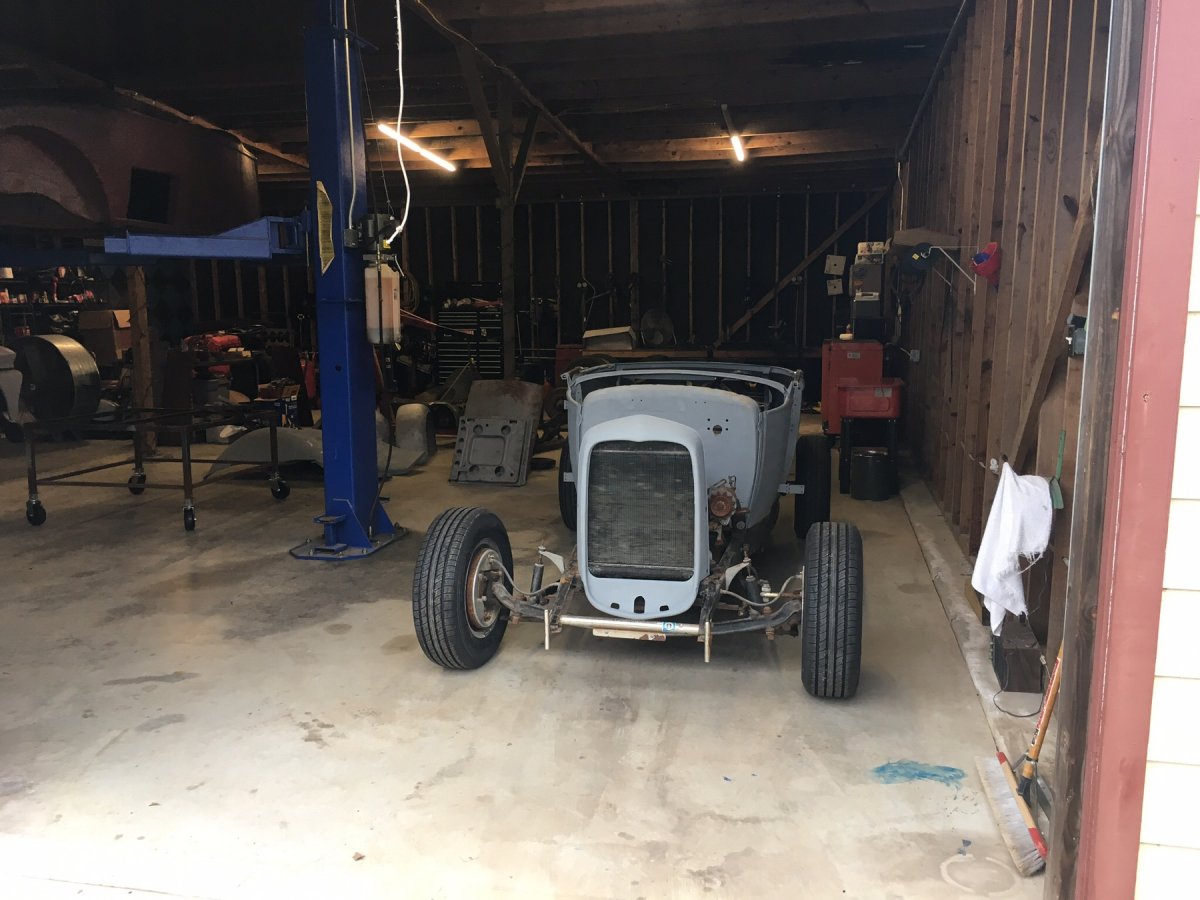

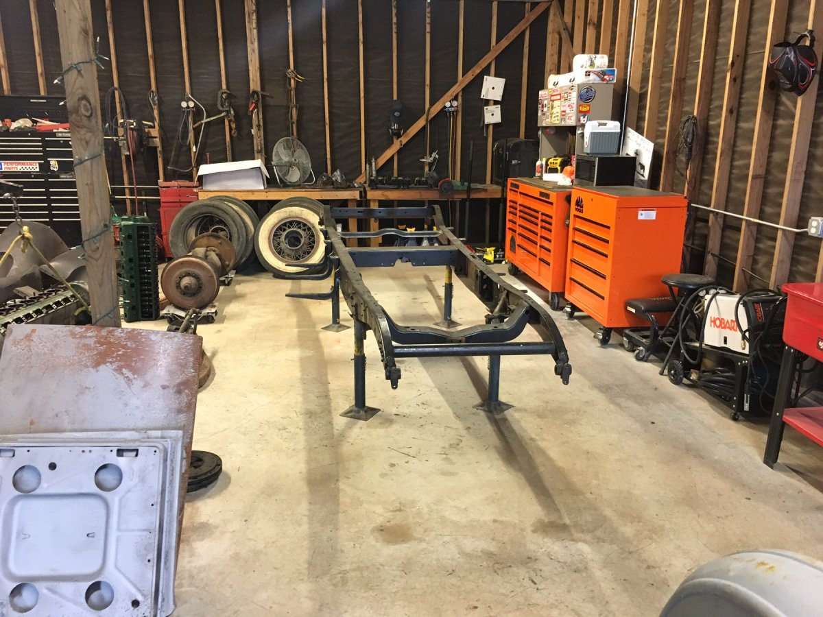

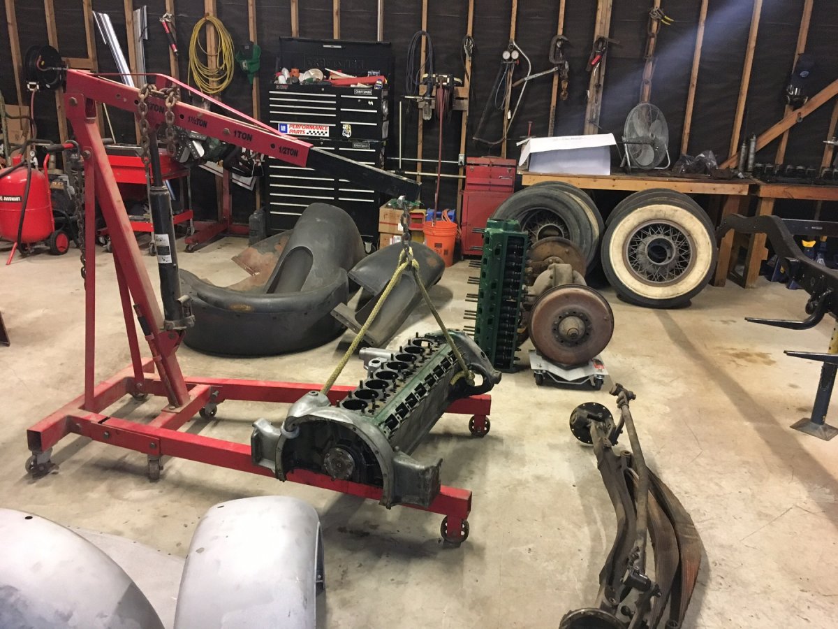

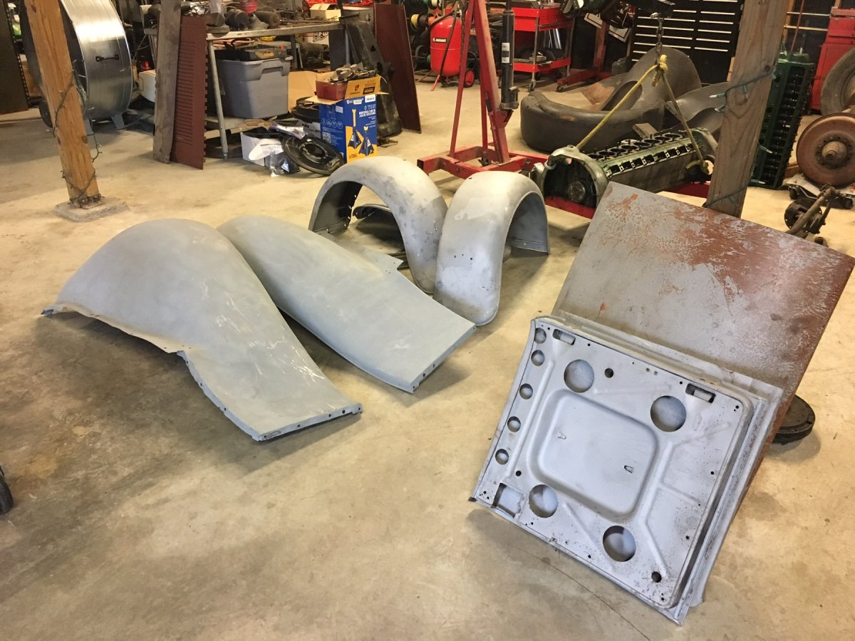

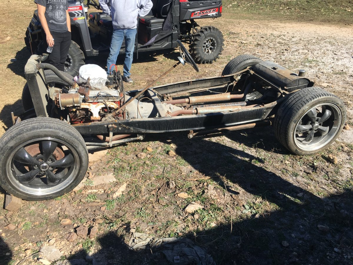

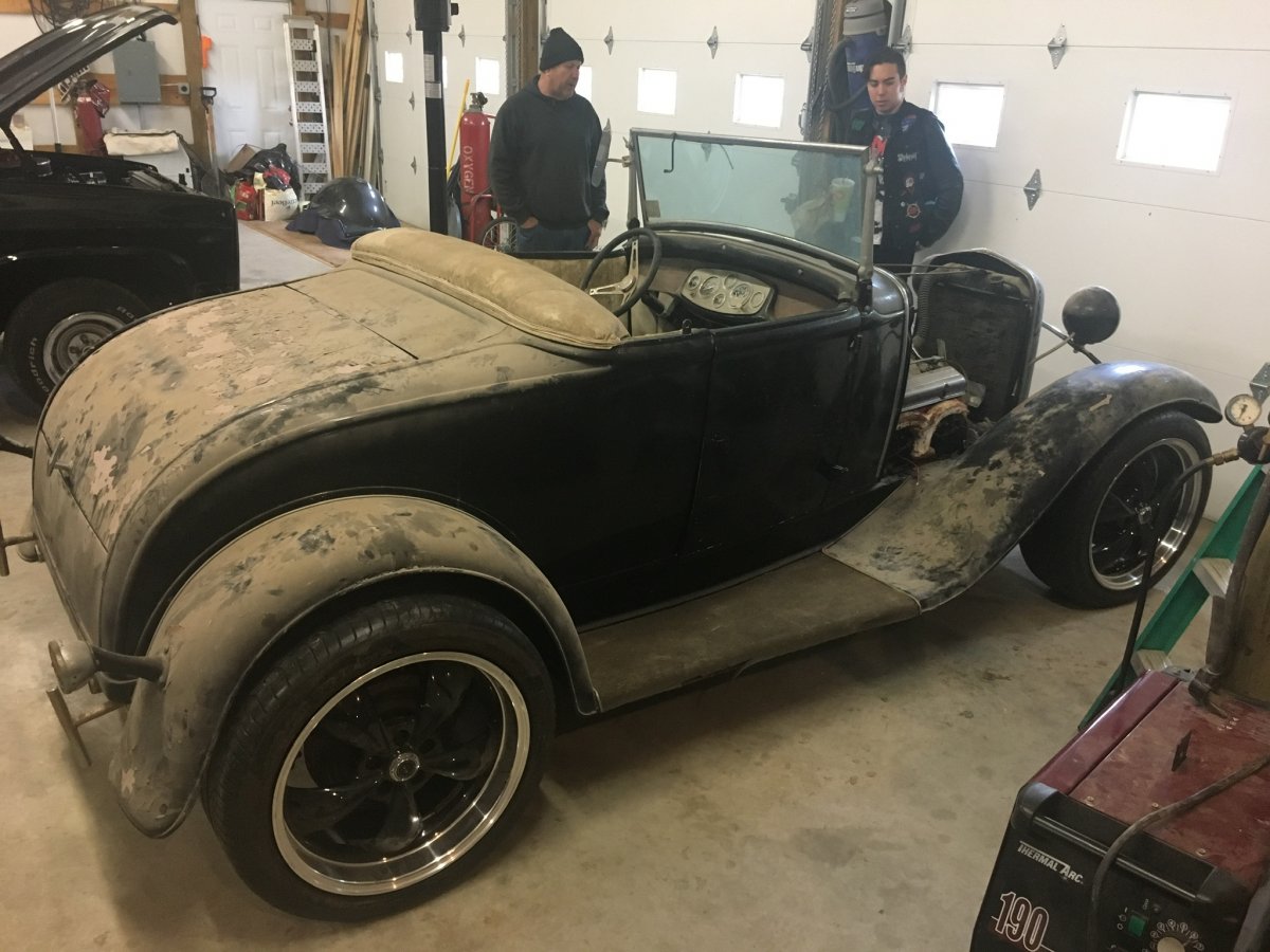

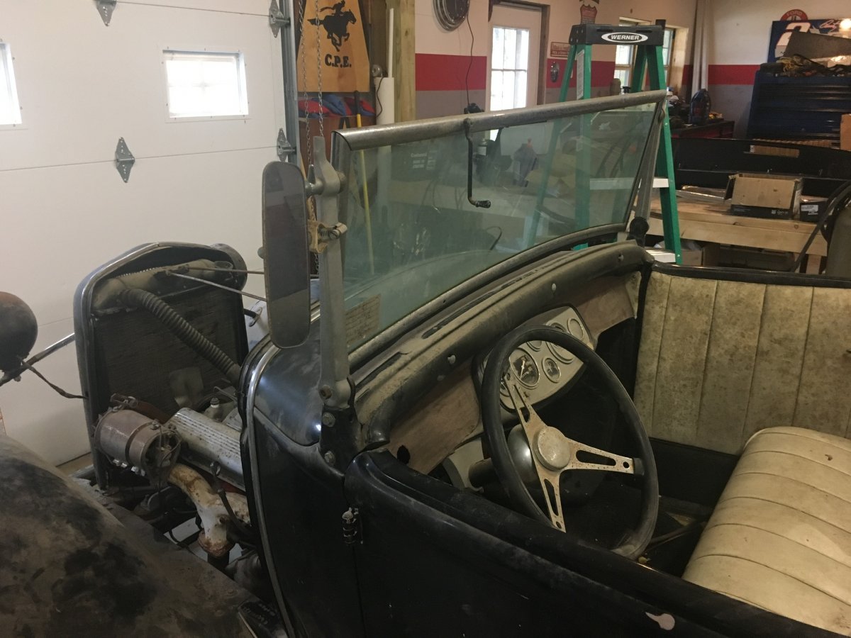

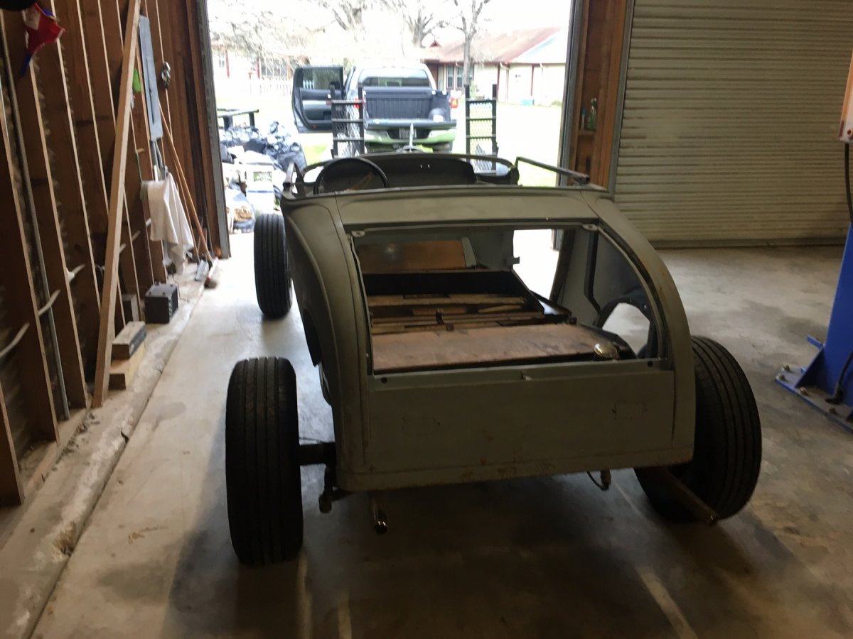

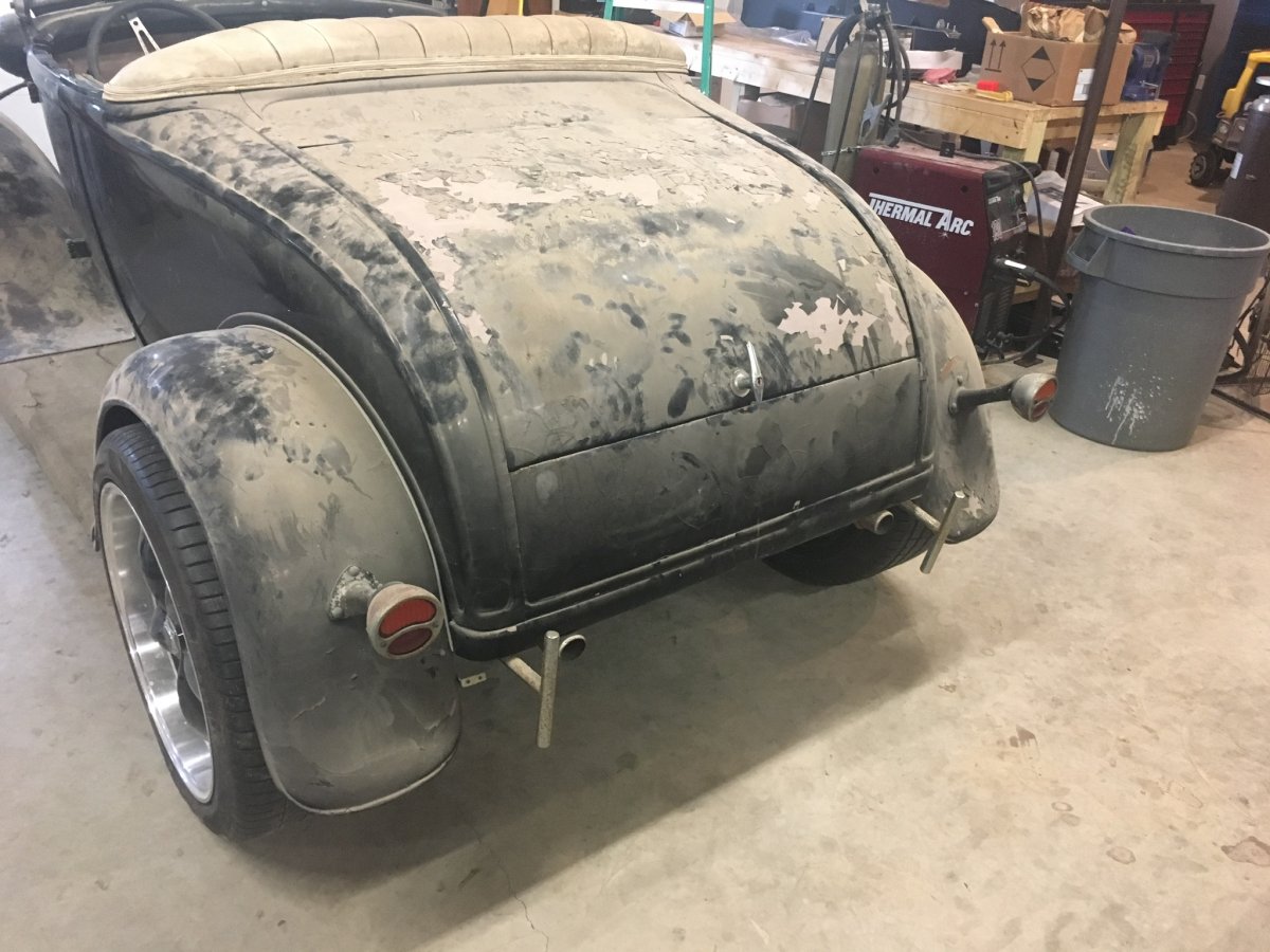

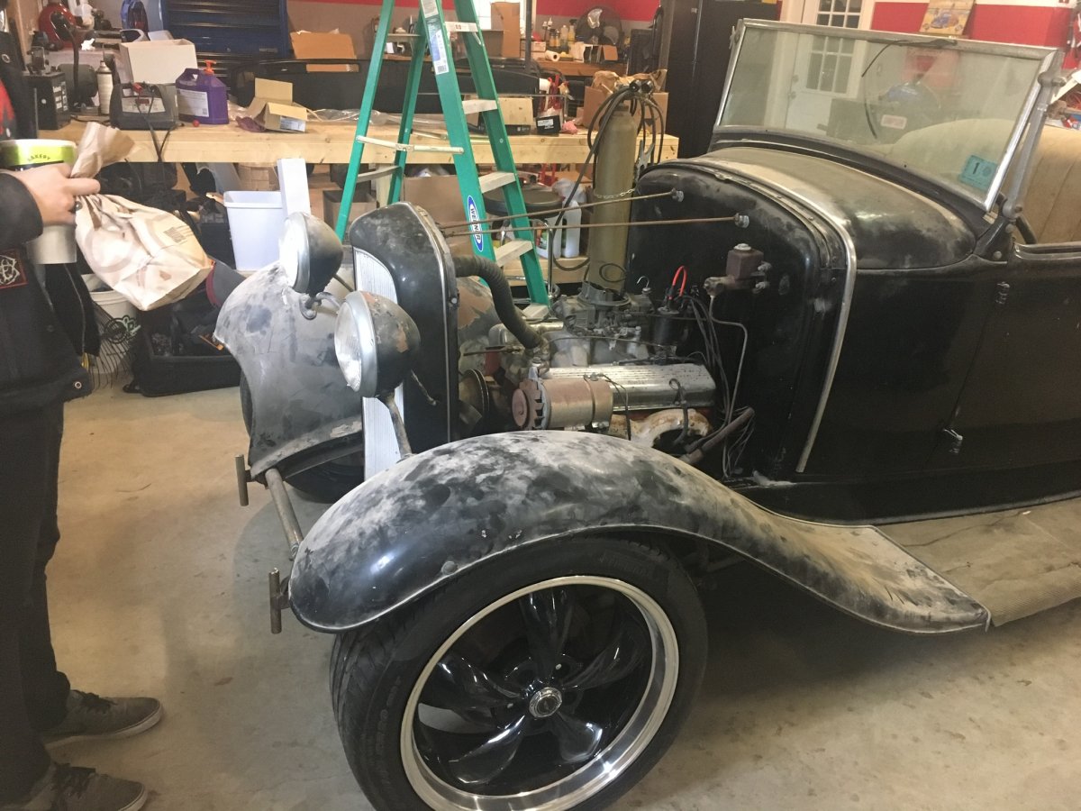

    Sorry for the delay in posting. I think we’re in business. A local builder I’ve been talking to just took the car to his shop. He ‘gets’ the plan to keep the car as original as possible and just clean it up and do some mild upgrades. He’s affordable. And he’s ok with me helping occasionally and willing to teach me basic welding. He’s done hot rods and concourse-levels builds. He’s working on one other car (1931 Packard Roadster) so he’s not buried in work. We’ll see how it goes - I’ll post updates. Thanks everyone for all the great advice and suggestions. If all goes according to plan, I hope to be driving by Fall.
    IMG_2553.JPG IMG_2554.JPG IMG_2558.JPG IMG_2560.JPG IMG_2557.JPG IMG_2559.JPG

    Yes sir-plan to change out the auto TH350 with a Muncie 3 speed. Still deciding best way to arrange pedals. Swing from top or bolt to x-member (need to find one).

    Sound like your moving in the right direction. Wish my shop was that spacious and organized. If I had more space, I would have more clutter.

    By the way-he shares the shop with another guy, so that’s not the truck he’s working on - just the Packard. You can see the body on the lift and the ch***is, fenders and straight 8 engine. That thing is a beast.
