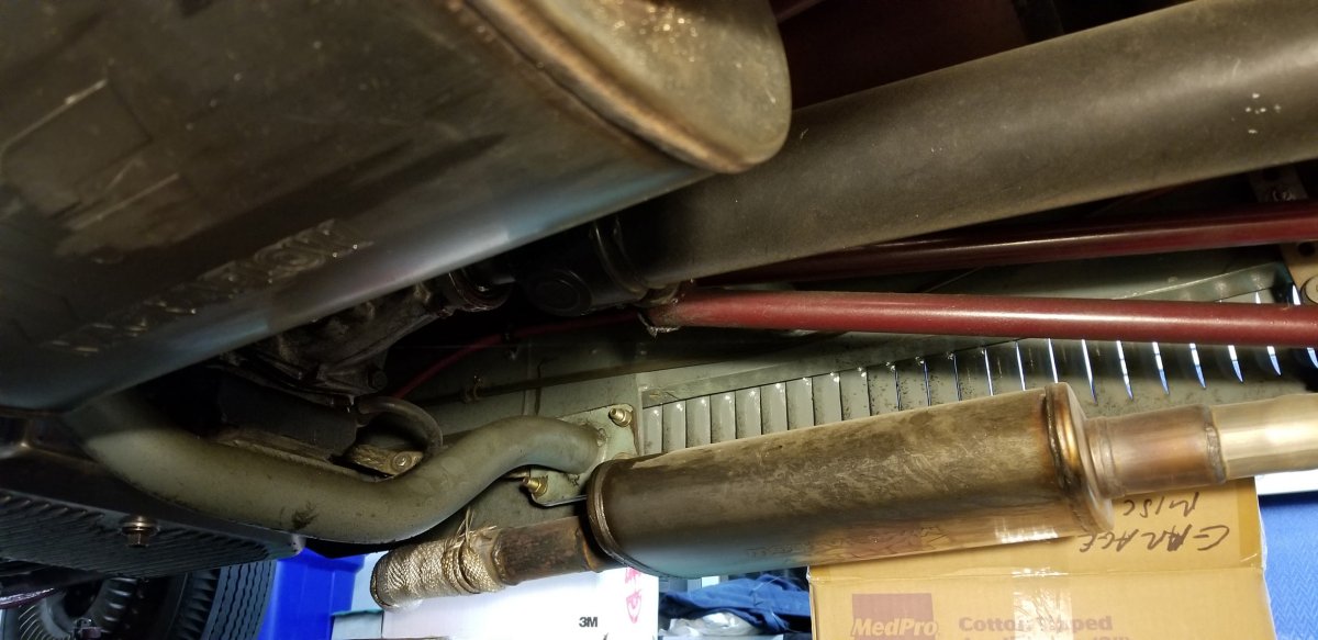

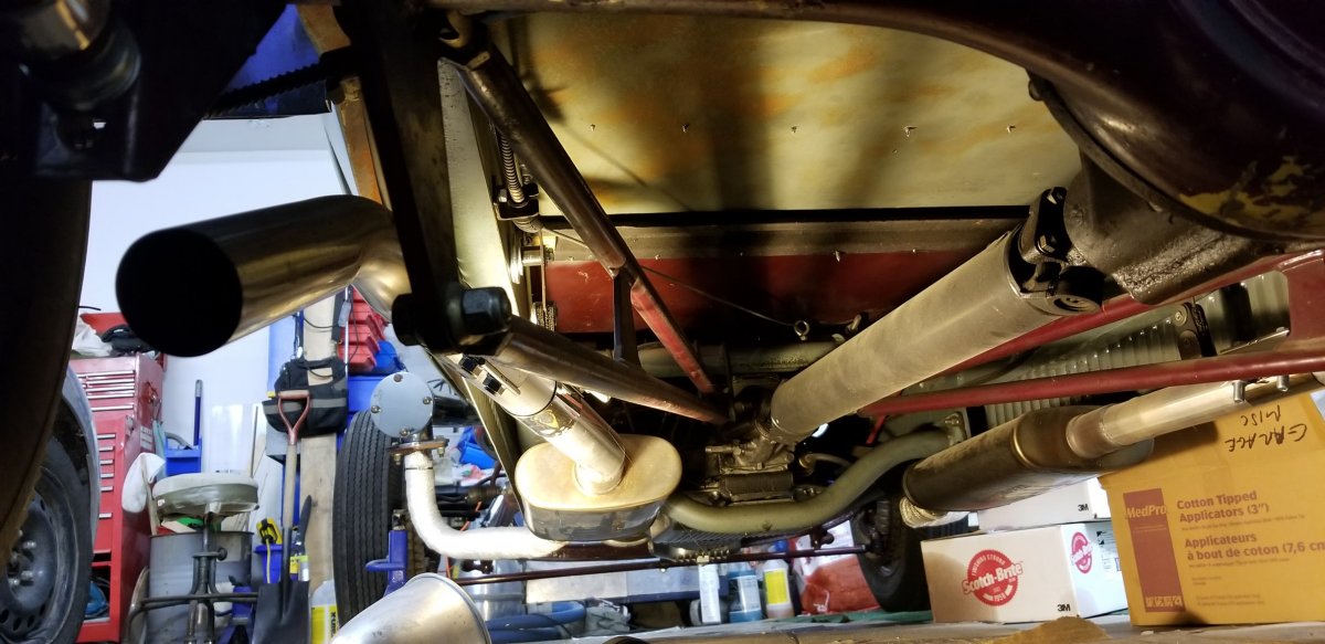

    I snapped pics of whats under my car which is running modern stuff...Ladder bars attached to 57 Chev rear using Ladder attach kit and tube shock mounts on rear end, Fwd ladders attach to a tube with ladder bracketry welded or attached to boxed inner frame with tube trans crossmember bolted to drop plate from boxed frame...
    I would go ladder as the potential braking rear bone situations worries me and its sixties and ladders were around traditional or inspired and I would mount them as required with suggested geometry built in. Remember get it done and you can drive it for a year or two and change if you desire...If it was me that front axle might have to go...due to that welded mount for the perch i think it was...

    I'll just say ditto to everything Stogy said. Here is a picture of the 32 frame under my 27. This probably isn't ideal but it seems to be working ok. Not shown are what I call torque arms that run from the top of the rear end to the same frame points as the radius arms. Kind of like a triangulated four bar. It looks odd because the arms are ??40s switched side to side and upside down. The frame is fully boxed and has what is left of the original 32 K member. Also not in the picture is a very stout bolt in trans mount. I'm just showing this to point out there's all kind of ways to do things this is what I am trying. DSCN1112.JPG
