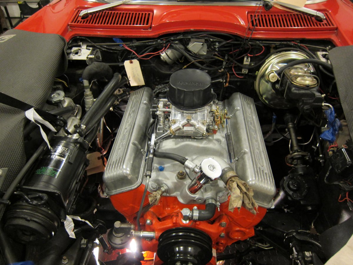

    Corvette only, if I remember right. Still can use ventless valve covers, and pcv to carb base. Breather at road draft tube. Engine front.JPG

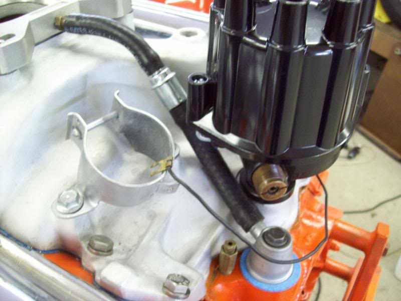

    Or road draft tube/pcv to carb, and vent your oil fill tube. 100_3534.jpg

    IF you were to use the pcv fitting in the oil fill tube on the intake, and use the road draft port as fresh air into the engine, for sure don't just use the road draft tube. You will pull all kinds of dirt and **** from the roadways into your engine. Then, go down a gravel, dusty road would be bad news. If you already have a breather on your oil fill, just do like the 2nd pic and route road draft to carb base. Those parts are easy to find.
