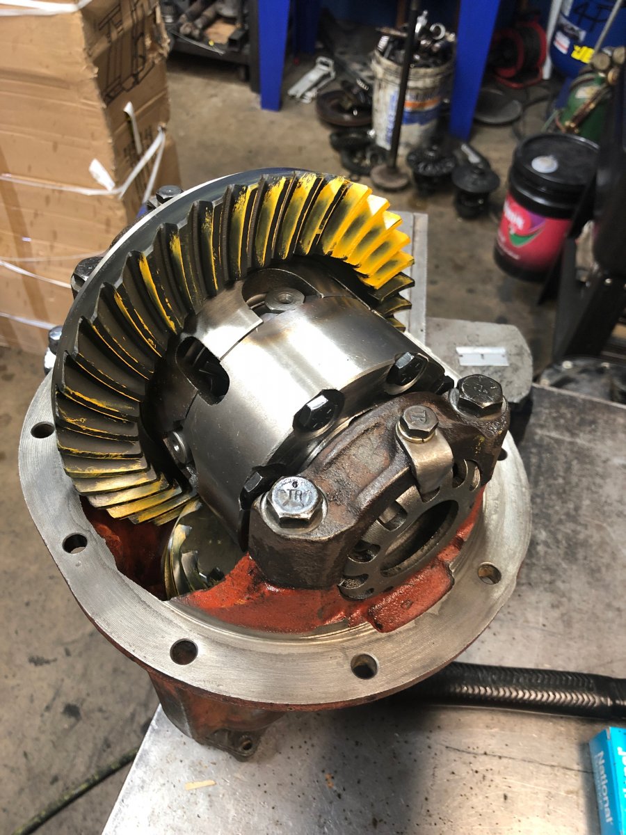

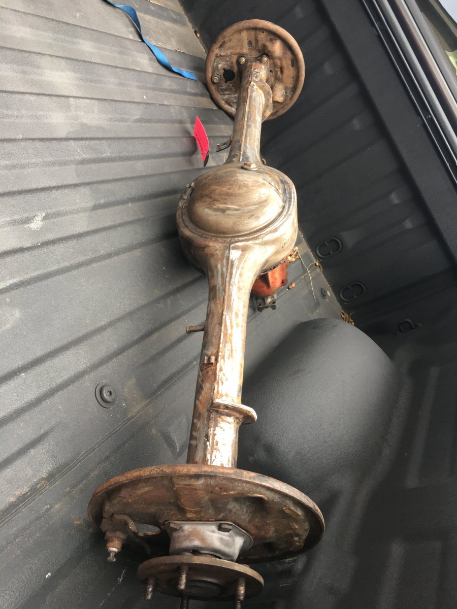

  7. Torkwrench
    Joined: Jan 28, 2005
    Posts: 2,752
    Torkwrench
    Since you're adding a Posi to your 55 - 56 axel, the axel shafts will need to be slightly shortened. This is required on 55 and 56 Chevy axel shafts. Since Posi-Traction rear differentials came out in 1957, the 57 - 64 axels do not need to be shortened.
    The attached photo is from a Chevrolet Technical Service Bulletin, that was sent out to Chevy dealers in 1957.

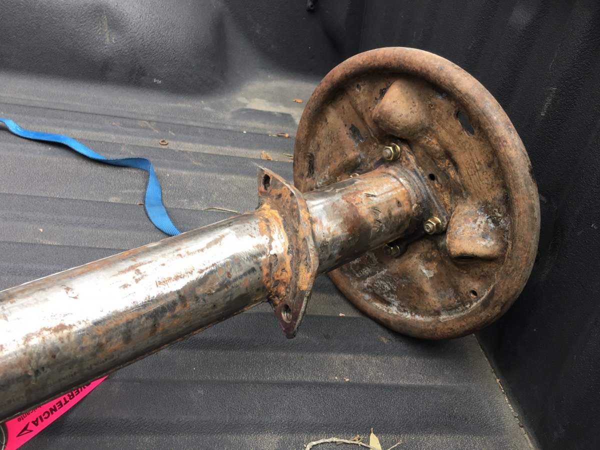

  9. Torkwrench
    Posts: 2,752
    Torkwrench
    From the photos, it looks like it's a 55 or 56 axle. The axle retainers are 55 - 56. The 57 - 64 retainers are much shallower than the 55 - 56 retainers. For reference, here's a link to an Ebay ad that shows repro 57 - 64 retainers.
    https://www.ebay.com/itm/57-Chevy-R...621?_trksid=p2349526.m4383.l4275.c10#viTabs_0
    Also, it looks like your axle does not have a drain plug. 55 - 56 axles did not have drain plugs, while 57 - 64 axles, did have drain plugs. Again, for reference, here's a link for some 55 - 56 axle retainers. As mentioned, they are much deeper than the 57 - 64 retainers.
    https://www.ebay.com/itm/Chevy-1955...123648313747?_trksid=p2385738.m4383.l4275.c10
    The center section could be any year from 1955 to 1964. They will all interchange between all of the years. However, the pinion yoke looks to be 55 - 57. The 58 - 64 pinion yokes were heavier and stronger. Here's a link to the stronger style. Not sure why it's listed as for a 57, though. Perhaps, the 57 Vettes used the stronger yokes, while the 57 p***enger cars used the lighter design????
    https://www.ebay.com/itm/Corvette-O...ft-Pinion-Yoke-Flange-1957-1964-/201366216384
    That's a NICE looking Posi unit. Looks to be a new one. If so, what brand?

  11. RiffRaffRoadster
    Joined: Dec 24, 2018
    Posts: 450
    RiffRaffRoadster
    Tork - I'll talk to Will, the builder about this. I know the engine and transmission were from a 1957 Chevy (serial number matched), so I ***umed the rear axle was from the same 'donor' car.

  12. big duece
    Joined: Jul 28, 2008
    Posts: 7,047
    big duece
    from kansas
    There is a casting date on your drop out unit...
    Sent from my SM-G900P using The H.A.M.B. mobile app

  13. big duece
    Posts: 7,047
    big duece
    from kansas
    I wished I knew you need a locker, i am rebuilding a 3:55 unit now to resell.

  23. big duece
    Posts: 7,047
    big duece
    from kansas
    There were two carriers in the 57-64 55p drop outs. 57-59 were bolted together with co**** thread RH threads, the 60-64 units were fine thread and LH threads. Also the "V" that the blocks lock into are different. The pic on the left is 57-59, on the right is 60-64. If the carrier has stayed with the pumpkin casting, you can just look at casting date.
    GM Posi V Angle 60-64 Left 4-Series - 57-59 Right 3-Series_zpstmba1dre (1).jpg img_3525_e7433777b0437c9710d07459edb46550ad765fdc.jpg
    For example, the cast date for this is L276; 12-27-56 If there is a "P" its was a posi, '57 posi had just an X in the casting. 58-64 had "P". The thin P was car only, and the thick "P" was used in Corvette and p*** car.
