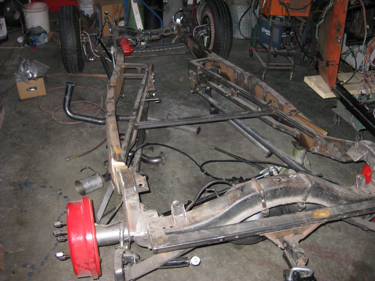

    There is more than one way to mount them, but look for another pair if your guy don't want to mess with heating/cutting/welding.https://www.hotrodworks.com/product/1935-1940-ford-radius-rod-mount-kit/ Which ever way you go, it would be wise to strengthen the top side of the wishbone like in previous pics. Keep in mind '36 was closed drive line and looow horsepower engine. The closed driveshaft added lots of strength that you no longer have with open driveshaft.

    I'm using a Johnny Joint from Currie for the front pivot in the rear of my roadster. I am using an open drive 47 truck rear (hope to use a quick change in the future), an open drive 3-sp, 35/36 radius rods, added 1" DOM tube torque arms, homemade brackets, Johnny Joint, and model A or T rear spring. The rear crossmember is Model A on my homemade frame (Dadgum frame). I'm using a coupling nut which will be welded on both sides of my center crossmember with the jamb nut. I still need to complete all the welding but here are some pictures so far. Bob

    This is what I was thinking too. It's hard to tell from the pictures but it might be possible to fix yours like you said but you would have to find a good welder or fabricator to make sure.

    Here's my setup with the '36 bones. They anchor to plates welded to my fabricated center crossmember which is similar to yours with bolt on radius rod brackets from Speedway. In my case, I didn't have to change the angle of the radius rods because I got them from a car that was flipped upside down where someone torched off the spring hanger ends to get the rear spring so I had to make all IMG_1203.JPG that up from scratch. I referred you to the video because he pie cut the tubes to change the angle.

    It's obvious Henry mounted the bones around the tail shaft area at a central point perhaps with a Ball in Socket similar to the front...in a triangulated way. What I have seen through so many setups here is regardless of location to center when attaching even if they don't meet behind the tail shaft if you extend an imaginary line they are triangulated even if joined at two locations the point of meeting is just further ahead. So the design is still there just modified...how does it perform stress and performance wise...I mean it's easy to see how a typical garage hotrodder might just look at the old indy and Jalopy racers and copy it.

    The Chev pickups with coil springs from 1960 to 1972 have the control arms going toward the center as do the NASCAR racers.

    That is in fact what I am asking is the 36 bones were designed attached just behind the ****** on the torque tube and stress on those type of Bones seems to be an issue the further out from center you go so would a centralized Heim type attach point joining the 2 into 1 reduce stress to a factory designed level. The other thing already mentioned in this type of setup is addition of a Torque Bar mentioned and shown in this thread due to different stresses created by the loss of the torque tube and other geometry not present in a torque tube setup?
    https://www.jalopyjournal.com/forum/threads/36-bones-open-banjo-torque-arm-my-way.263584/
    Just to be clear there are many of you fellas with all kinds of geometry in action here and whether its dead center to one mount or triangulated to two both may yield positive results. My Ladders go to two separate mount points much like yours @goldmountain.

    Just had a crazy idea. How would it angle in if you try swapping left for right?

    Honestly I thought of it to myself earlier tonight ...glad to see it in print...Holy geometry Batman...:D

    I just drew that up in my head and I don’t think that would work. I’ll draw it on paper and verify...
