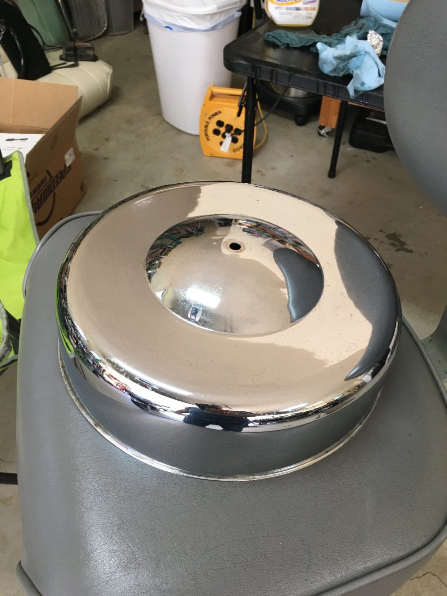

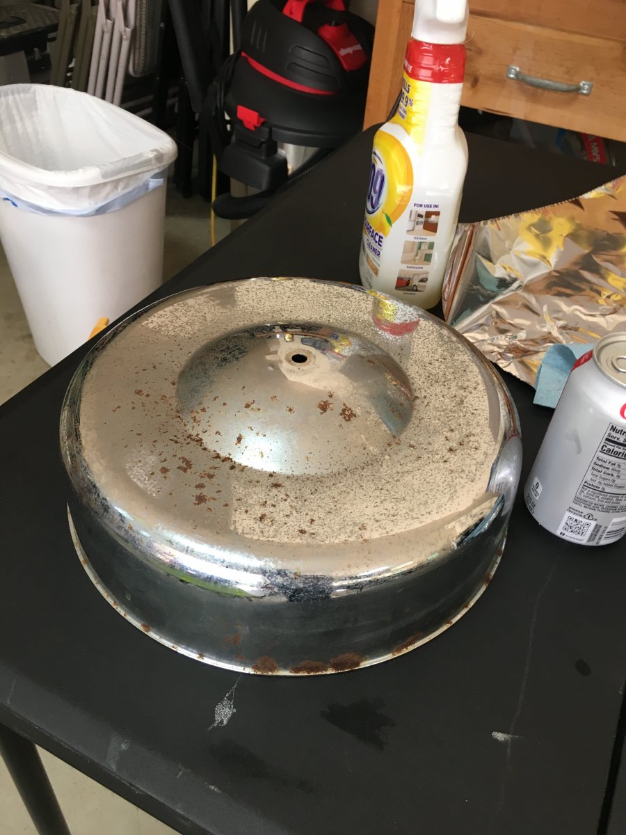

    04E97327-A2B7-4630-A377-6688189BB7A5.jpeg 625E00D6-F74D-48EF-B4C8-1815F3671960.jpeg Side project #75- restore original air cleaner cover...
    Aluminum foil and Diet Coke baby
    catdad49, dan31, 35cab and 15 others like this.

    loudbang and RiffRaffRoadster like this.
  17. brad2v
    Joined: Jun 29, 2009
    Posts: 1,659
    brad2v
    Wow, that came out very well

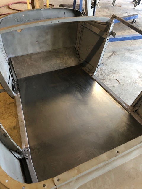

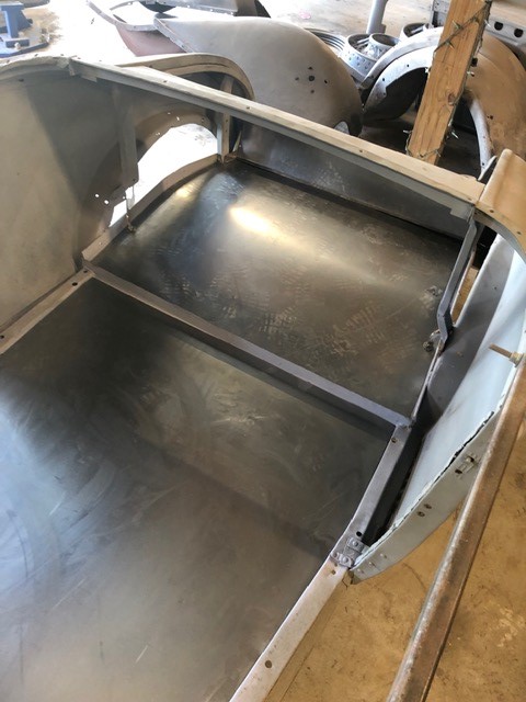

    floor being mocked up for welding...
    catdad49, Tim, Stogy and 4 others like this.
  26. Stogy
    Joined: Feb 10, 2007
    Posts: 27,207
    Stogy
    Good stuff Riff. Are you adding some beading to that...why would one add such? To strengthen and I suppose aid in pop/oil canning...huge undertaking this all is...but your gettin' it done...

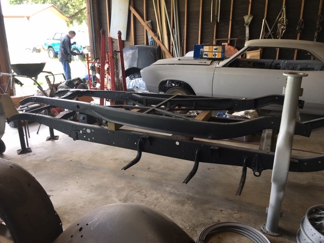

  29. RiffRaffRoadster
    Joined: Dec 24, 2018
    Posts: 450
    RiffRaffRoadster
    Recent pics. Frame and suspension done and painted. Motor and ****** fit. Brake lines in progress...body work is is almost finished so painting will begin on that next week. [​IMG][​IMG]

    alchemy
    Why the Heim joints on the drag link? If you end up having looseness in the steering, check those first.
