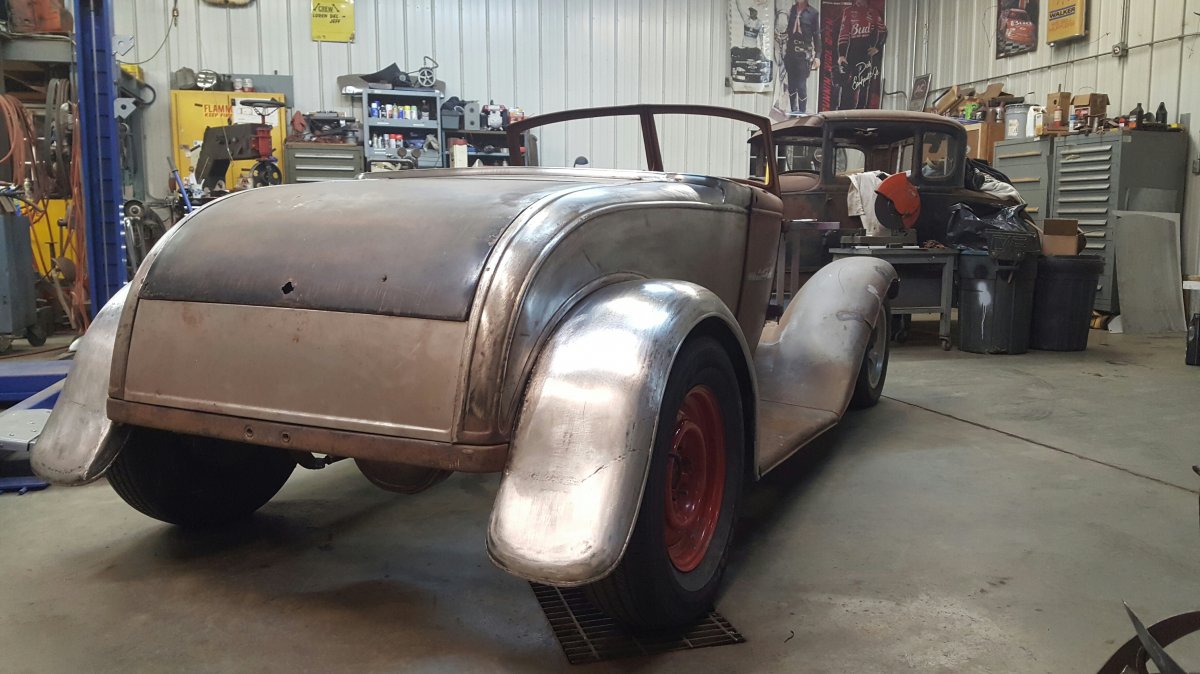

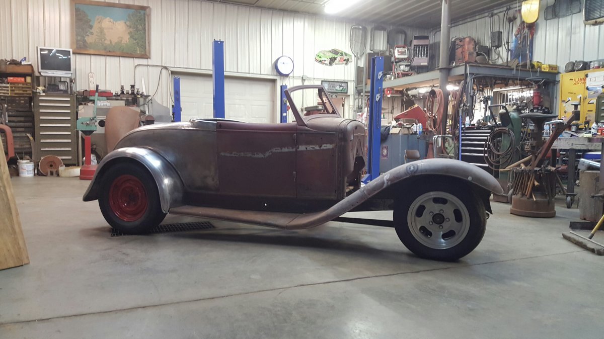

    No plans to ditch the fenders.

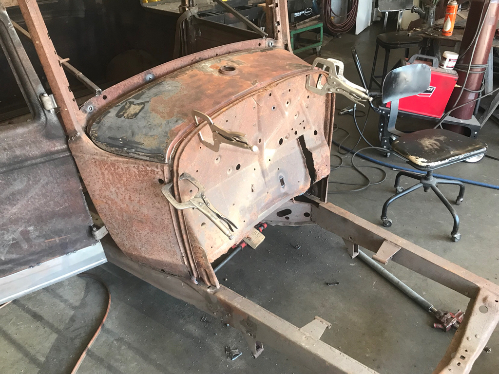

    I don't know why everybody keeps insisting on pinching '32 rails for a Model A. It was rarely done in the old days, they just used a wood filler to fit the flat A floor to the curved '32 frame. Pinching the rails is actually a Street Rod modification to make everything smoother. There is a thread here about a Hamber saving a '30 Vicky body and fitting a '32 firewall. I didn't think it would fit, but guess what..... it does.

    I have a 27 roadster on a 32 frame that was originally built in the early 50's. The frame wasn't pinched, the firewall was split and the cowl jacked out to fit the frame. You can see the notch at the bottom. I left it there.

    Jimgoetz-are both methods acceptable? Are there pros/cons to pinching frame vs. expanding firewall and cowl?
