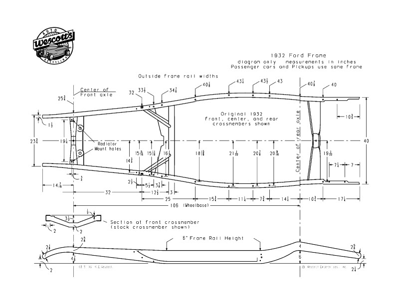

  6. big duece
    Joined: Jul 28, 2008
    Posts: 7,049
    big duece
    from kansas
    Tape measure at the cowl mounting would tell that... 32-Ford-frame-dimensions.jpg
    RiffRaffRoadster and Stogy like this.

    As the car is now apart, I'll await Keith's observation when he sees it, and anxiously.
    Very relieved that you are being this particular, with your new info.
    Your Dad would be impressed.
    @BigDeuce, great idea. (I have a LARGE print of the Deuce frame Squeak Bell gave me a few years back, "Why-didn't-I-think-of-that?" LOL
    Thanks for posting!
    loudbang, RiffRaffRoadster and Stogy like this.
