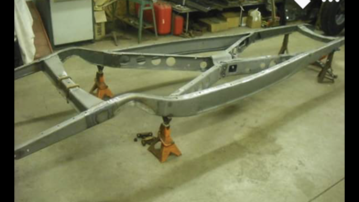

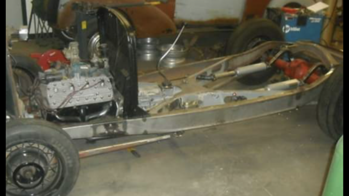

    1B6FA747-BB92-4FA3-A5C0-448FCC99ACF4.png 0DD79985-1F3F-43FD-8C95-2DF8CE00CCE0.png Everyone is going to have an idea of what you should do with your car but loosely reading between the lines of things you wanted and the concerns you have for the way it drove ..
    It would have been neat all just to polish it up and do required maintenance , but since it is already ripped apart I would probably balance between restoration and changing a few things but keeping the over all vibe of the car your dad bought but making it more drivable and fairly bullet proof
    I would box the front and back put an x member in it, c-notches, rebuild the f-100 steering drop axle split bones, 40 spring 9” ladder bars and a 4spd , f-1 brakes or Lincoln, keep the 283 or maybe opt for a 327 with 2x4s , Vette valve covers, chrome reverse wheels and another set of Astro slots with some redline tires maybe

    Very reasonable suggestions
