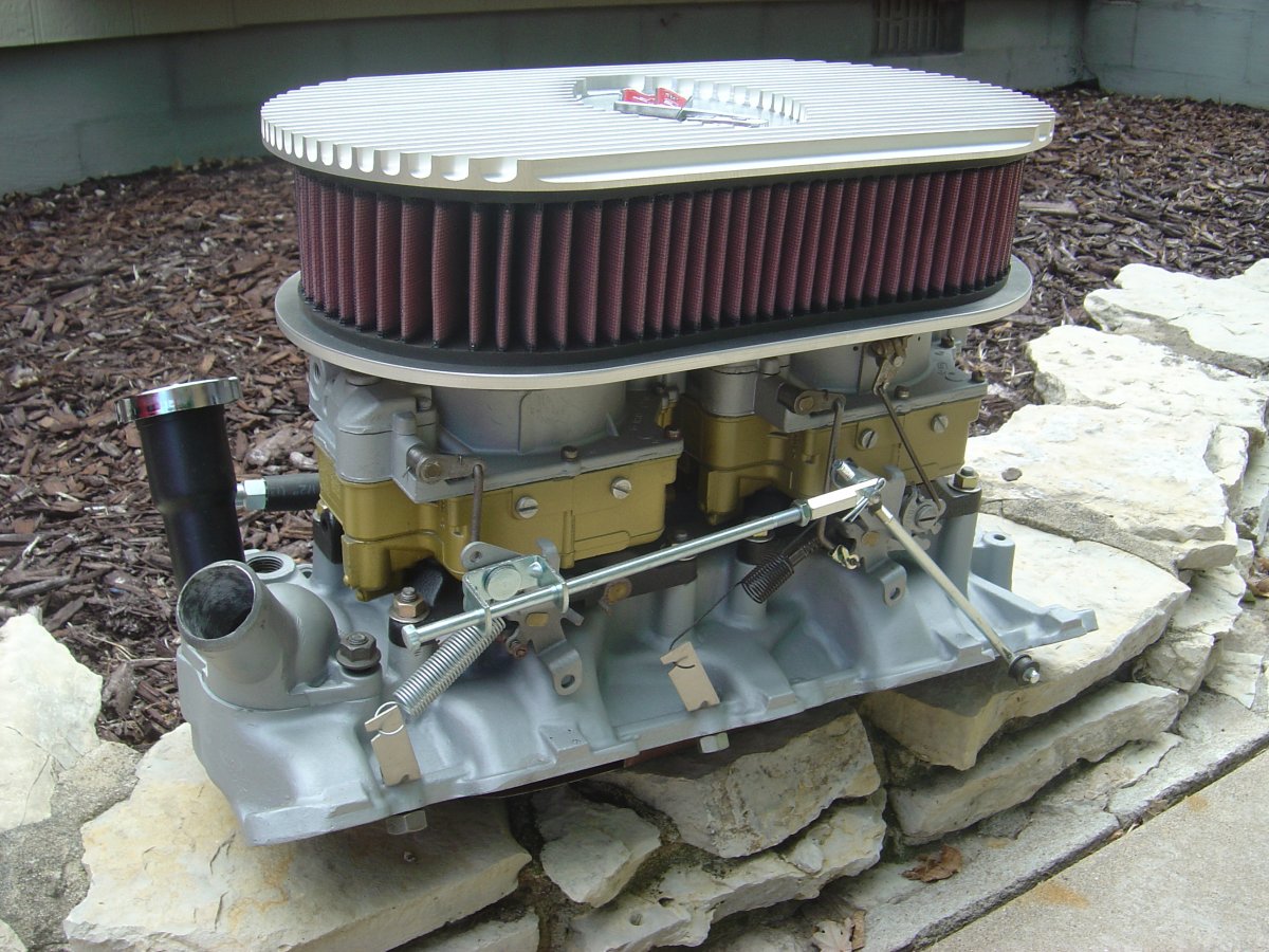

    Vette 2x4 clone setup would be way cooler than a tunnel ram, run better too.
  6. pitman
    Joined: May 14, 2006
    Posts: 5,148
    pitman
    A pair of WCFB's, borrowed from an old Caddy? :)
  7. big duece
    Joined: Jul 28, 2008
    Posts: 7,047
    big duece
    from kansas
    They have the small alum base like the Fords did. Two 1x4 carbs for '57 chevy work the best for clones. The bolt right up to the vette intake, and will flow more air than the original 2x4 carbs suited for the 283s. My clones that I wish I never sold. DSC08323.JPG
  8. RiffRaffRoadster
    Joined: Dec 24, 2018
    Posts: 450
    RiffRaffRoadster
    Any pics of this set up?

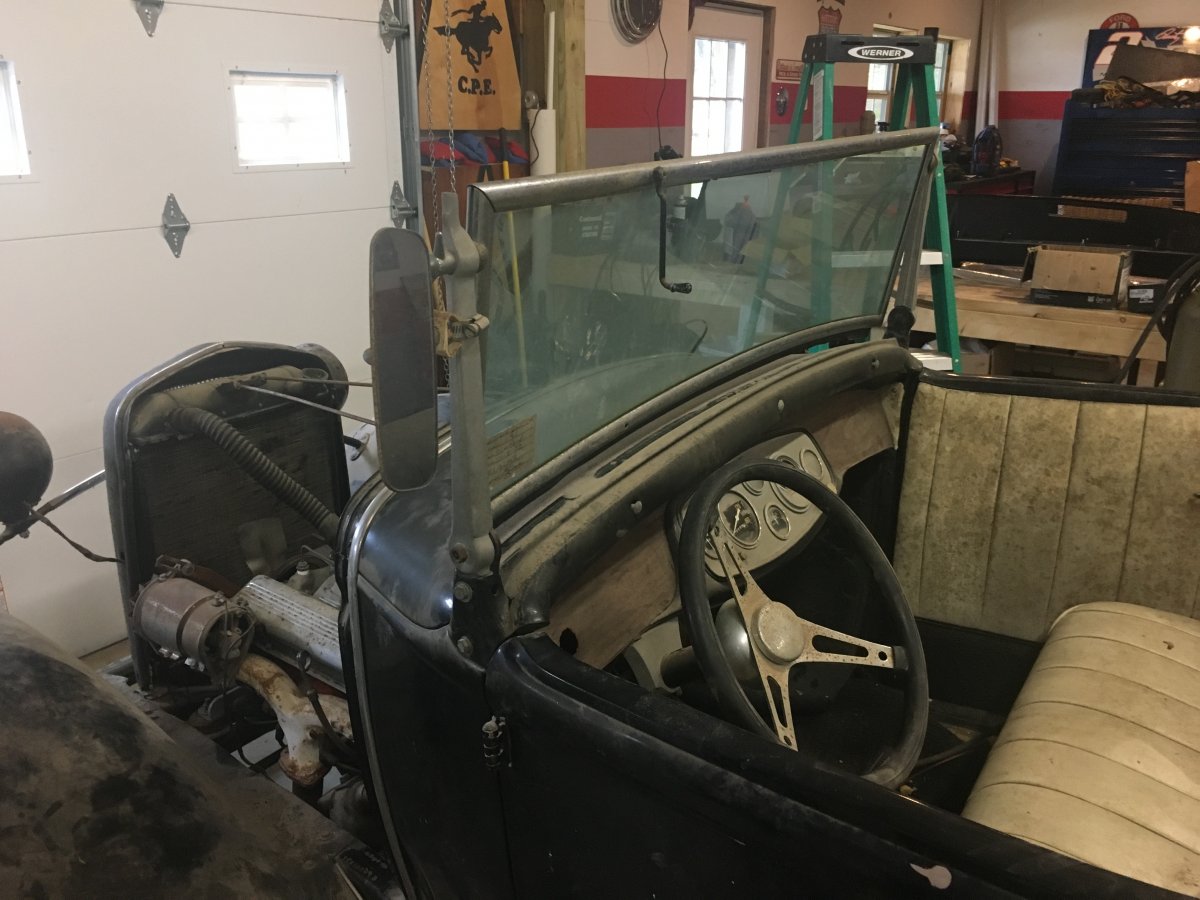

    One might dis***emble the gauge panel, and see if there are any dates on the back of the gauges. May not be accurate to the year the car was built, but might put it within a couple yrs. If you get discouraged with putting the panel back together, I could take it off your hands... :p
  19. big duece
    Posts: 7,047
    big duece
    from kansas
    Large logo SW gauges were used in 55-'57, Sun tach late 50s to mid 60s.

    big deuce - I'll try doing that this weekend thanks. And no - I'm not parting with that dash. Its probably woth a pretty penny. I just saw the same Cragar steering wheel that we have on the Roadster for sale on E-Bay for $1,500.
