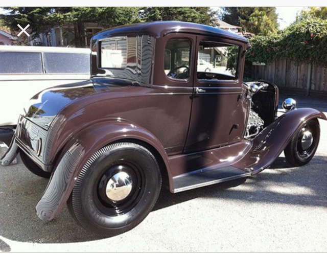

  19. Don’t know who built this one. I’m sure someone here does.
    I love chopped, fenderless hot rods but this one has it figured out
    There are several threads hear that address the suspension and brake mods to achieve this look. Figure out what you really want and plan from that. Changing in the middle of a build takes a lot of backtracking

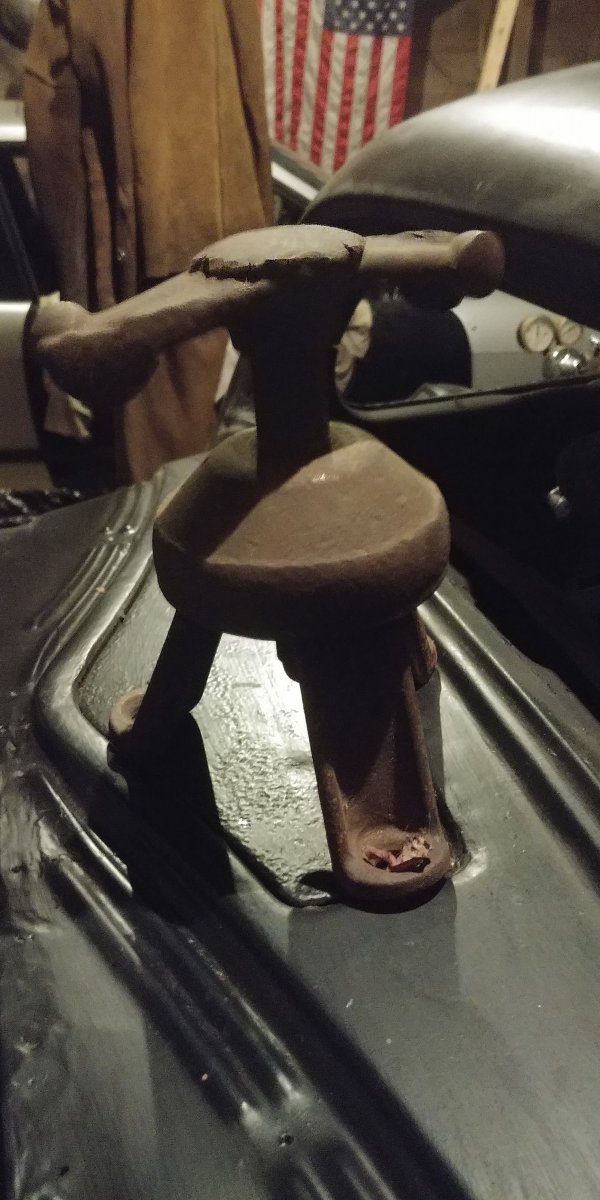

    Buy a drum puller. Its something you need to own when you have early cars. I've had 2 hot rods that I put model A banjo rear ends in. They can take a lot of abuse. I used to shear keys in my model A coupe often driving like an idiot and the rear end lasted. (till it didn't haha). Keys were one of Henry's better ideas.
    There are work arounds to not having a drum puller in a pinch but why bother?
    I've accumulated a small collection of them from swap meets. This old monster is my favorite. I don't mess with the Ford specific ones that grab the snout of the drum though i do have one somewhere.
