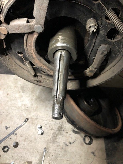

  2. Is the transmission in neutral, if so, that is where your motion is going? Take the nut off of the axle shaft, how much torque did it take to loosen it? If it is not very much you might get away with a cheap puller, just don't put too much force on it or you might damage the axle or drum.
    How about a photo of the axle where the key broke, it may be junk?

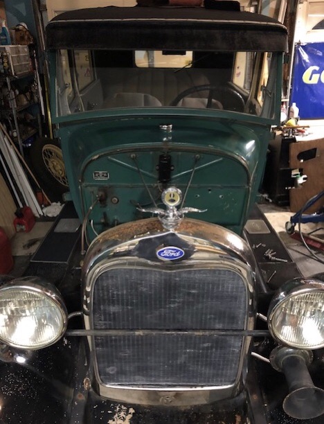

  4. Here is the axle that the key broke on. I also took out wood in front today. Cant believe there is no rot. Front shot in garage too.
  5. Also, the drum on the broken side has a ressed groove but the one that is tight has the external lip. 2 different drums...

    It looks to me like the threads are stripped on the axle. That's a good reason why the nut wasn't tightened properly.
    a loose nut will allow the hub to work back and forth on the axle causing the key to shear. If that nut was torqued correctly the taper would drive the car, not the key! Lathes and drill presses drive the chucks by the taper.
    You might be able to chase those threads by engaging a split die over the good inner threads and screwing it out.
    Don't think you will be able to get it started by screwing it in without cross threading it. That's most likely how they got damaged previously, because some fool swelled out the threads trying to beat on the end of the axle with the wrong type of hub puller.

  8. In addition to the threads being damaged as XIX32 noted it looks like the groove is "wallowed" out. It is possible it is just the camera angle, you could try a new key in it. This axle is ready to be replaced. I wonder if you should take the whole rear end assemble to someone that is good at rebuilding them? It would also solve the problem of getting the other hub/drum off. If the rear end ratio isn't 3.54 I think I would change it to that ratio.

    That's good advise from "Charlie Stephens" suggesting a 3.54 ring and pinion, and as he said you might have to pull that whole rear end apart to fix it properly. I've had some thoughts in the past about how to fix those stripped axle
    threads without pulling the axle out. It involves finding an "artist" with a Tig welder. This method is nearly impossible
    with out the axle out in a lathe, but maybe the stripped end could be welded up and then filed down ( or with a grinder while the axle is turning under power) to the correct o.d., then the threads rethreaded by engaging a split die over the good inner threads and then turning it out over the welded up end. Of course this method would be nearly impossible to accomplish without the axle in a lathe. .... just some thoughts.
