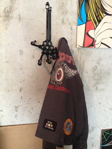

    had a bit of down time due to waiting for parts and decided to make something since i was in the welding mood, so i found this pretty rad little project online to make a coat hanger.. here a few quick clips..
    to show size of it [​IMG]

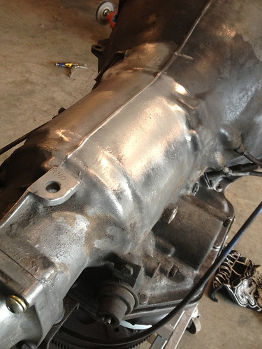

    still more down time waiting and waiting and waiting. so i rounded up some other stuff and got to cleaning up ? polishing my trans.
    IMG_3357 by abudhabi13, on Flickr
    IMG_3380 by abudhabi13, on Flickr

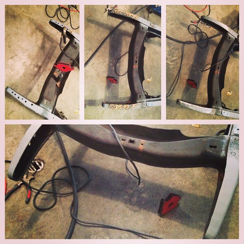

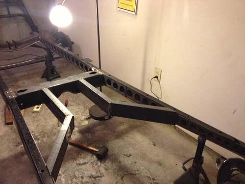

    finally some stuff came in , like the drilled boxing plates my biddy red out in cali makes, and went out to fastenal to grab a 6ft peice of channel bar that i wanted to use for a rear k member to strengthen up everything a bit.
    IMG_3421 by abudhabi13, on Flickr

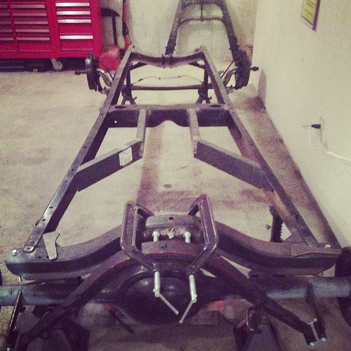

    gonna be running the spring behind the rear end, but need to make a suicide perch coming off the back, and yes i will weld in some gussets to strenghten it up, but any ways just to get an idea i mocked it up with some clamps.
    IMG_3449 by abudhabi13, on Flickr

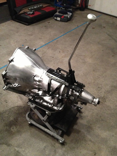

    What did you use to get this finish on the trans? Looks like a lot more than just some good ol fashioned buffing compound. Also, awesome work on the frame clean up, and I'm digging the claw hand coat hanger!
  20. Abu Dhabi
    Joined: Feb 8, 2011
    Posts: 81
    Abu Dhabi
    actually i used a wire wheel from harbor freight, put it on my handheld grinder and went to town, then just clear coated it.
  21. xwing01
    Joined: Jun 26, 2013
    Posts: 428
    xwing01
    Wow, so simple. Turned out amazing. I've got the exact same wheel from HF... time to get the 700r4 looking snazzy.
