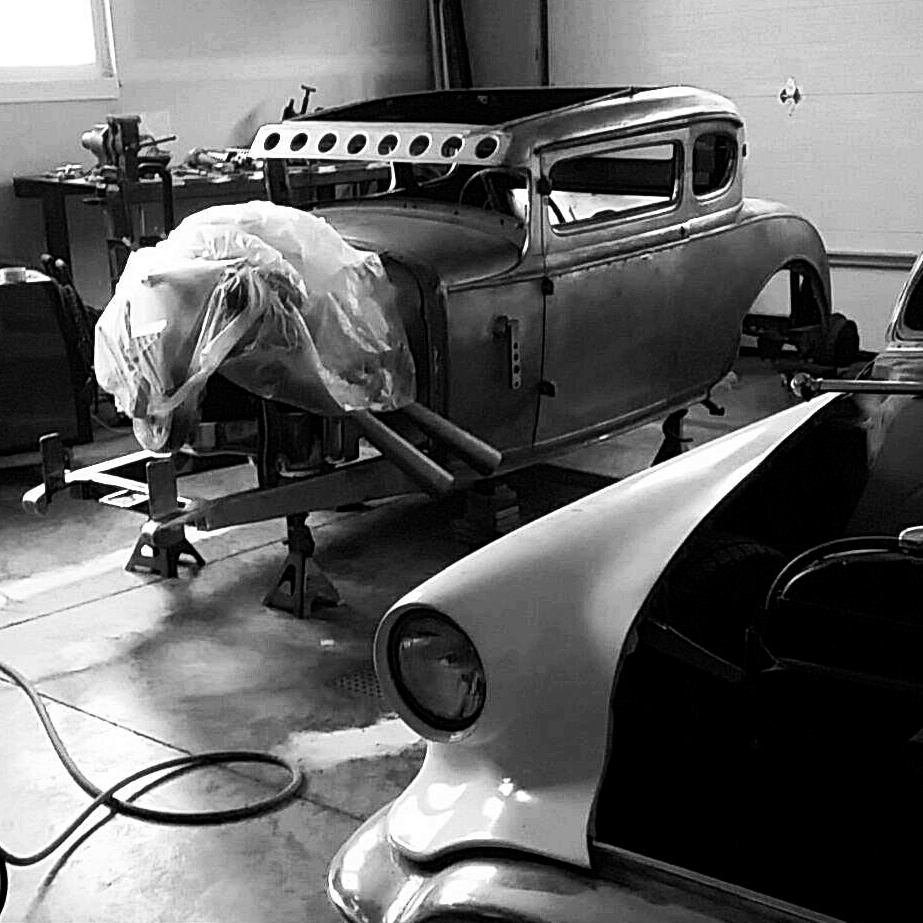

  4. AHotRod
    Joined: Jul 27, 2001
    Posts: 12,421
    AHotRod
    What is the distance from the floor to the bottom of the frame rail at the door?
  5. Drivinford
    Joined: Aug 24, 2012
    Posts: 823
    Drivinford
    The body is not sectioned over the frame, the frame is sectioned! Thanks a lot for the kind words, copy this thing all you want man!!

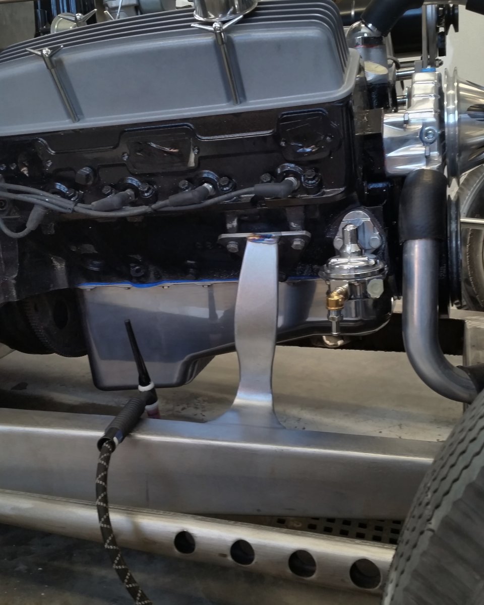

    Thanks alot, car sits about 3 inches off the ground by the cowl door area
  10. Drivinford
    Posts: 823
    Drivinford

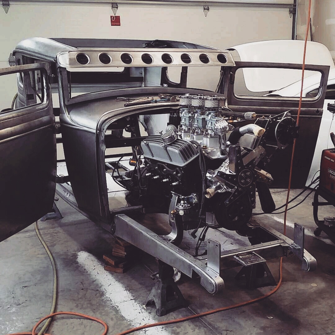

    Its an interesting build. Don't take this wrong, but it is a different style which I'm not sure what to call it. @ jackalope is doing a similar build. At first glance it looks like a R rod but the craftsman and talent by both of you, make it so much more. I wonder if this style is new or a nod to something in the past ??
    Also, in some of the other pics, it looks like the intake wasn't level, I'm I missing something or is that ok. No offense intended. [emoji41]
  23. Drivinford
    Posts: 823
    Drivinford
    Thanks! I don't see anything that says R rod, because r rod means s**** parts rust, chicken wire, and pieces put together from s****.... As far as the intake goes, it's not level, but that's how I wanted it, is this going to cause an issue, if so please explain? Thanks again!
  24. Dino 64
    Joined: Jul 13, 2012
    Posts: 2,539
    Dino 64
    from Virginia
    I guess the sooo low stance sort of gives it the R look. I agree, as I said, the quality of the build takes it out of that category. I think it's a very creative project and you've executed your "vision" beautifully. I especially like the engine mounts, very talented dude !
    I'm far from an expert, but I've always set up my intake mounting level. That's what I believe is correct, not for style but function. The bowls of the carbs will be tilted and the gas won't be level in the bowl so it won't be flowing through the float valve properly. Tilted toward the valve, it could flood or back could be a leaner mix. The flow of fuel won't be consistent.
    This my understanding of it, I my be completely wrong, wouldn't be the first time![emoji15]. Hopefully someone better informed can correct be if I am. Looking forward to more progress, great job[emoji106]
