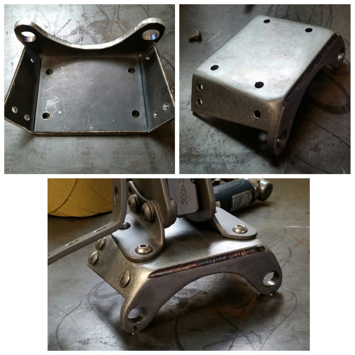

    In post 218 above, your split bone mounting points were TIG'd in and then smoothed out. How exactly did you accomplish that? I don't want to necessarily do that but I wanna know HOW you did it.

    Thanks, there a couple ways of doing it, the one I like it take 3 inch 60 50, grit sand wheel and cut four corners off, so it pretty much looks like a stop sign, then sand away! I can send pics if that will help!

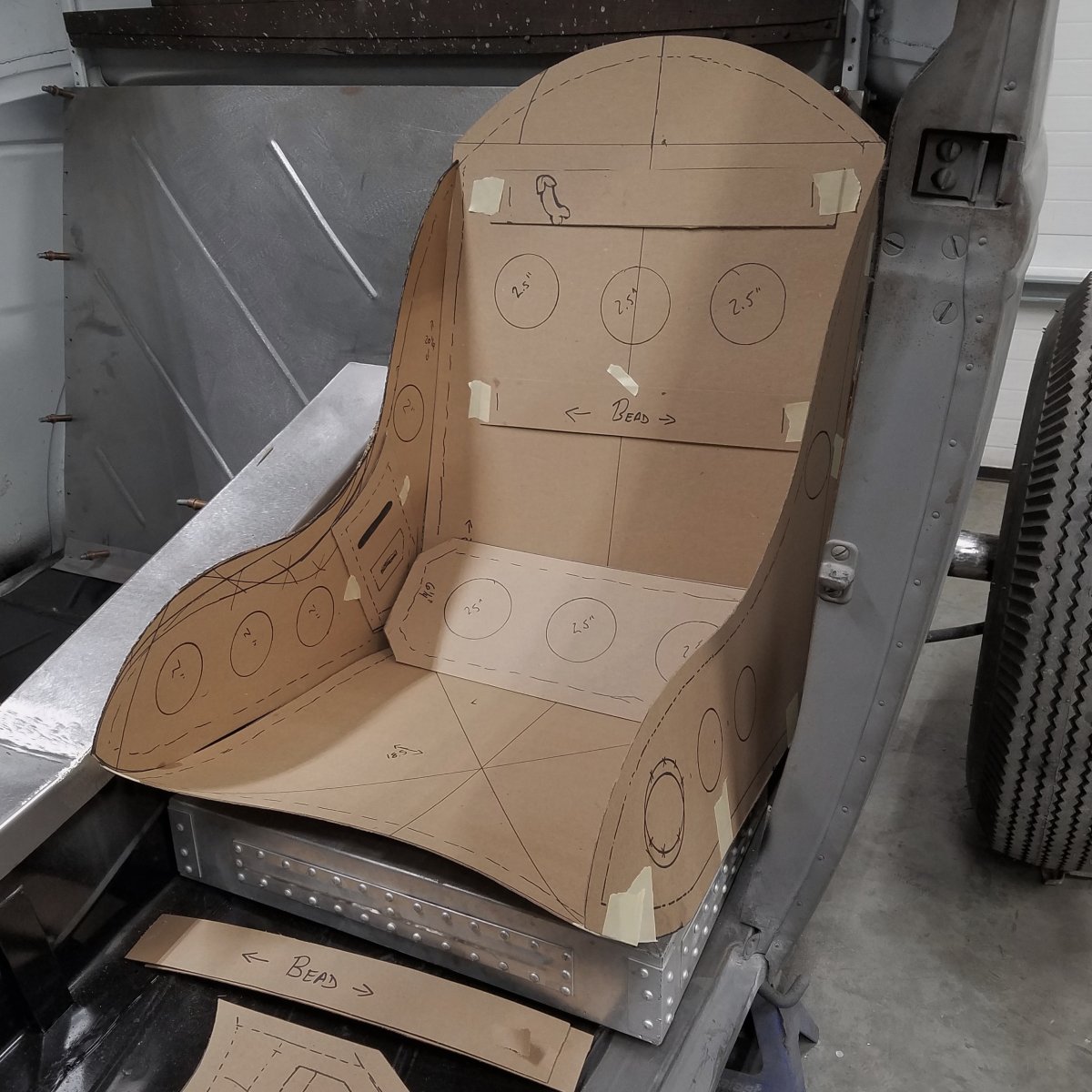

    Working on a set of bomber seats, here's a template for them IMG_20170204_000249_458.jpg
