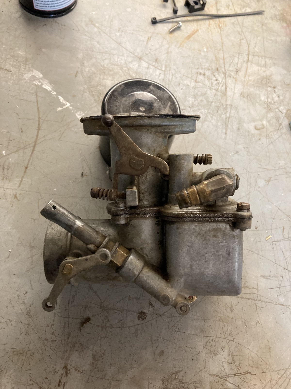

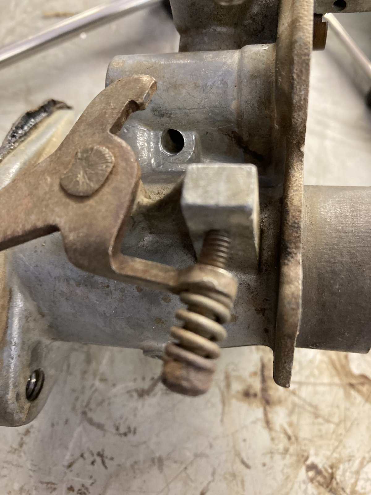

    9E4B91F8-3D31-45A4-9500-E73463812E4C.jpeg There is no tag on the carb. I measured the Venturi it’s .950 at the smallest point. 6B77A935-CCBF-4AD5-918E-E279022204DA.jpeg

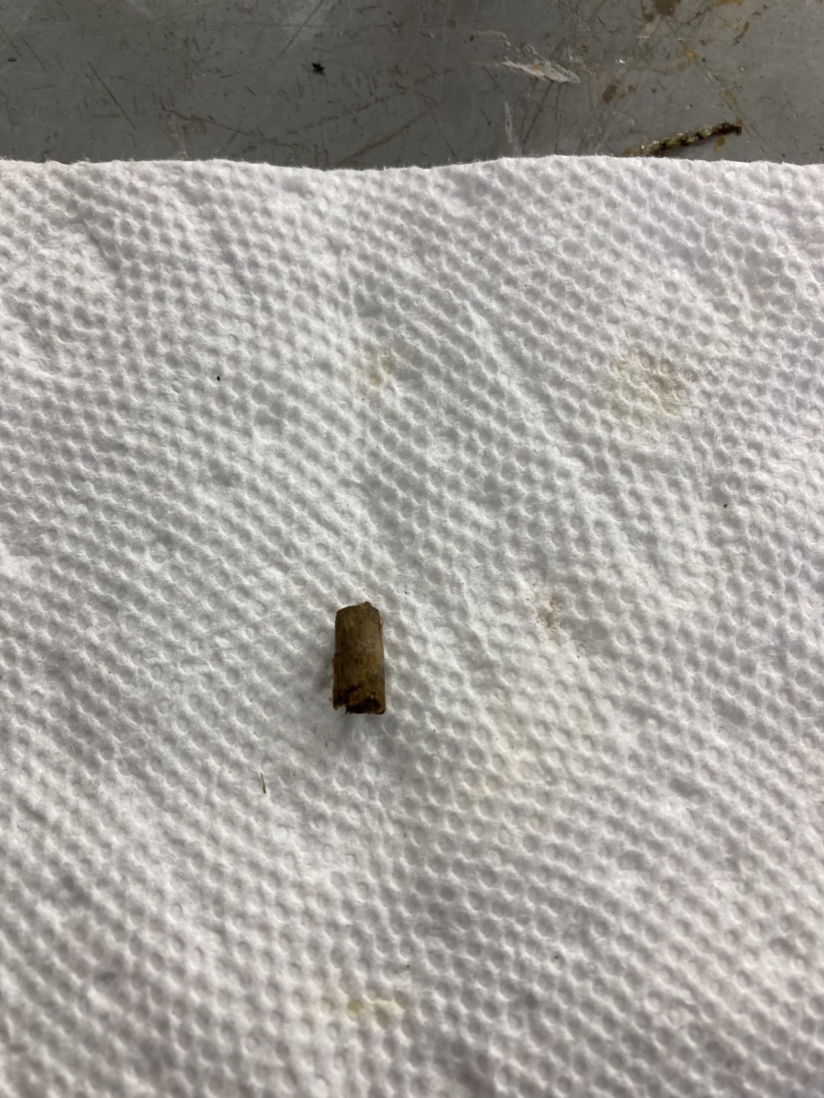

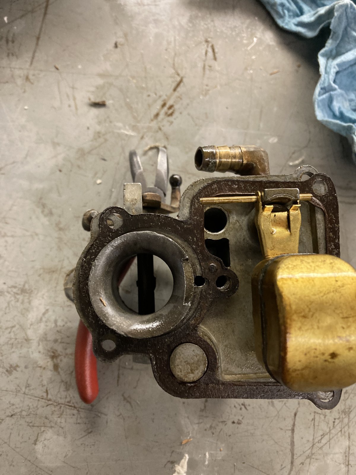

    Problem solved float bowl air vent was plugged runs like a million bucks. It’s been sitting since 1965 2E7A78D5-BE36-4F9D-AD12-0328CC8BF188.jpeg B23C737A-4AE0-4283-B377-A2732B7AC0C9.jpeg

    For future reference, the pictured carburetor is a Marvel/Schebler model H, and was sold as a replacement for the Ford models A and B.
