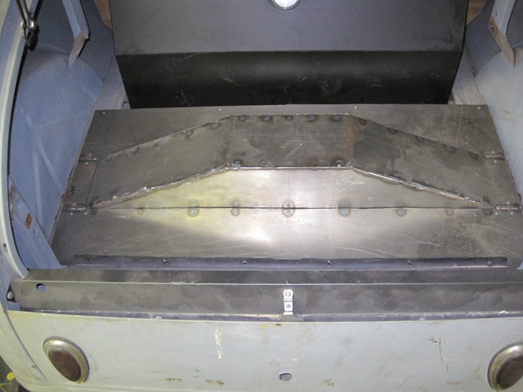

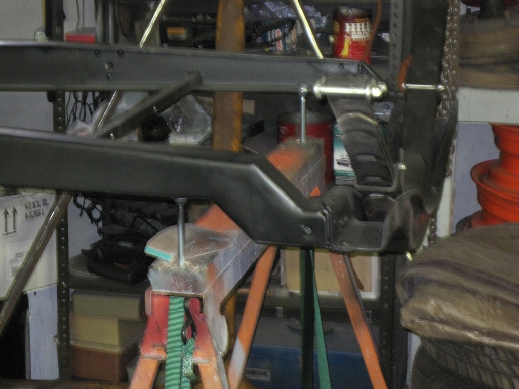

    Depends how much drop you want, I Z'd my frame the width of the frame and that was plenty since I'm building a full fendered car. My avatar was also done the same way. Had to raise the trunk floor and clear the rear crossmember which really cut into the usability of the trunk.
