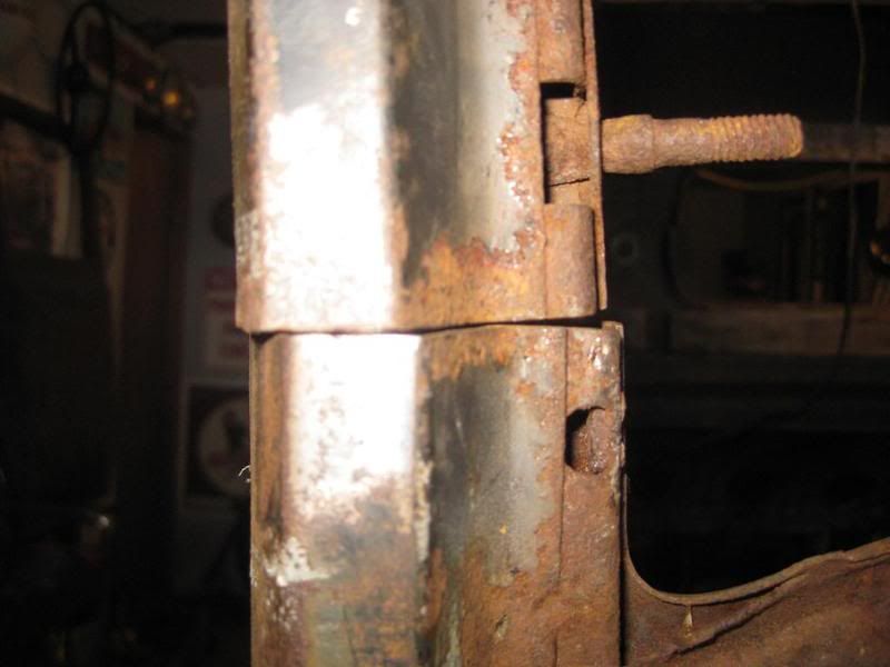

  1. So, when re-attaching the windshield frame or a pillar as it is known.....Test subject 1930 model A coupe.
    How do you line up the post? They are tapered so it's not a straight drop down. I was thinking I would use the inside of the post on the windshield frame side. Make that straight and square, that way the windshield fits. and pie cut the outsides to make them match.....that's all fine and dandy, but if I do that the other side doesn't line up. Should I cut them loose from each other?
    I'd take pictures to better illustrate this, but I can't find my camera.
  2. Found the camera
    here is the drivers side lined up and tacked once.
    and the passenger not tacked. the middle bar between the two is a little out of whack.
    My welder is warmed up and I'm hot to trot......
    I should also add that if I push the passenger side in so it lines up that the top is weird. I really think I need to disconnect the two pillars. But I wat to run it by a few of you.

  4. that's basically what I am planning. The problem is if I line up the inside of the windshield so it is square and straight on the drivers side. the passenger side is way out of whack. If I try and suck the passenger side of the post in so the bottom, where I will weld it is flush on the inside of the windshield frame. the top of it isn't square. It's like it is wider at the top of the a pillar vs. the bottom. I think it is because the metal piece that connects the two is messed up.

  12. I should ad I did not chop this car. It was chopped by someone else and not braced. It's pretty fucked.
    And yes the header piece between the two is bent. probably from being loose for 20 years.
  13. Well, that would explain a lot. I was kinda thinking they might be wider. I think I might take most of it out and replace it with the straight piece from the rusty A pick up cab cowl i have....just about the only good piece on it. :rolleyes:
  14. I think I'm going to cut the two pillars apart and weld them on by themselves. I should also ad the my roof is not attached to the A pillars either.
    here is what I am working with, except I removed the door top.
    It's surprisingly square.... considering the lack of bracing.
  15. You could do each A pillar one at a time, but when you go to attach the rest of the roof, make sure everything is square and braced or you'll fight it from then on out
  16. I think my plan at this point is to split the a pillars. I will build the car from the A pillars back, so It's pretty important to get those right. After that I either need to attach the top or replace the subframe. I'm. not sure which direction to go with that. either way the back portion is going to get braced, So that is next on the list.
