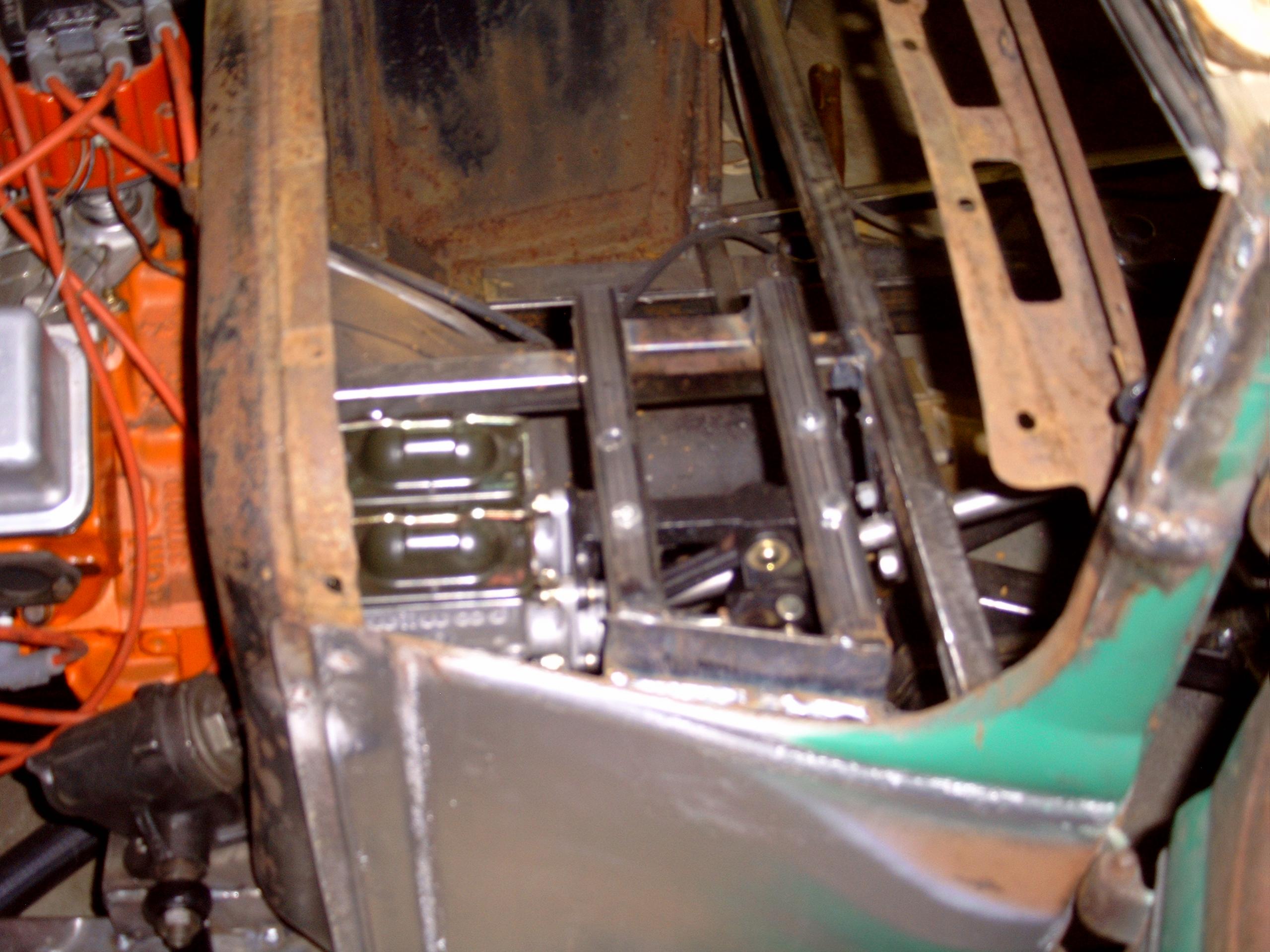

    I happen to like heavy chops and mailslot rear windows. The first chopped car I ever saw was the "Big Al" 34 sedan dragster at Garlits museum. I think that had a lot to do with it:D Anyways, I chopped mine 6" and with my long wheelbase (115") I think it works pretty well. Over chopping can make these ****ers look a mile long.
    One thing I ran into is the A pillars taper at the top when viewed from the side. So when I lined everything up after the chop there was about a 1/4" gap in the front of the A pillar with the back (door side) lined up. I simply took a wedge of the A pillar I cut and filled in the gap.
    To make the car somewhat comfortable I actually sit in the rear footwell which meant I had to make the steering wheel removable. Would I chop one this much again? I don't know, I think it turned out pretty cool for my first try but I would most likely go a little more conservative next time around. Here's some pix, hopefully you can see the wedge deal I'm talking about on the A pillar. I also used about three small relief cuts on the rear roof corners to get things lined back up. Good luck.
