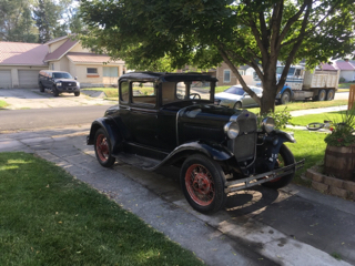

    I just drug home a stock 1930 model A coupe. Going to leave the motor stock because it runs great. I have 35 ford 16 inch wheels and need to buy tires. I would just like make it look a little less stock but not spend much on it. Any ideas would be great along with what tire size and brand I should use with the 16 inch wheels [​IMG]

    700/16 and 5.50/16 bias plys, lower the front a hair and pull the bumpers.

    Thanks for suggestions want to order tires this week so that will be the first thing then I'll lower it a little and remove the bumpers

    Look up Ron Brown's thread on lowering the suspension. And you CAN leave the mechanical brakes - they work fine if they're set up right.
    Wires and 6.50 x 16 tires
    lower the headlights
    PLEASE - LEAVE THE FENDERS ON, AND DON'T do a radical CHOP !! ( or it will look like every other coupe in the world) 3"MAX, IMO
    If you decide you need more go-power, that little banger can be m***aged to almost match an early stock V-8 - Banger guys on here with LOTS of info.
    Take your time deciding, and have fun.

    I'm planing on leaving it with the 4 banger because it was rebuilt. I like the bangers but I do want to lower it an leave the mechanical brakes. So I will look at the thread because I'm wanting it too stay pretty stock other than ride height, tires and wheels and maybe remove the bumpers. It's too nice too cut up in my opinion.
