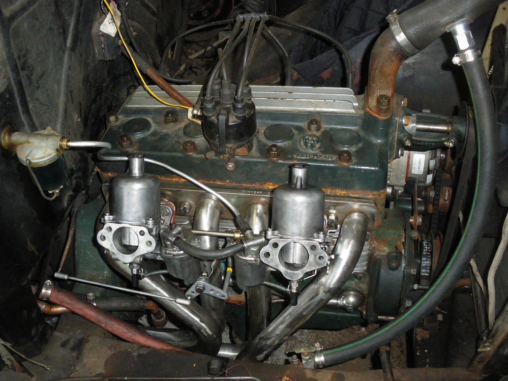

    That tire setup worked great for me. Went to a Mitchell overdrive,hi compression
    head, B cam and carb. Worked great, ran strong, cruised 55, top of 70. Ran it hard
    for 15K miles, fun car.
