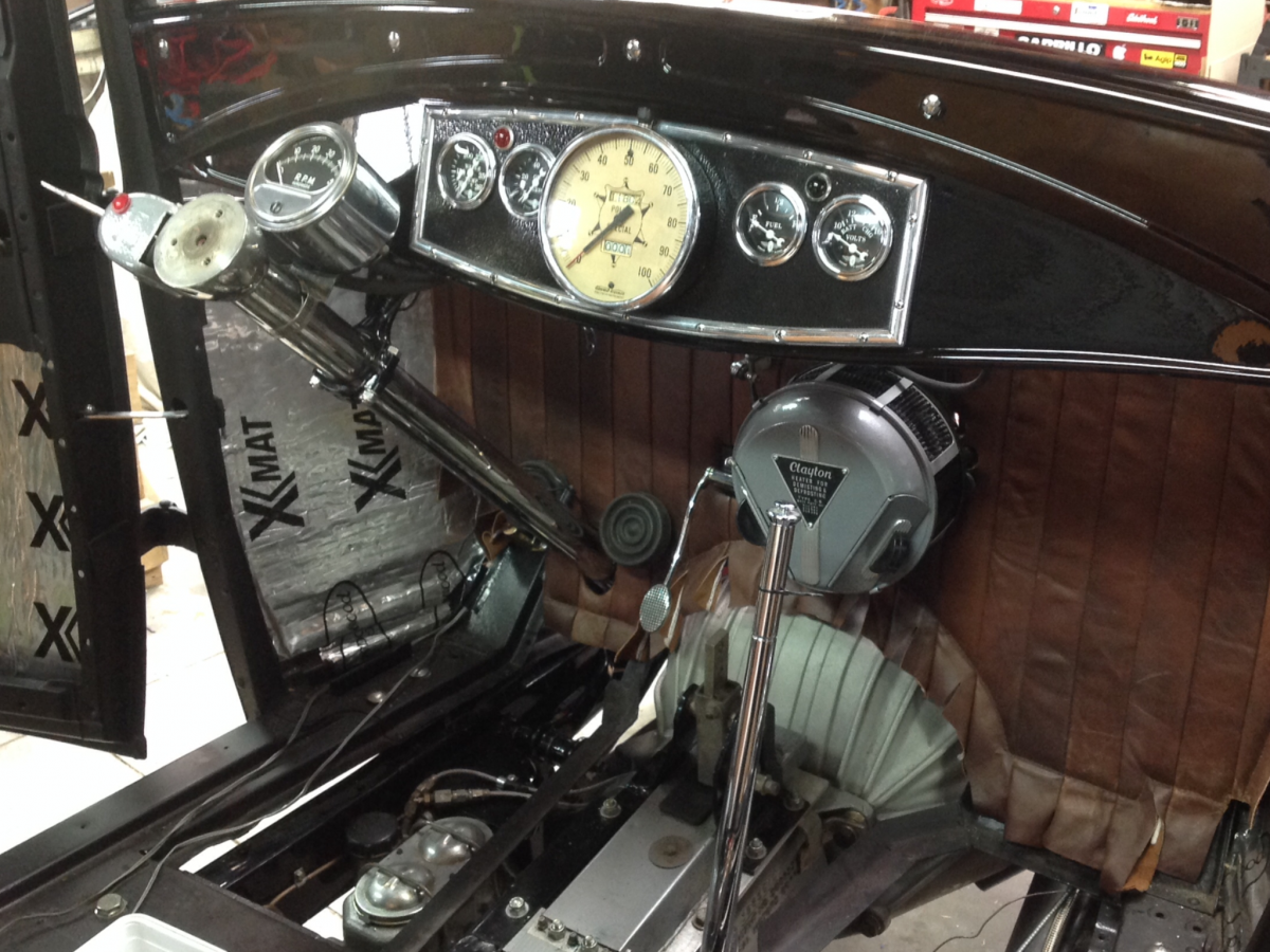

    The XMat is supposed to be “thermally stable”. It is a butyl product, not asphalt. I installed it in June, no problems yet.

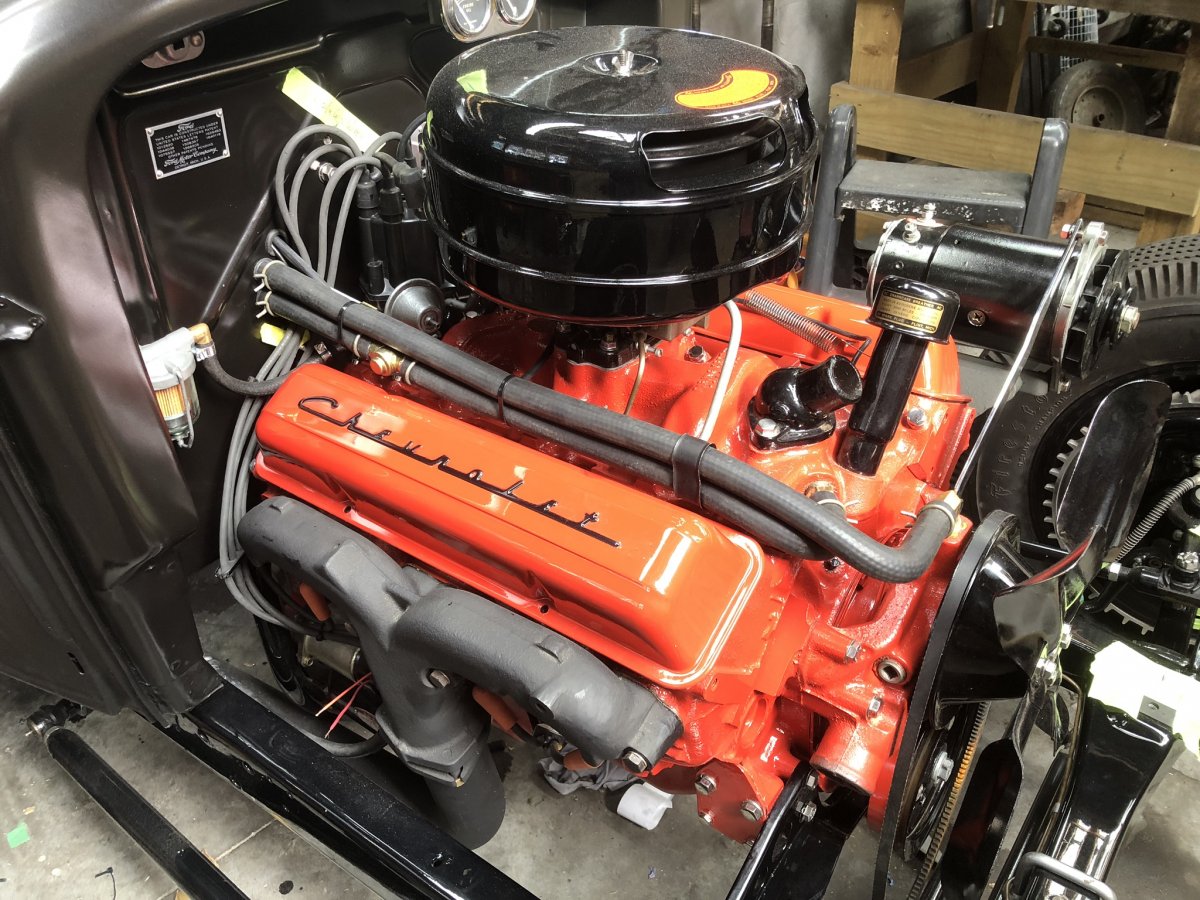

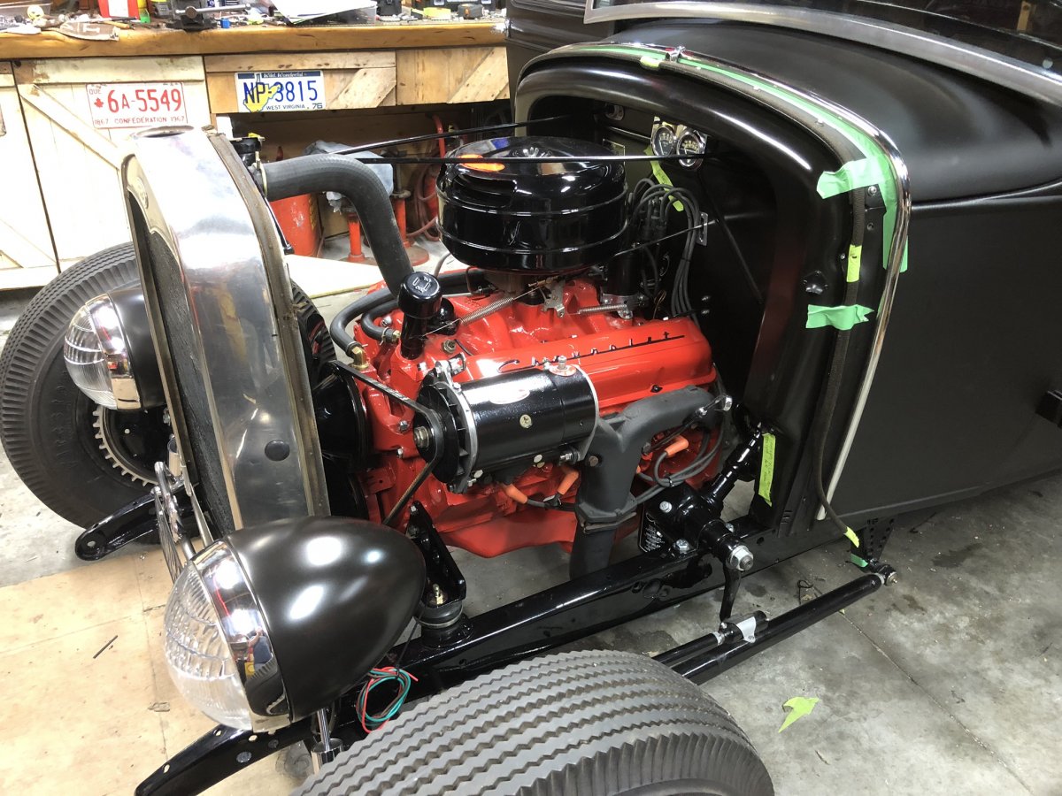

    Really happy with the progress,,dash in and wired,steer column in ,throttle pedal fitted,heater in and hosed to the motor,fuel lines finished from tank to carb,seat riser painted an fitted,all battery cables finished,going thru master switch mounted in front or seat riser ,,,holes drilled for wiring loom to rear of car ,fuel tank,pump,tail lights etc,all capillarys fitted for gauges,
    Life is good,,,spending a load of time in my garage putting the hours in,,,my darling wife reckons she hardly see's me at the moment ,an she is a "hotrod widow",,,but she is really supportive, and encouraging me to finish this build so I can get on with our 56 Nomad,god bless her, IMG_0138.PNG
    JUNK ROD, brEad, Stogy and 3 others like this.

    Nice, heater looks awesome.

    Out of a Pom bomb(English car),very simple and compact,and flush mounts to the firewall ,so ideal for a hotrod in our winter conditions
    Cheers

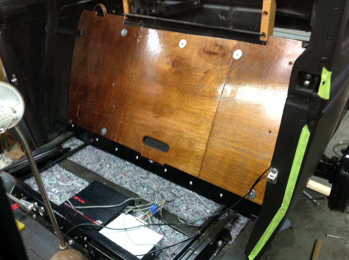

    Fitted the steering wheel a few days ago,and motoring through the job list,just about got everything finished ready for wiring,,,got the drivers and p***engers door gl*** ,channels,felts and winders in also over the last few days,will fit quarter gl*** and rear win down window to fit over the next few day, IMG_0156.PNG Rocker Covers fitted and engine pretty much completely,got the radiator and grill shell to fit tomorrow IMG_6394.jpg Pretty happy with how the engine has turned out, IMG_6398.jpg
    The rear bulkhead is all in place,put fuel into the tank as well,probably do a start up tomorrow after bleeding the clutch and brake system
    An yes that is one of those them there stereo things which is hidden under the seat in the riser ,,,,,,I really enjoy my music,,,the speakers are also hiddden up under the dash,
    hate seeing stereos either set into the dash or hanging down underneath the dash,,,and hate speakers in door or kick panels IMG_0147.JPG
    JUNK ROD, brEad, 30 AV8 and 7 others like this.

    Good work mate. Anything to be gained noise wise by putting a box type thing over each speaker?
  18. Coming along just fine. Been watching. Looks great! I’m with you on the tunes brother. Gotta have em. Great way to hide it. Terrific job so far.
    whitewallwilly likes this.

    nice job routing the temp probe.whats the black finish.access to the gauges/wiring is excellent.i could have done with that. neat job on the heater hoses as well.
    Stogy likes this.

    Hi Mate,
    I've put dyna mat all up under the cowl,firewall area , I'm hoping that will work ok,,, will let you know when I'm listening to Johnny Cash at full volume
    Pete Poling, Stogy and nunattax like this.

    The temp prob cover is part of the capillary tube,I'm running Stewart Warner gauges, I've secured it to the two clip that are spot welded to the rocker cover for the wiring that goes to the generator
    Cheers

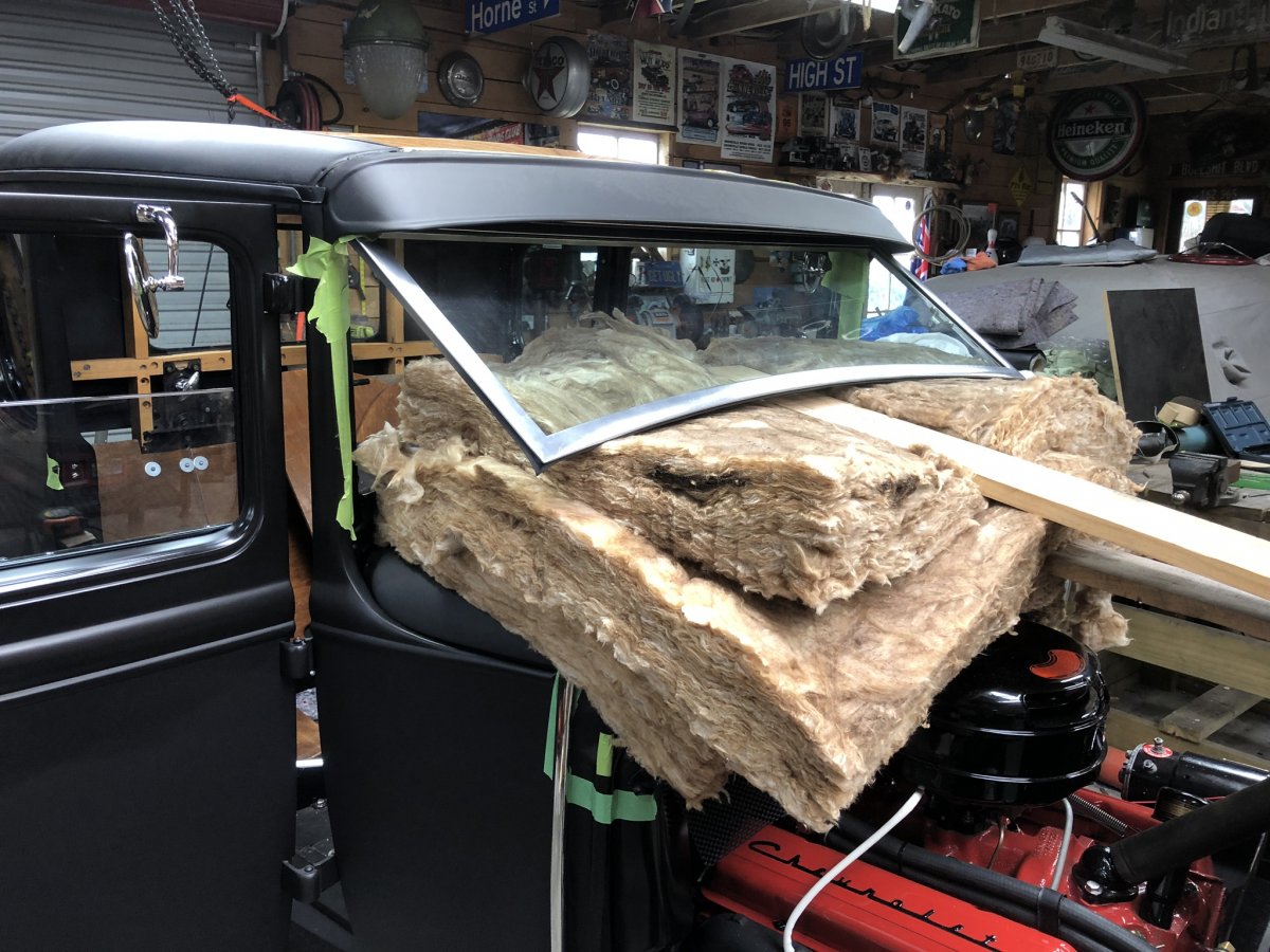

    Fitted the ***embled windscreen ,,,did this on my own,,hence the insulation panels as another set of hands

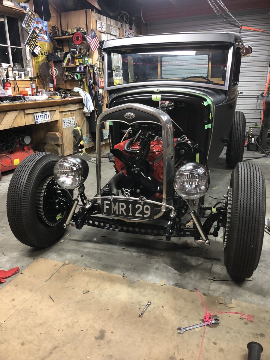

    Pretty stoked with the 36 headlights,tried to keep them low and set back so they don't look like dog balls hanging out there IMG_6512.jpg Tidied up a few more jobs,new bracket soldered onto the radiator top tank for the surround and cowl support rods,made up a ignition wiring loom for starting purposes,bleed brakes,clutch,filled and pressure tested cooling system,fitted the trunk lid,and rear exhausts an mufflers, fired the motor,ran up to temp,good oil pressure,set timing ,adjusted carb idle,,,,everything seemed fine, IMG_6536.jpg threw a couple of cushions in for seats an took the car for a short burn down the road with the caps off,just so the neighbors could see an hear what I've been working on for the past few years in my garage IMG_6535.jpg the highlight was taking my 3 year old granddaughter for a short ride,,she thought it was loud,an had her hands over her ears the whole time,told her to get use to it, cause it don't get any better than that,,

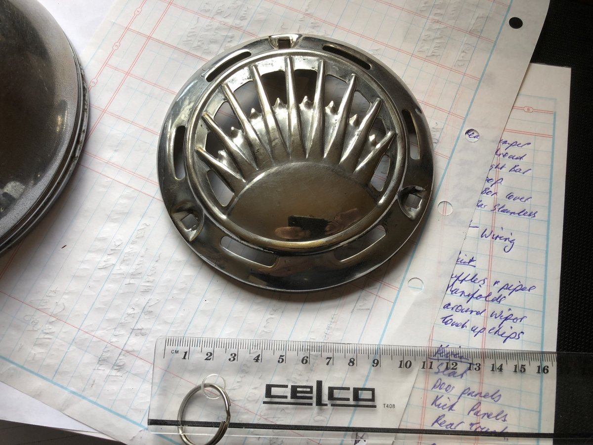

    Rebuilding this horn for the Model A
    Can anybody identify it,,I think it could be off a motorcycle,the one on my 41 Indian is similar,but no the same
    Cheers
    Stogy, Jet96, nunattax and 1 other person like this.

    Sorry guys,didn't want to upset anyone,,here's another pic, this time with a proper ruler in inches IMG_6525.jpg
    Tim, Stogy, AHotRod and 1 other person like this.
