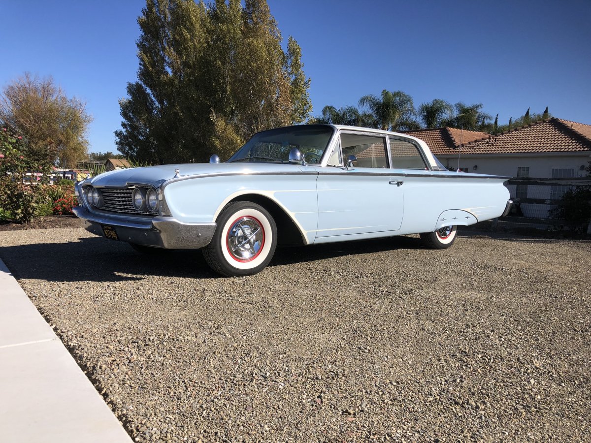

    Well ,back home from my trip to California to The Hotrod Reunion,,,,,,this 1960 Ford Fairlane followed me back to New Zealand,,brought it off a friend up by San Francisco,drove it down to Bakersfield to the Reunion,,,always a great event,,also went out to Santa Margarita to the RPM Flathead Nationals ,man that was an awesome day,,,I would recommend that to anybody ,vintage flathead drags,,,swapmeet ,an Hotrod display,,,it was well run ,
    Carried on down to Huntington Beach via the Grapevine, spent the last week picking up a few parts around that area ,for up an coming projects,before dropping the car at the shippers IMG_6694.jpg IMG_6696.jpg

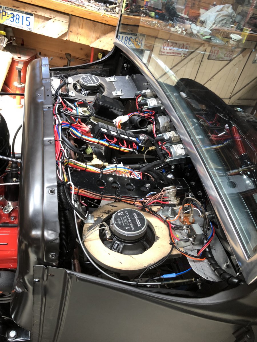

    Now back into the Model A,wiring is now complete,,,,and ready to fit the cowl to windshield panel that used to be the fuel tank,,,,,
    All the wiring is accessible from underneath the dash,with the relay panel hingeing down for access IMG_7588.jpg
    The heater/windscreen demister pipe will have an outlet attached and directed to the windscreen thru the slots in the lower rear cowl area,
    The list is now getting much shorter,,, and a few jobs to do for our LVVTA(Low Volume Vehicle Technical Association Inc ) Certification that is a requirement in NZ, IMG_7587.jpg

    What a sweet Fairlane ... nice score!

    What a sweet wiring job!

    I really like what you have done under the cowl / tank top, but what are your plans to keep everything dry in less than perfect weather? I'd love to do something similar when my 29 coupe build starts. Thanx, Gary

    Thanks for the comments,I will be fitting the cowl cover this weekend,I will be using a sealer instead of the original type sealing ,I reckon I will get it sealed up pretty good with a black silaflex type sealer

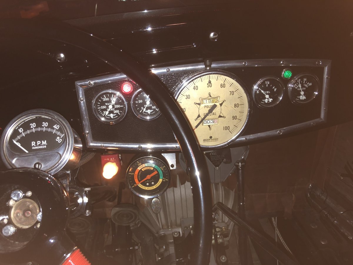

    Fitted the heater switch and ran the vacuum line to the gauge IMG_7599.jpg Fitted the "Guide" Traffic View Finder, IMG_7600.jpg . Tested the tail lights ,brake,flashers,still have to fit a couple of small reflectors IMG_7604.jpg . Front park lights also double for flashers IMG_7606.jpg Dash lights, red oil pressure light on left and generator charge light on right,and illuminated heater light comes on when heater switch is turned on, IMG_7608.jpg

    Fitted the cowl top cover today,used a good quality paintable sealer insetead of gasket seal strip,,,, the toughest job was getting the 10 rear bolts that go up from behind the dash panel,used some turps for clean up

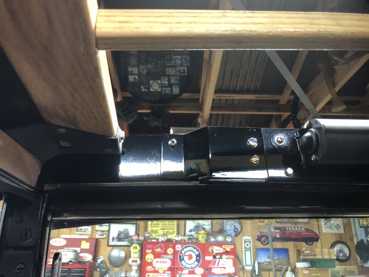

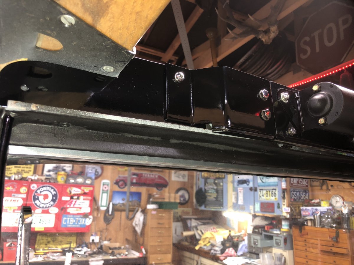

    So tonite I needed to tidy up the areas either side of the Newport Enginering Wiper motor,, rather than try an cover it over with a fabricated cover I thought it would look ok exposed,I added a little Trico Wiper brass name plate,some polished stainless mounting bolts ,and I cut a plate to cover the header wood either side, IMG_7656.jpg
    R/H side
    IMG_7655.jpg 've got a couple of brass plaques to rivet to the R/H plate ,,to smart it up a bit IMG_7661.jpg

    exposed motor with the new timber look well.how did you route the wiring
  17. whitewallwilly
    Joined: Apr 2, 2012
    Posts: 208
    whitewallwilly
    Managed to feed the Wiper wiring up thru the l/h front pillar,I did this before I installed the wooden front header then routed a groove thru the wood for the wiring the run,
    Cheers
    Rich B. and nunattax like this.

    I've got to get the speedo reading right,,at 60 mph the speedo is reading 87mph,,
    I've changed the drive gear to a 9 tooth part I got from AGE,I've got 7.50 16 tires ,which I reckon are round 30.5"diameter,an the rear end ratio is 3.19 to 1,,
    The speedo calculation says I need an 18 tooth driven gear,, which I done ,but the speedo is still a long way out
    I'm thinking maybe a speedo ratio adaptator like PATC sells ,, but I'm trying to figure what percentage in need to change by,,,I have the full range of the color coded driven gears ,so if I can get the speedo reading close to being right by adding a ratio adaptor, then I can dail it right in by changing the pencil type driven gear
    My tachometer is also not working,so I can't tell what RPM the engine is doing,,the tachometer was working in the car I took it out of,I'm wondering if by fitting a Pertronix unit to the distrubor, its not picking up the pulse
