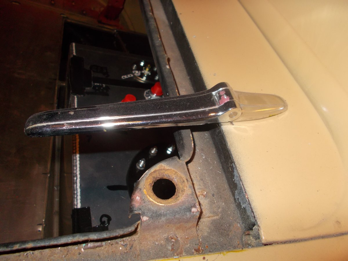

    Well I wasn't happy with the trunk hinge deal,it was the original ,,with bolts coming in from each side very hard to get to,,,,couldn't get a spanner on the bolts heads,and the holes in the trunk lid were quite sloppy,,,
    ,I'd seen a few Model A coupes with external hinges mounted outside on the top of the trunk lid,
    I looked at 37 Ford Tudor trunk hinges,these had quite a big offset because of the curve of the top of the trunk,
    I started to look at other types of cars , early VW, Morris Minor etc etc,
    Then I hit the jackpot,, Austin Mini car trunk hinges,not a very big offset,quite small in size so as not to be intrusive to the look I was after,
    And best of all only $45 pair chromed !!!!!
    So l started off by putting the hinges in line with the outside of the rear window,marked the holes in the trunk lid,bored a access hole for the rear bolt
    Used the left hinge on the right,,and visa versa
    Trimmed the edge of the inside trunk edge to clear the top body flange,an drilled the front hinge /trunk holes,I fitted a stew in the front heard because of me minimal clearance when the trunk is lifted IMG_7874.jpg
    Then drilled the body holes,,, these lined up perfectly on the inside giving ample room to get nuts and spring washers IMG_7869.jpg
    IMG_7876.jpg I didn't have to alter the hinges at all,,,
    So tomorrow I will make some rubber gaskets to go under the hinges were they bolt through the trunk and the body,
    Another job ticked off the list,

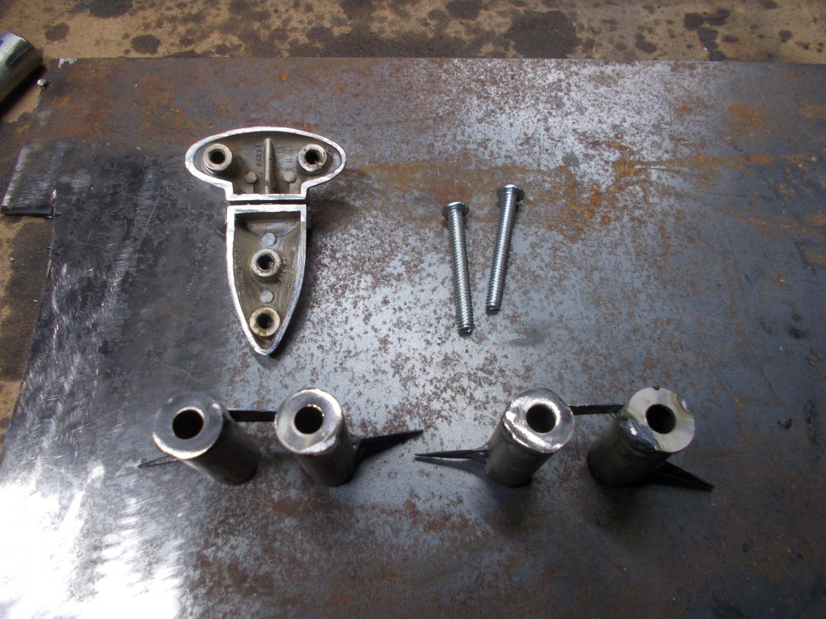

    I had a couple '35-'36 trunk back hinges... tough to start the nuts as they are so close to the gutter flange.
    i cut [2] 2" chunks of 1/2" conduit... to protect from welding splatter duct tape and then set the hinges upside down on the bench, center the 2 conduit spacers over the mounting holes, tack a small strap to attach the 2 together... install the hinges on the body and slide flat and lock washers onto the bolt... now starting the bolts will happen below the flange much easier...
    I also build a boxed channel into the decklid's inner skin, same level as the area where you mounted the leading bolt / screw... this gives the hinge 2 layers of steel to support the weight of the decklid... less apt to crimp the skin...
    most later model hinges are cast deeper on the outer edges as the newer cars were rounded and on a flatter decklid the hinges will bind... mark how much to take with a sharpie and use a sanding disc to remove what must go... I made final passes with a cut off disc... be careful it digs in quick...
    pix on frozen computer... my $0.02.
