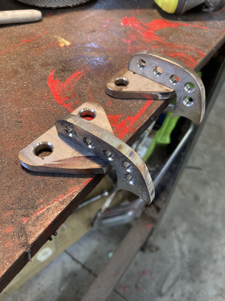

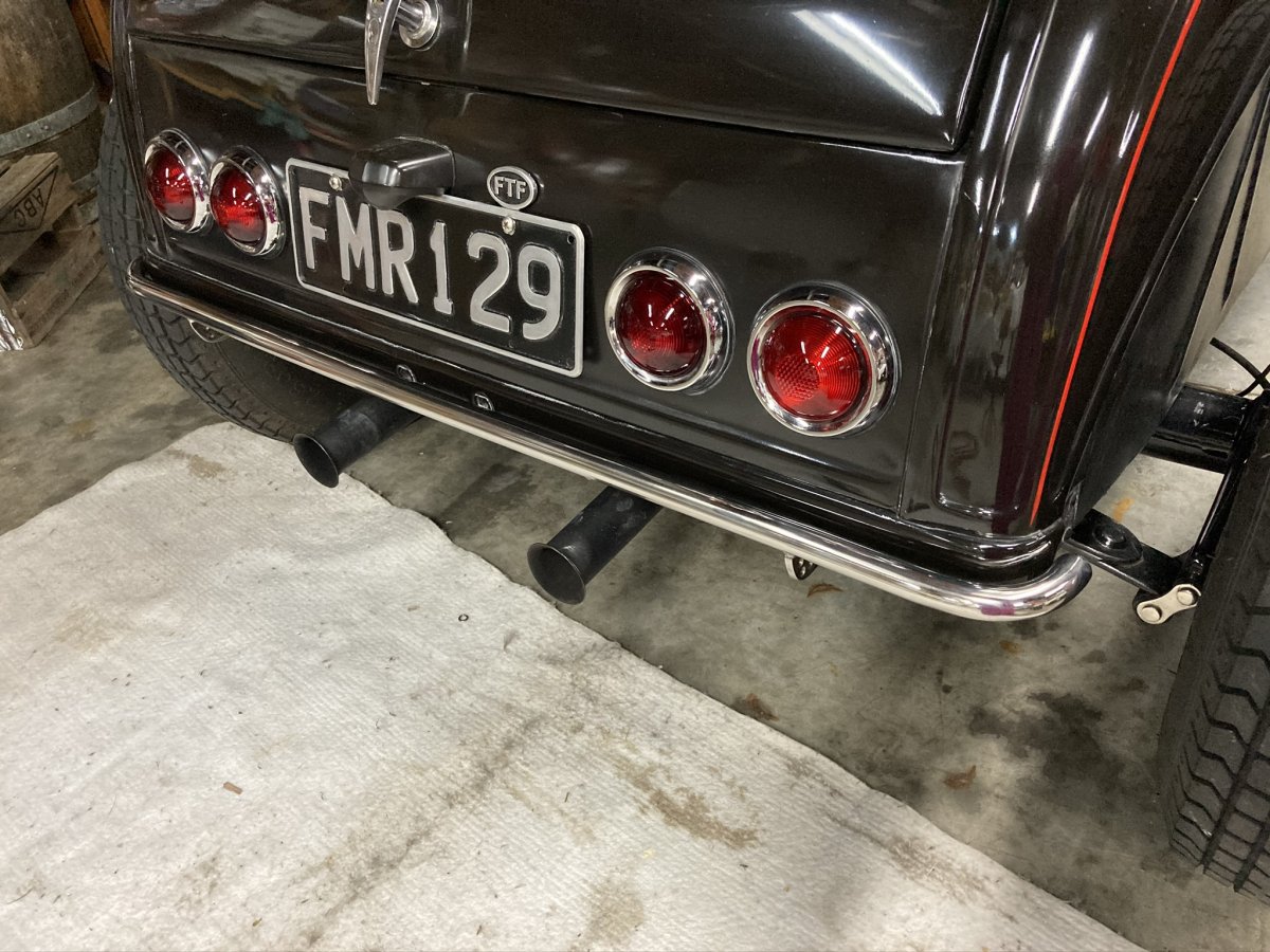

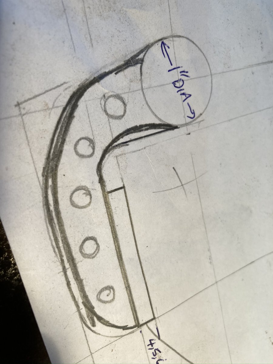

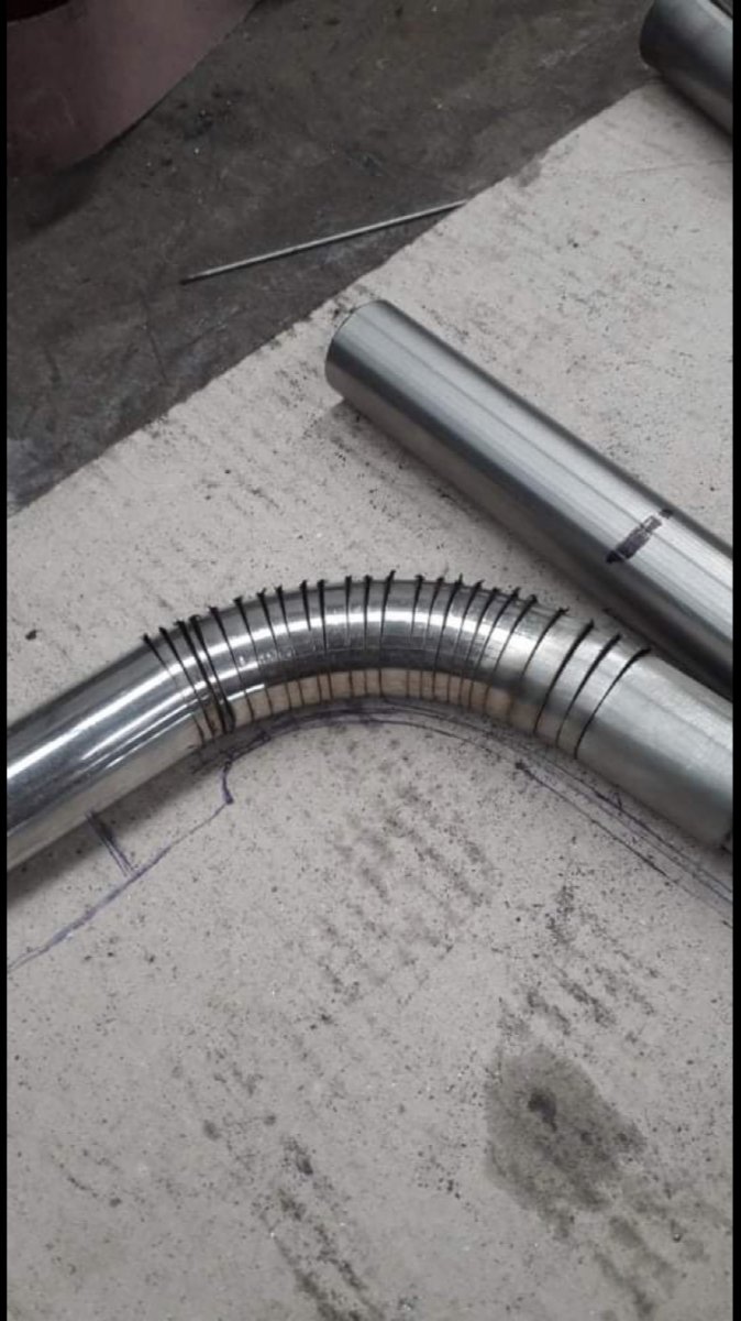

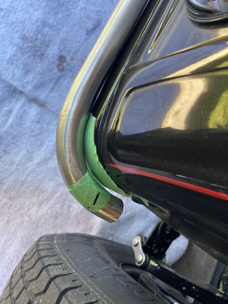

    So today was rear nerf bar day,was trying to figure on how to make support brackets that looked ok ,came up with tis to bolt up under the rear body lower flange 9036CB7E-C5C3-4318-8BD8-0E5B11409373.jpeg
    and a bonus was my 3 1/2 year old granddaughter Giving me a hand ,,beats playing with dolls,,,
    A friend who pretty slick at stainless welding made up the rear nerf bar out of stainless 1” tube and forming the bends to mirror the lower outer body radius’s B49C2101-CB12-4B27-834A-D8D5523D34F0.jpeg
    The nerf bar will sit off the body by 1/4” and will sit about 3/4” above the lower body edge,,
    Still undecided on how to finish the 2 ends,,,rounded,tapered,
    , ,I need to have a look at a few examples 9DD5F171-D493-4D1F-95A3-5CFB4D71FDBB.jpeg

    Looks good !
    Advantage with stainless steel is that you can polish it up really nicely to look like chrome, yet cheaper.
    Are you going to metal polish the brackets or paint them ?

    I’m going to polish the brackets and tube ,,,then coat it in Sharkhide Metal Protectant,,I’ve used this on a lot of alloy and stainless parts and it seems to work great

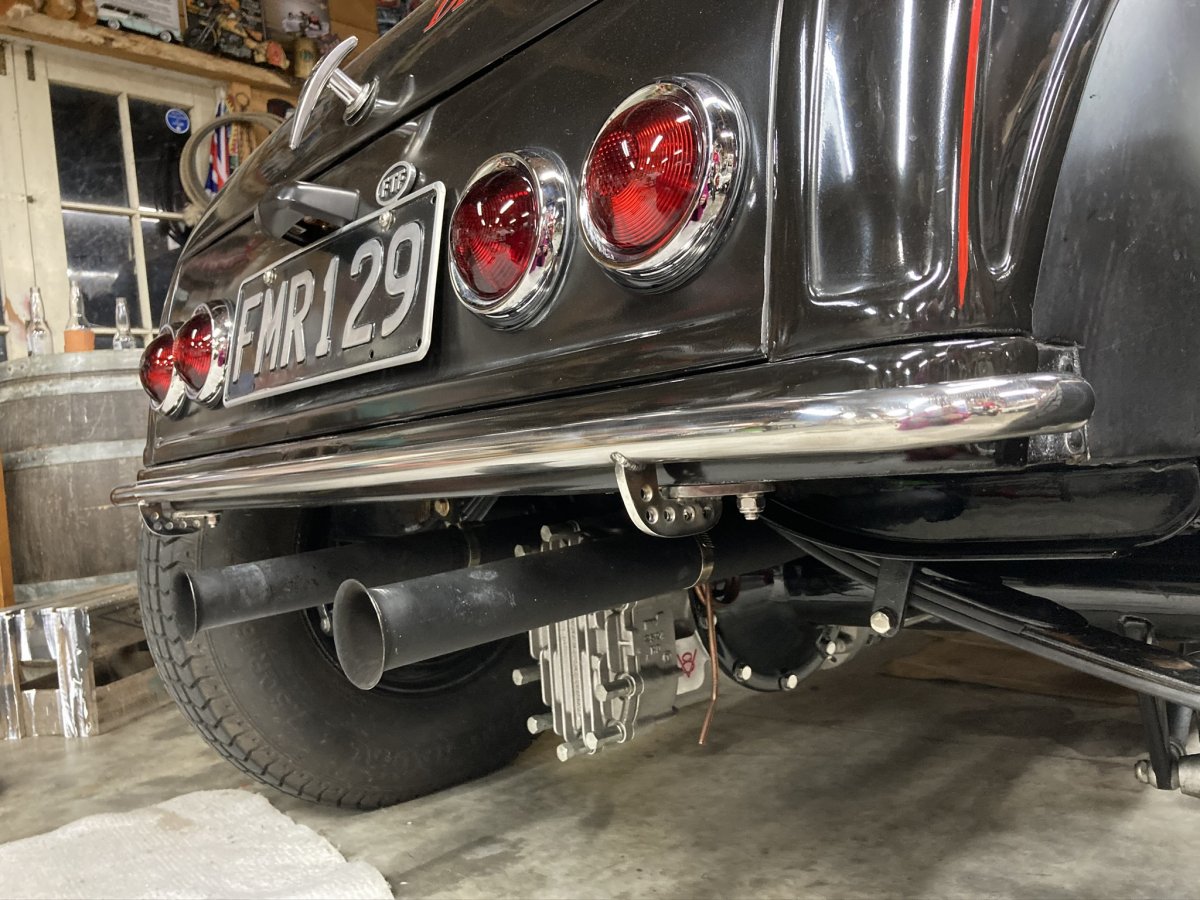

  6. whitewallwilly
    Joined: Apr 2, 2012
    Posts: 208
    whitewallwilly
    Been really busy on outside house projects with spring and daylight savings started,,
    Finally finished the rear nerf bar,with the help of a buddy finishing the fab and welding,
    l have been driving the **** out of the car,In the rain and at night as well,
    I’m really happy with steering,braking,handling ,lights ,wipers etc ,and general performance ,I reckon I might have another go at trying to get the rear suspension riding a little bit softer,
    I don’t want to compromise the ride height ,so will need to think things through before ripping another leaf out,,,,,,,I’ve had a few p***engers ride with me and they all say it’s not to bad, an that they have ridden in model A’s a lot worse,
    Our New Zealand roads are not that flash in comparison to the freeways I’ve driven in USA,,with main our state highway 1 ,resembling a back country road that’s had little maintenance in 20 years,, B55B2DD9-9A67-47FF-9ABB-9FFF1BDD97A6.jpeg
    All buffed an polished 9E6C3F15-34F8-48CD-BBD1-F78B65EBA379.jpeg Final fitting,pretty happy with the result 10623FAA-3B09-40C9-8A6F-3CEEA3BBAA2D.jpeg

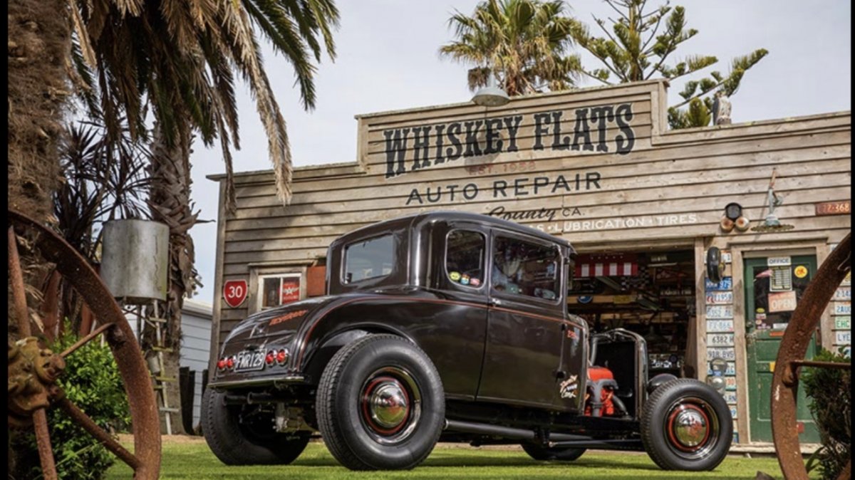

    Next up was a photo shoot an feature in The “New Zealand Rodder“,
    This is a half yearly publication and is of the same caliber And quality as The Rodders Journal ,
    Again the photo shoot was done at home in the Whiskey Flats Shop 22444D86-6D14-4AA5-B025-99BEB7B0CAB6.jpeg

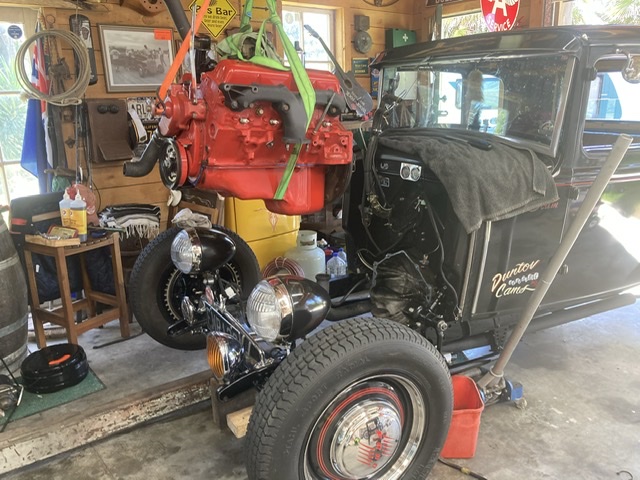

    A bit of maintenance,plucked the engine and repaired a gearbox leak,back in and ready to roll same day,
    Spit an polish an we’re back on the road
