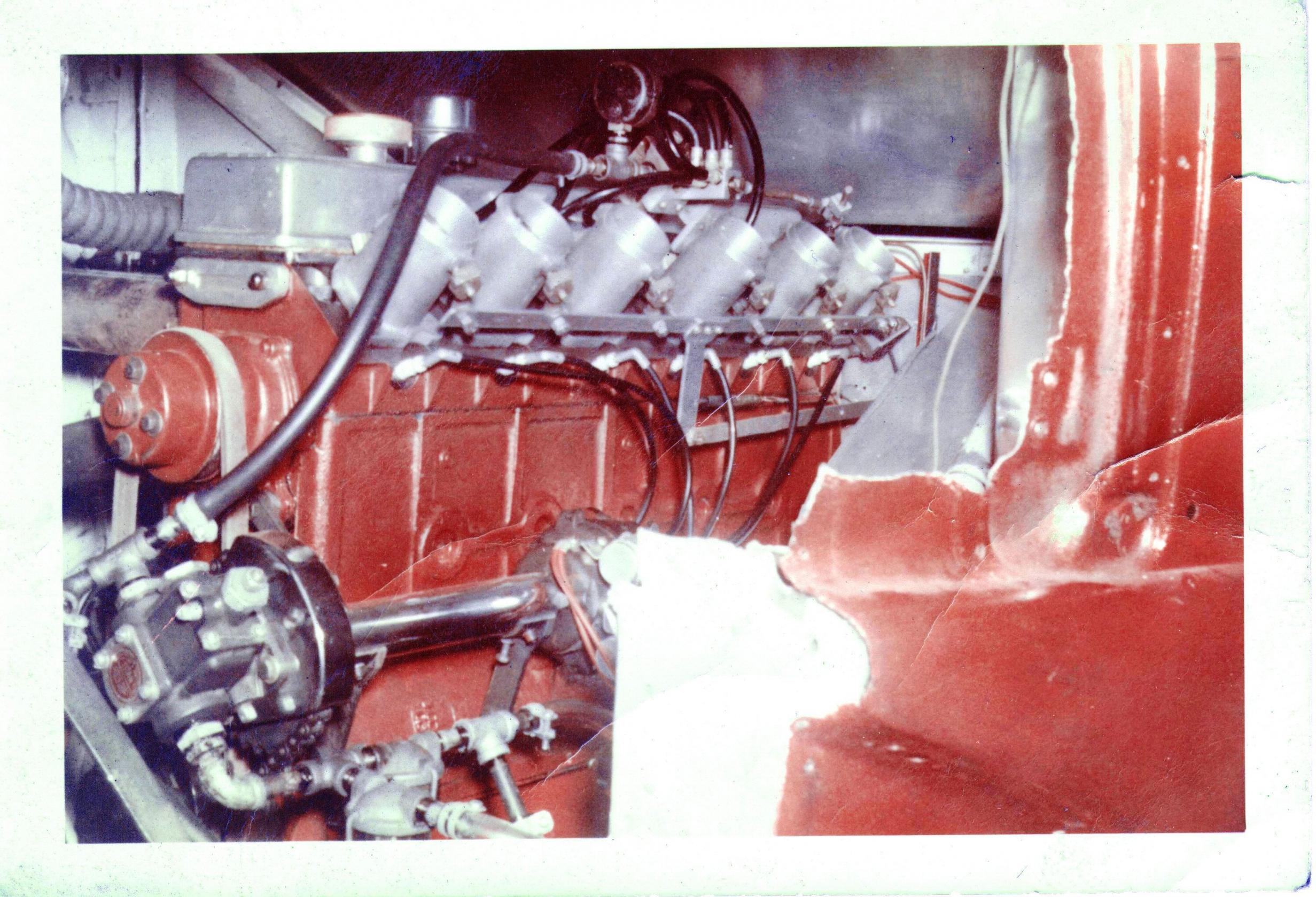

    What about induction - I know where there is a 3 carb McGurk intake to suit a jimmy ;)

    I have a 2 pot McGurk for the small port 270 but my 302 is a large port and I very much want the 3 carb McGurk for it. Please pm me if it is for sale resonable.

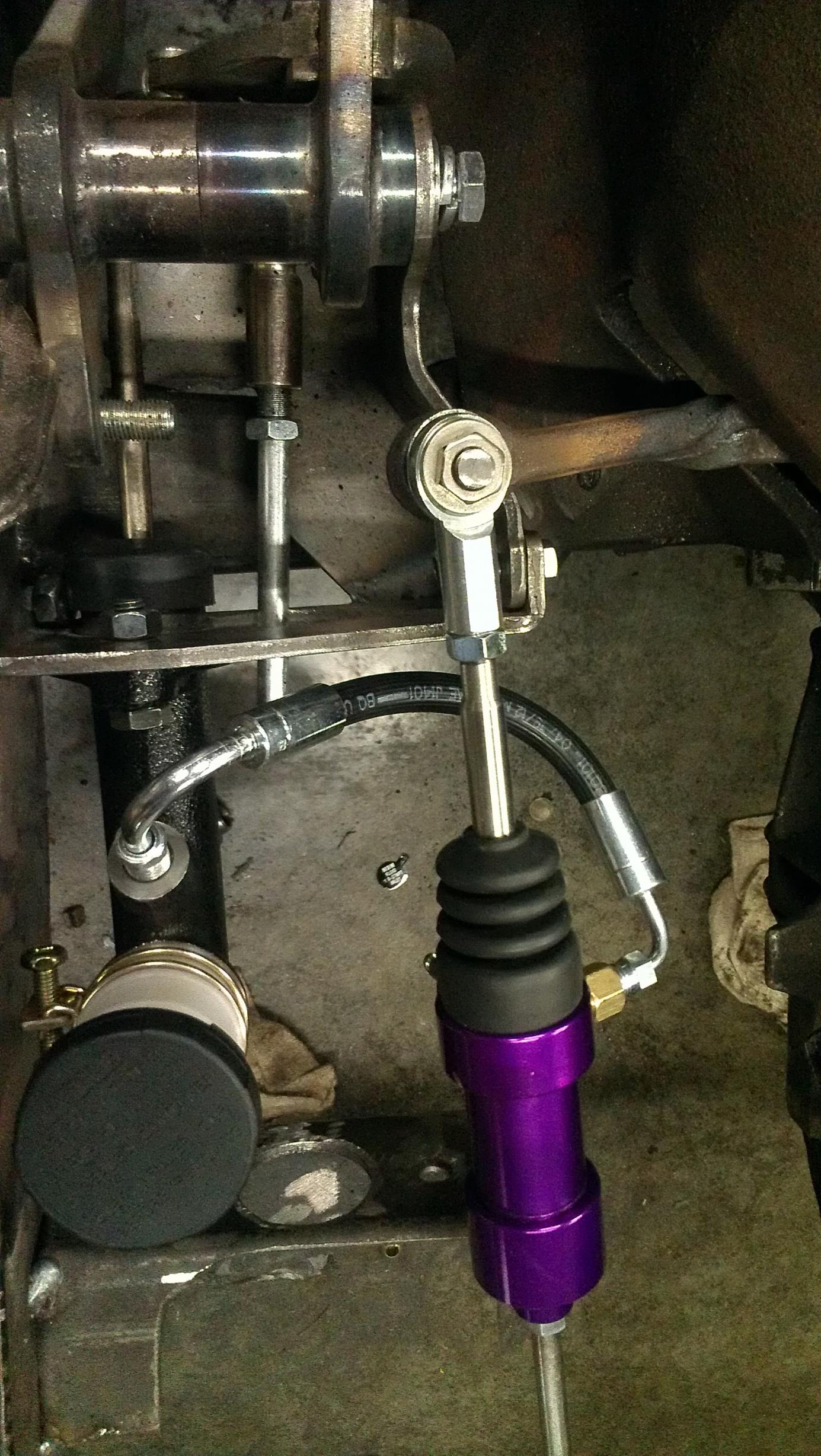

    Got all my brake lines run and my hydraulic hose made up for the clutch master to slave. Bled the clutch and it works great so I feel good about that.

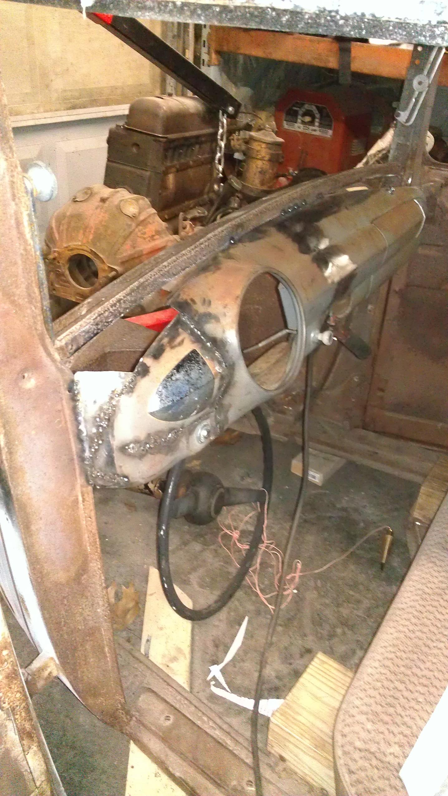

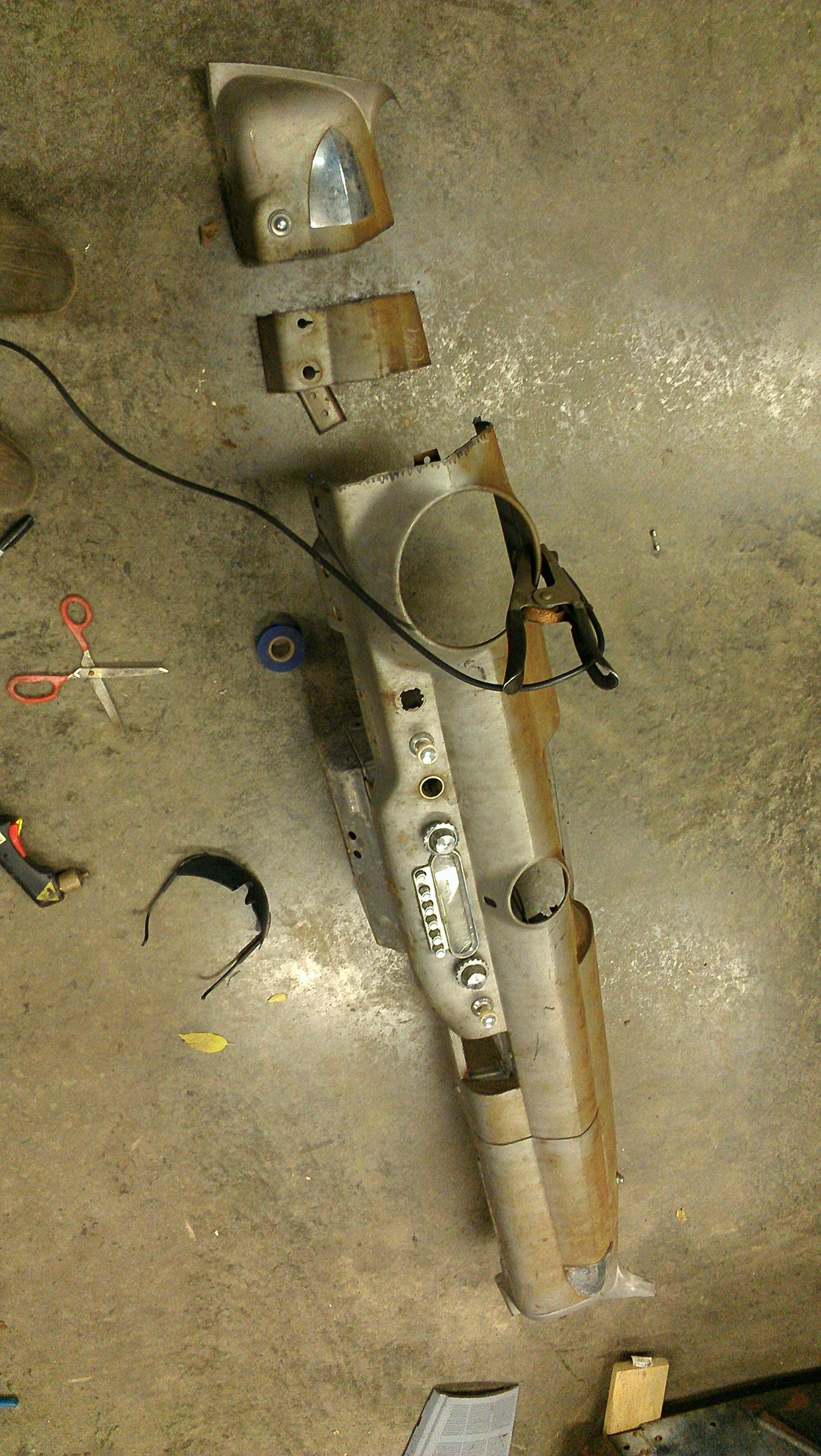

    more progress. Got my dashboard, time to cut it up. I think I took 3 inches off of the left side to center the guage and then 14 out of the center.
    tb33anda3rd and kidcampbell71 like this.

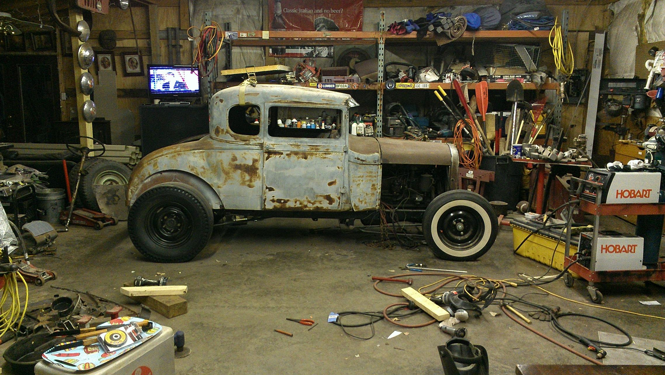

    all smoothed up. Also got the body back on the chassis after all the suspension work. How she sits now.

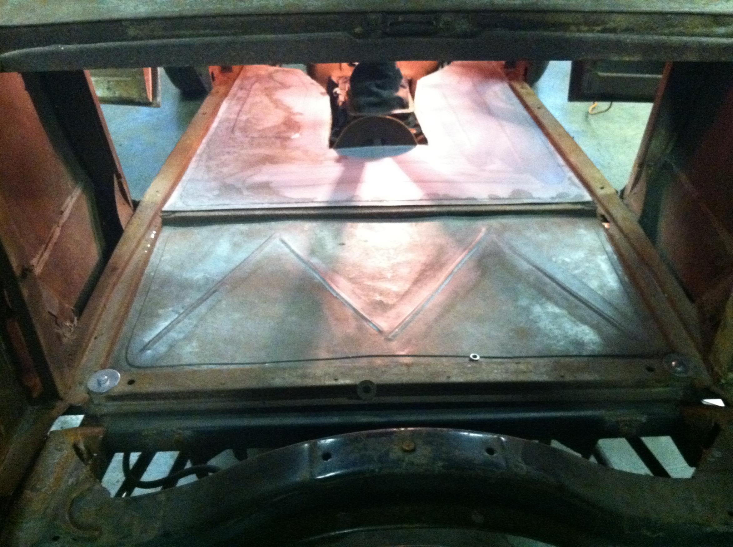

    I took a bit of a hiatus on the coupe, but I'm back on it again. Bought a bead roller and modified it so I could finally get started on the floors. It is really tough to fit 3 pedals in this thing with the inline 6 recessed so far into the body. Anyway, here is the progress.

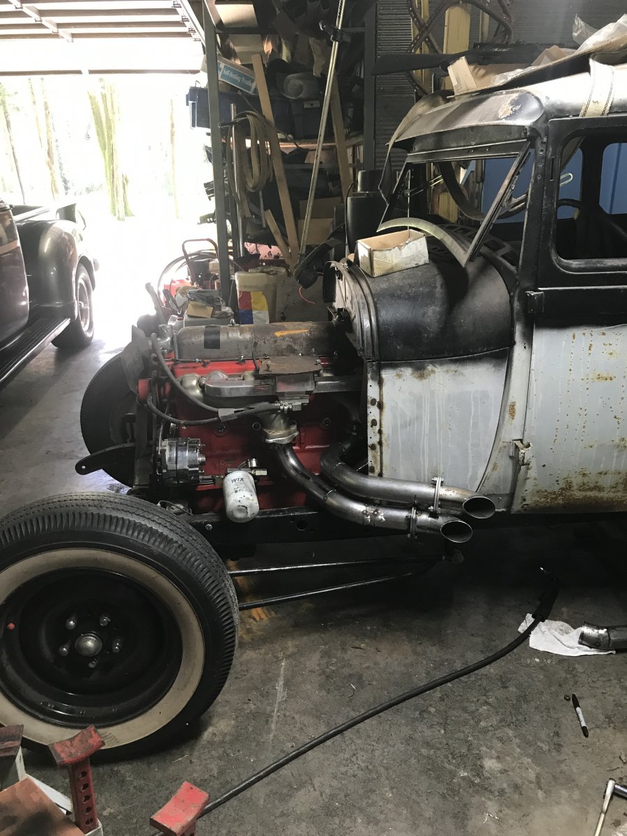

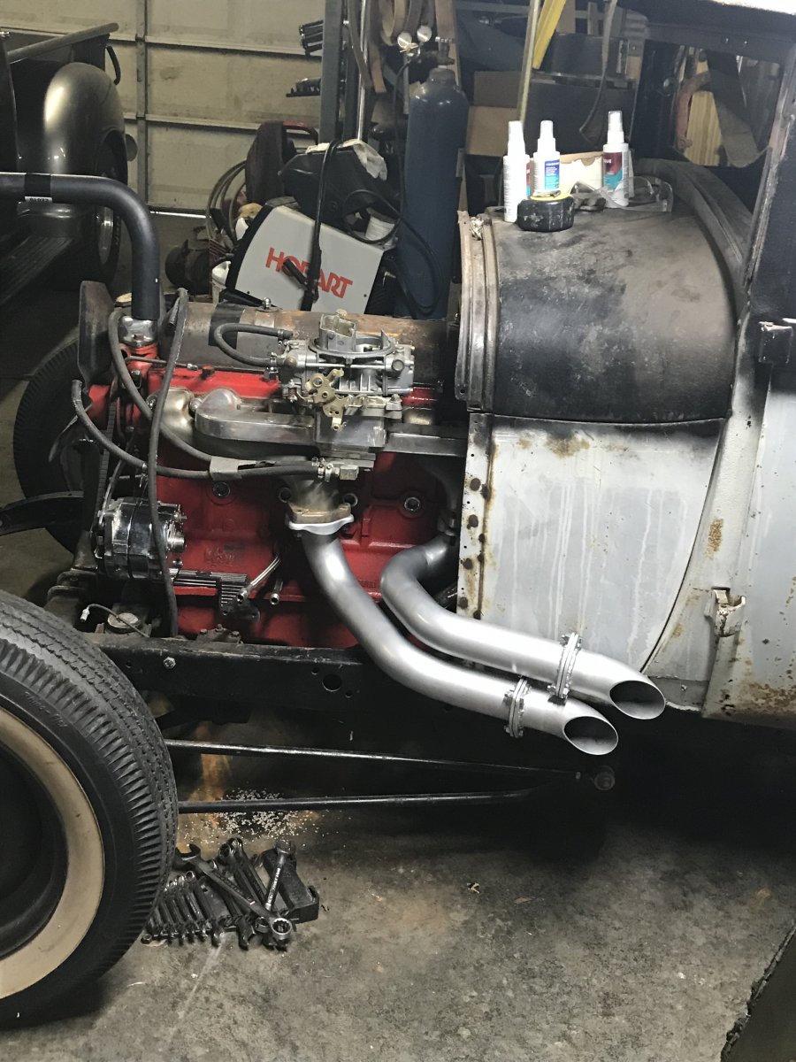

    Digging up my old a model jimmy thread since I did some work to it the last couple weeks. Maybe I’ll stay motivated for a little while. Anyway, here is some exhaust I made for it off my Nicson headers on my built 302 sitting in it now. Also working on the oil filter mount and then mounting the radiator.

    Nice to see you back on the project again.
    love the headers

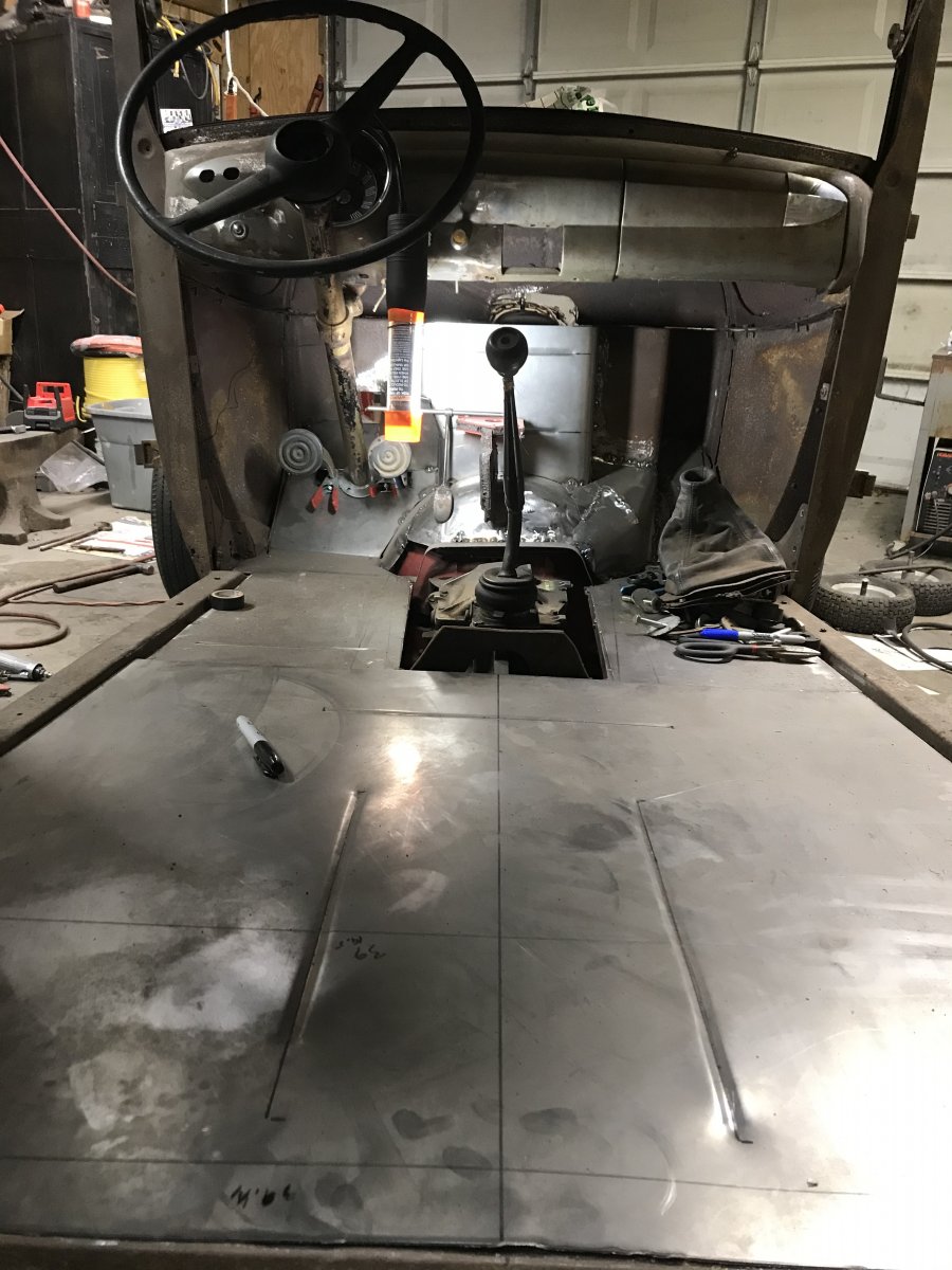

  30. flying53gmc
    Joined: Mar 2, 2005
    Posts: 415
    flying53gmc
    from M-boro, TN

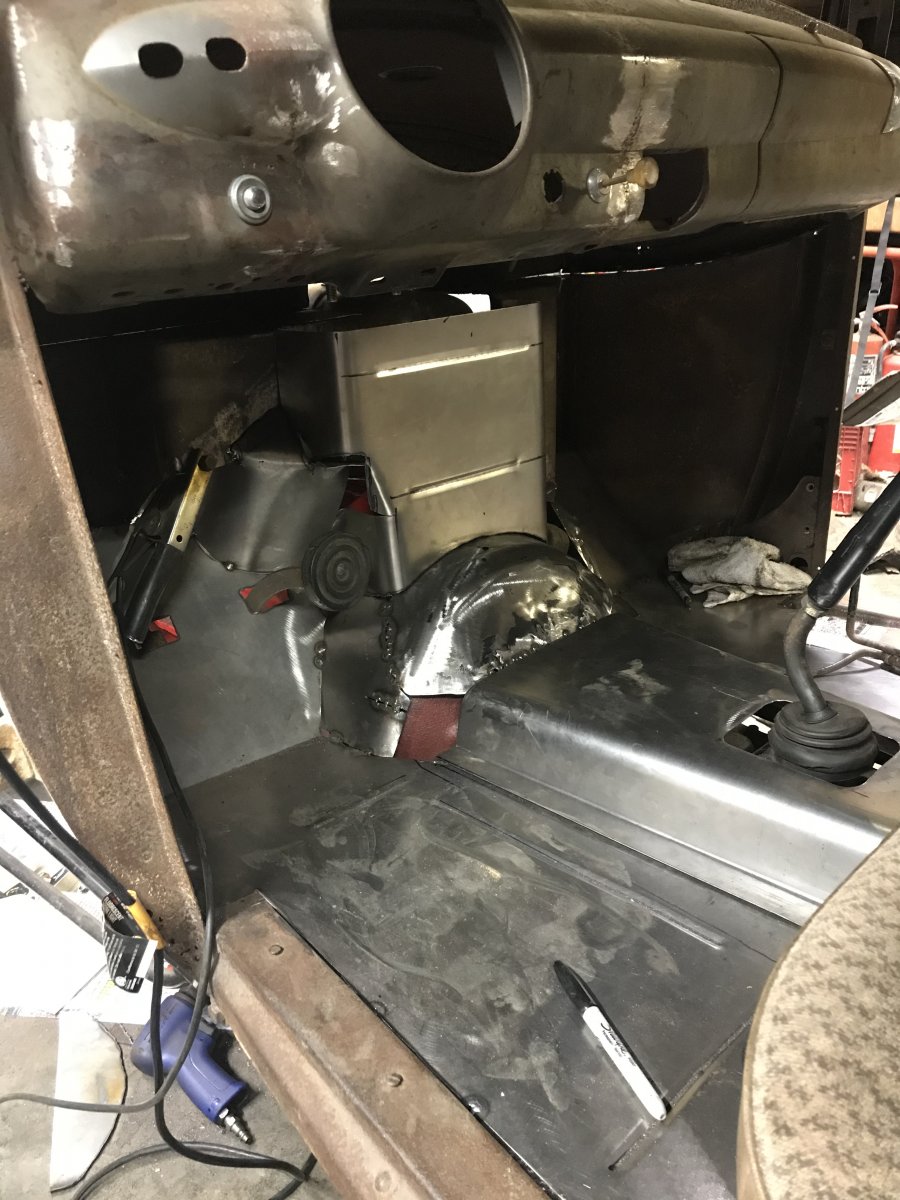

    I’ve been working here and there on the old girl again. Was unhappy with the work I did on floors and firewall so I tore them out and started over. In progress still but I think I’m heading down a better path.
