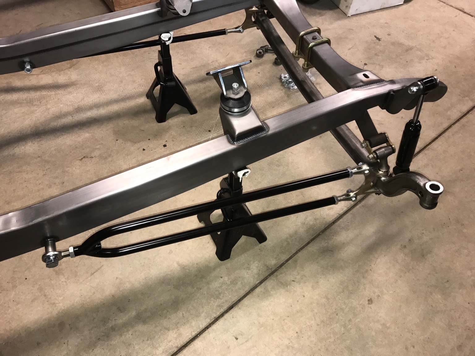

    This Hot Rod just got a hell of a lot cooler. Boling Brothers rocks. [emoji482]
    -Brent-, Tall t 26, GASSERBOB and 2 others like this.

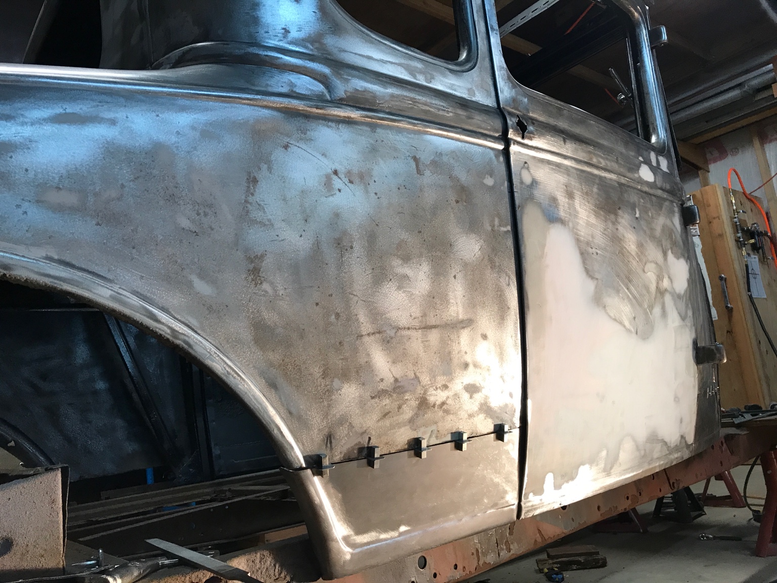

    How much chop ? You might want to consider lower cut lines as there will be less distortion near the curve of the window opening. Also consider making your back cuts in a lower area then bring it up to the back window. There won’t need pie cuts in the top. Just trying to help, looks great so far.[​IMG][​IMG][​IMG][​IMG]

    I just saw that you have to pie cut it if it is a straight cut. Kinda was messing around with how I’m going to do it. Thanks for the pics, huge help I think I’m going to go your route. [emoji1360]
