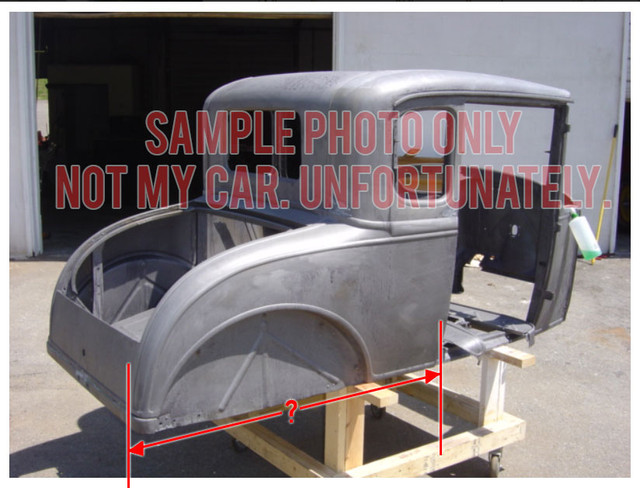

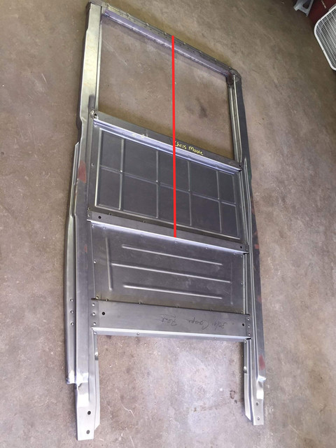

    Howdy - I'm attempting to reconstruct the rear half of my 30 Coupe and have hit some snags regarding measurements for sub floor and rear quarters. As mine are long-gone-rusty-dust, I'm hoping you guys to help me a bit with a few measurements. I've gotten a couple measurements from some generous folks on Facebook but they were off from each other by an inch or more, and looking at my own coupe I'm struggling to make ends meet. Literally.
    How long is a solid healthy quarter panel supposed to be from the B-pillar to the rear most corner?
    Curious about your measurement on this too (also, not my subfloor, just a sample pic). I've got two differing measurements so far and it's hard to determine which is correct without knowing how long my quarter panel is supposed to be:
    What I'm currently working with (and without):

    Gigantor

    I'd be interested to know what you find for the B-pillar dimension. I just measured my 30 coupe body and the driver side is 49 3/4" and the p*** side is 50 1/2". I know someone boogered the back corner together on my p***enger side which will have to be redone.

    my measurement was from b pillar to the back edge of the heavy cross rail... 52"...

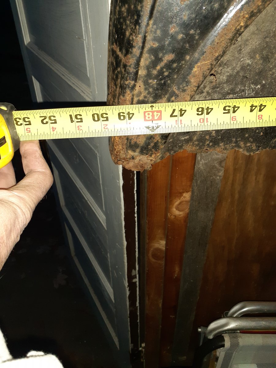

  14. wheeldog57
    Joined: Dec 6, 2013
    Posts: 3,986
    wheeldog57
    And the front of second subrail x member back to rear 51 3/4
    Hope this helps
