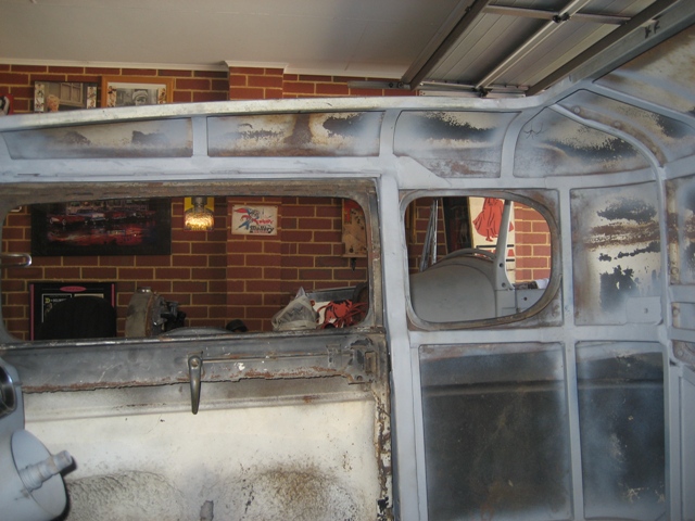

    Ok, here are the pics i promised a week ago. I have taken all the old wood out and cut rust out awhile ago. All the floor, roof, firewall and the back off the car have been steeled out. This week i finished off the floor, its all spot welded down all the area behind my seat is also done. I have made the trans cover its fitted. The bench seat took some thinking as i wanted to keep a bench with out a cut out. It doesn't slide or tilt..theres nowhere to go, pushin for room as i is. Body is channeled 4" I'm not a short guy but fit in there comfortably, as the seat is on a slight angle. I have a few more fabrication jobs left before i can pull the car down for paint. Of to VLV in 8 weeks, so want to be down by then. Come home and pull the car down. My goal is to have it on the road by june.

    Hey looks great! Congrats love the stance.

    Great job on the steal out.

  9. Looks good real nice body you started with are junk yards aint what they use to be

    Yeah body was pretty good, they did a nice chop. I cut the usual rust rust out. I dont know about some of these replacement parts you can buy, they just dont fit! I had to pie cut some of the swage lines bend add metal. Nothing a bit of filler wont hide.
