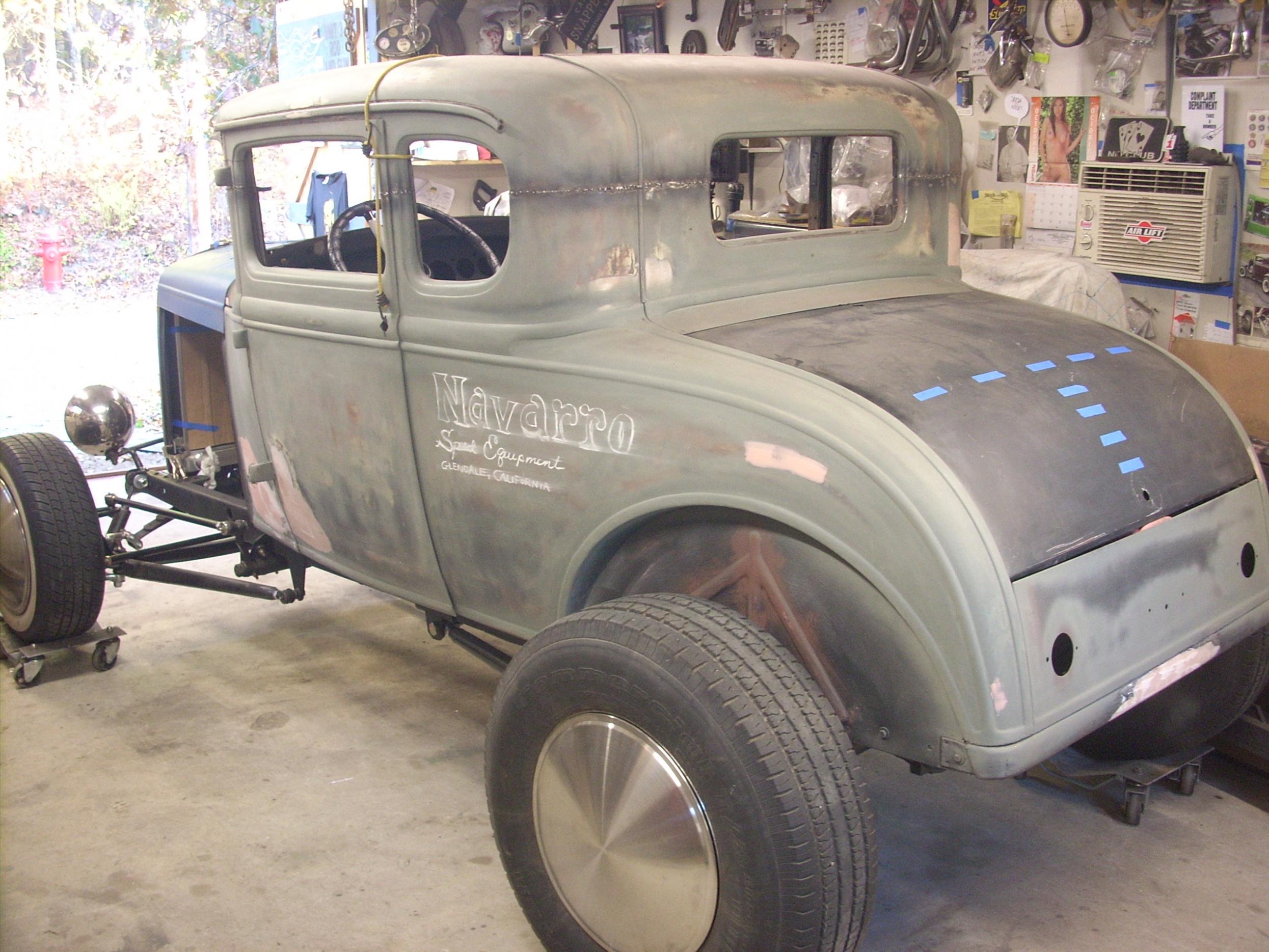

  4. wex65
    Joined: Dec 19, 2012
    Posts: 1,144
    wex65
    from WV
    Glad to see the thread is useful, I will add a stock height A later today.
    I myself am trying to decide on a chop for my newly acquired A, hence my wanting to put together an easy visual guide. I fully appreciate the fact that other factors (frame, channeled, wheel size/stance) will impact the look but this at least gives a good reference.

    2" with a 4" channel and only 1" out of the back window

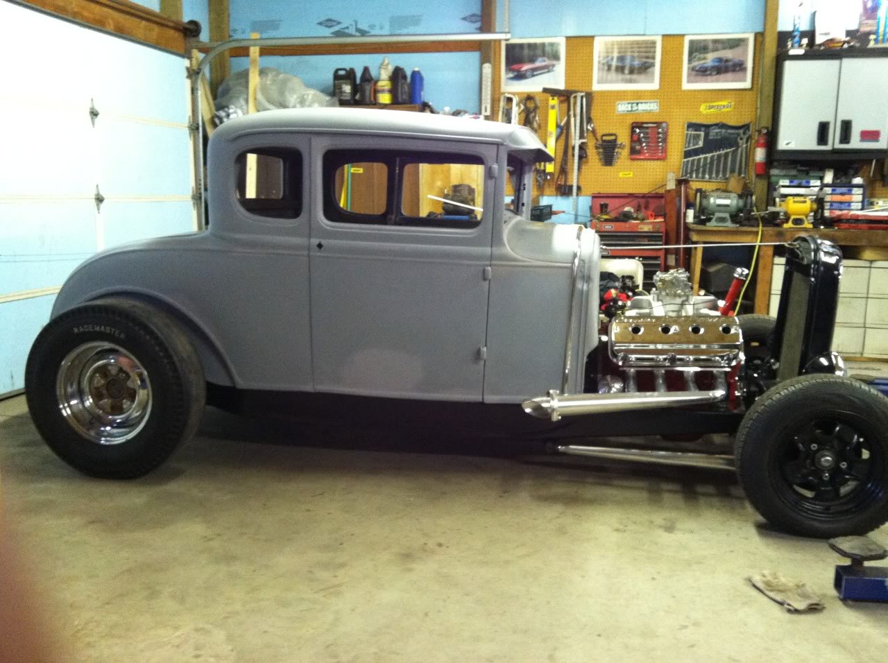

    this is unchopped on a model a frame. no channel.

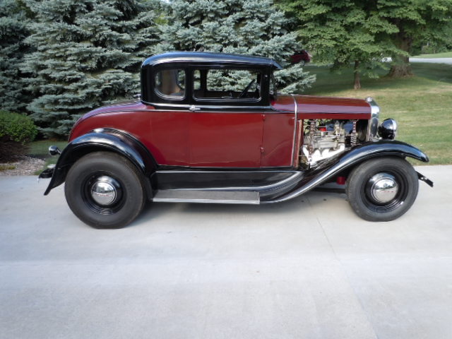

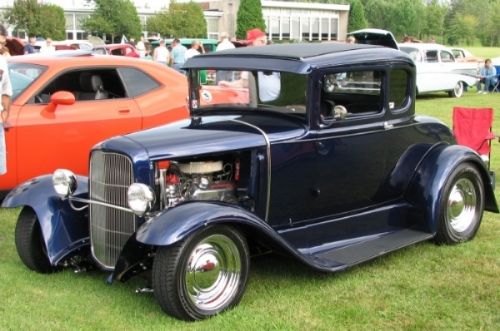

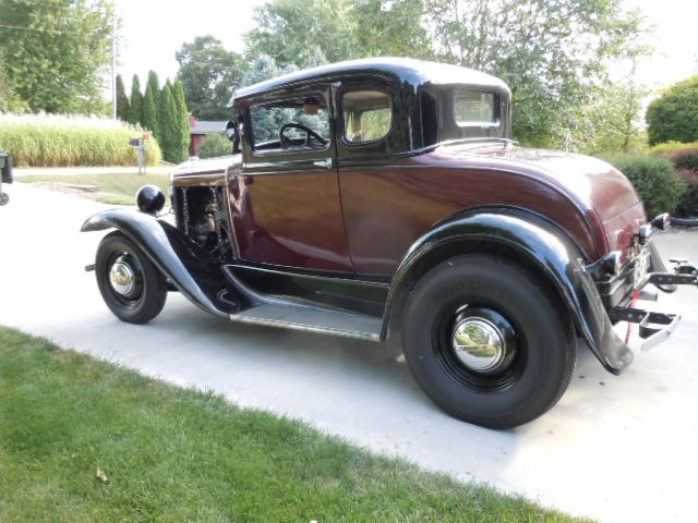

    I've built a few A coupes. Here's some to add to the thread.
    Consider getting rid of the package tray if you chop more than 3 inches and cross brace the body under the rear window. Then move the seat back to your personal preference. Also, leaning the seat back a few degrees helps vision somewhat.
    In my opinion, you can't chop an A coupe too much. The more it's chopped the more at***ude it has. They're small. If you can't fit in it...don't build one.
    2 inch
    3 inch
    4 inch

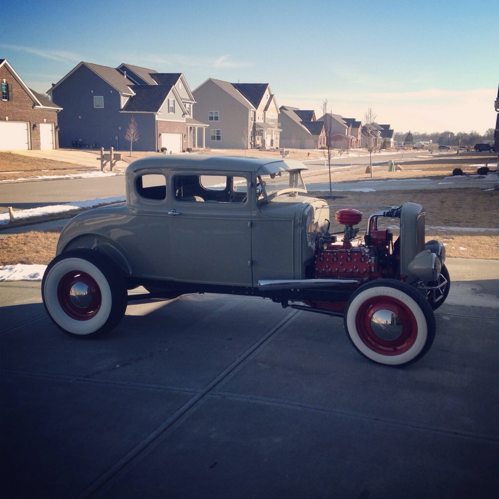

    My '31...with a 3 1/2" chop.
    Dannerr and slimcat7m3 like this.

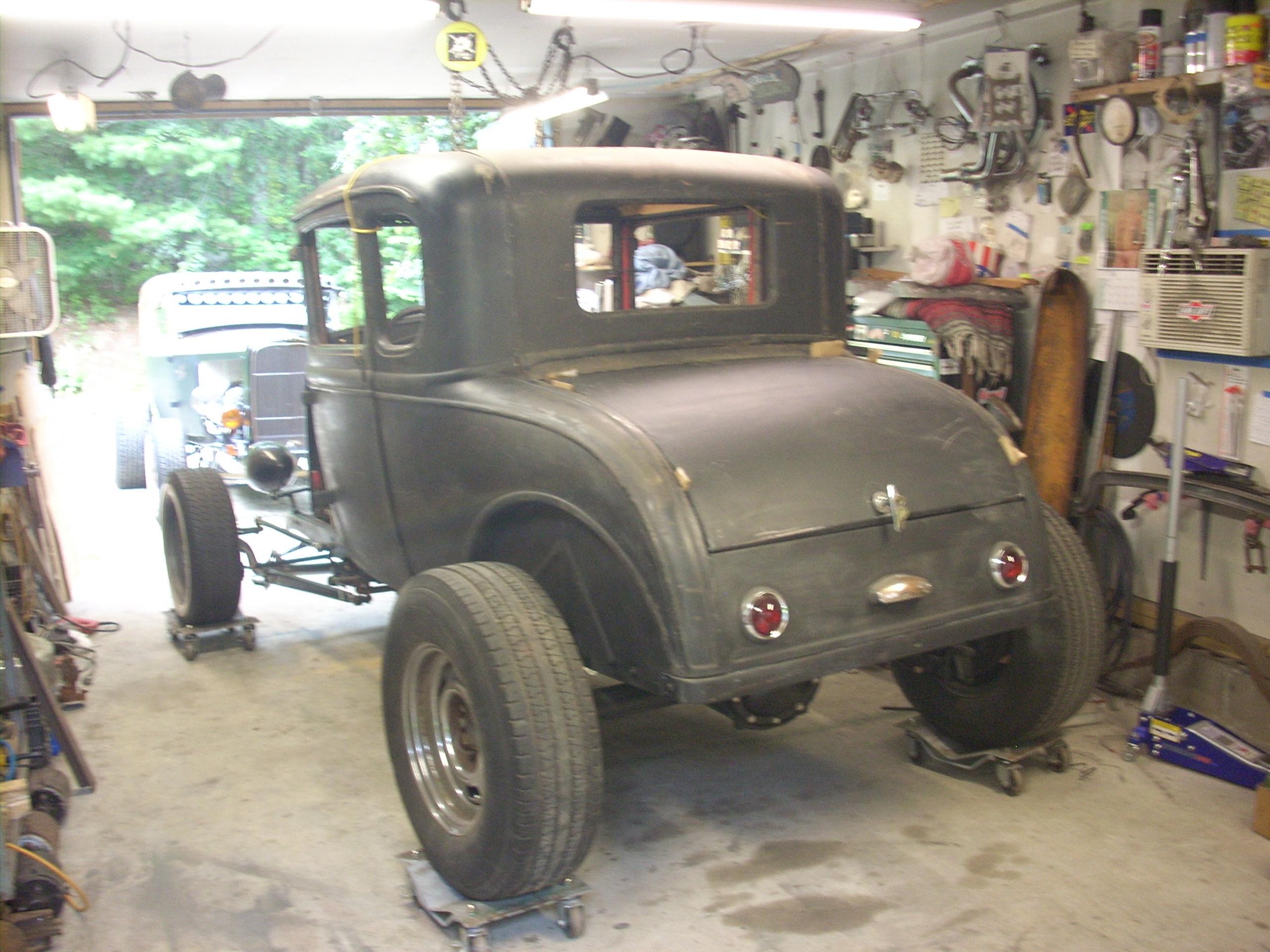

    Current project ; before and after. 3" boys regular ( I'm a scaredy cat but I like the proportions) Excellent thread, thanks. Mike from M***. Pictures kinda ****-small garage.
