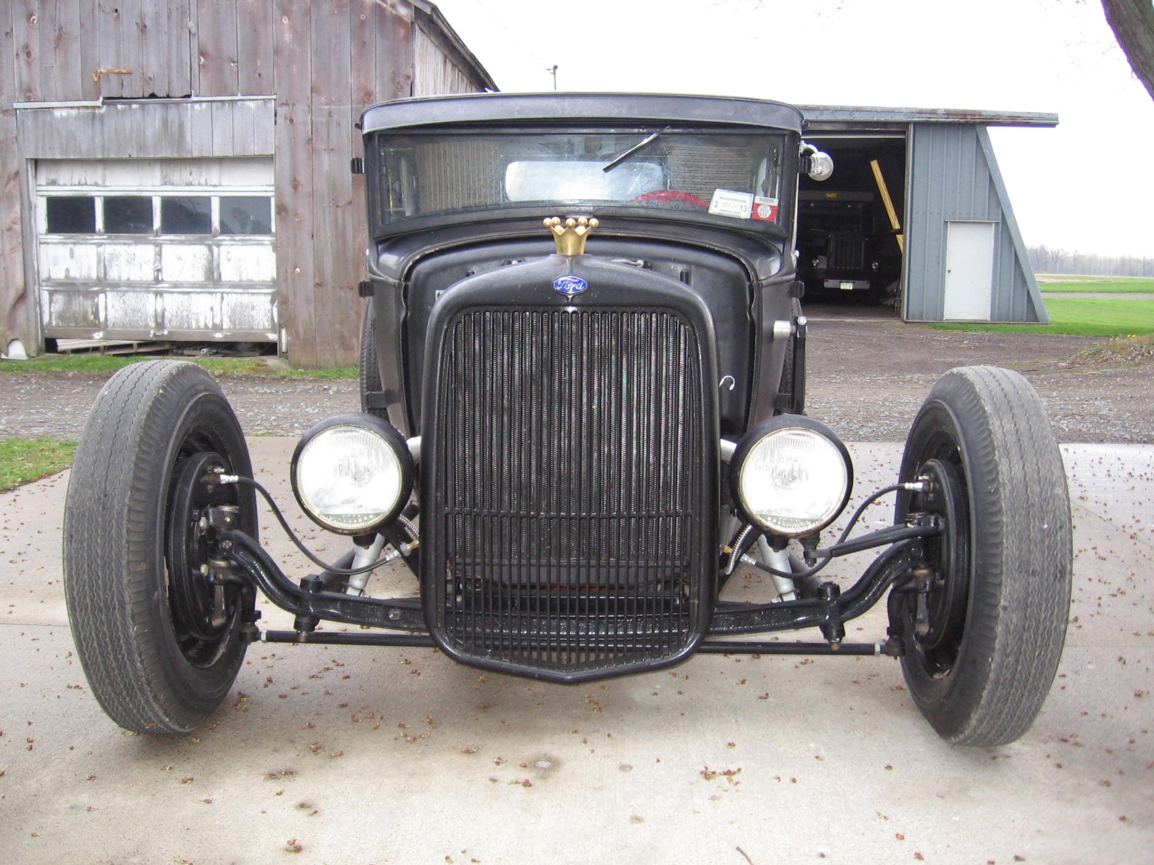

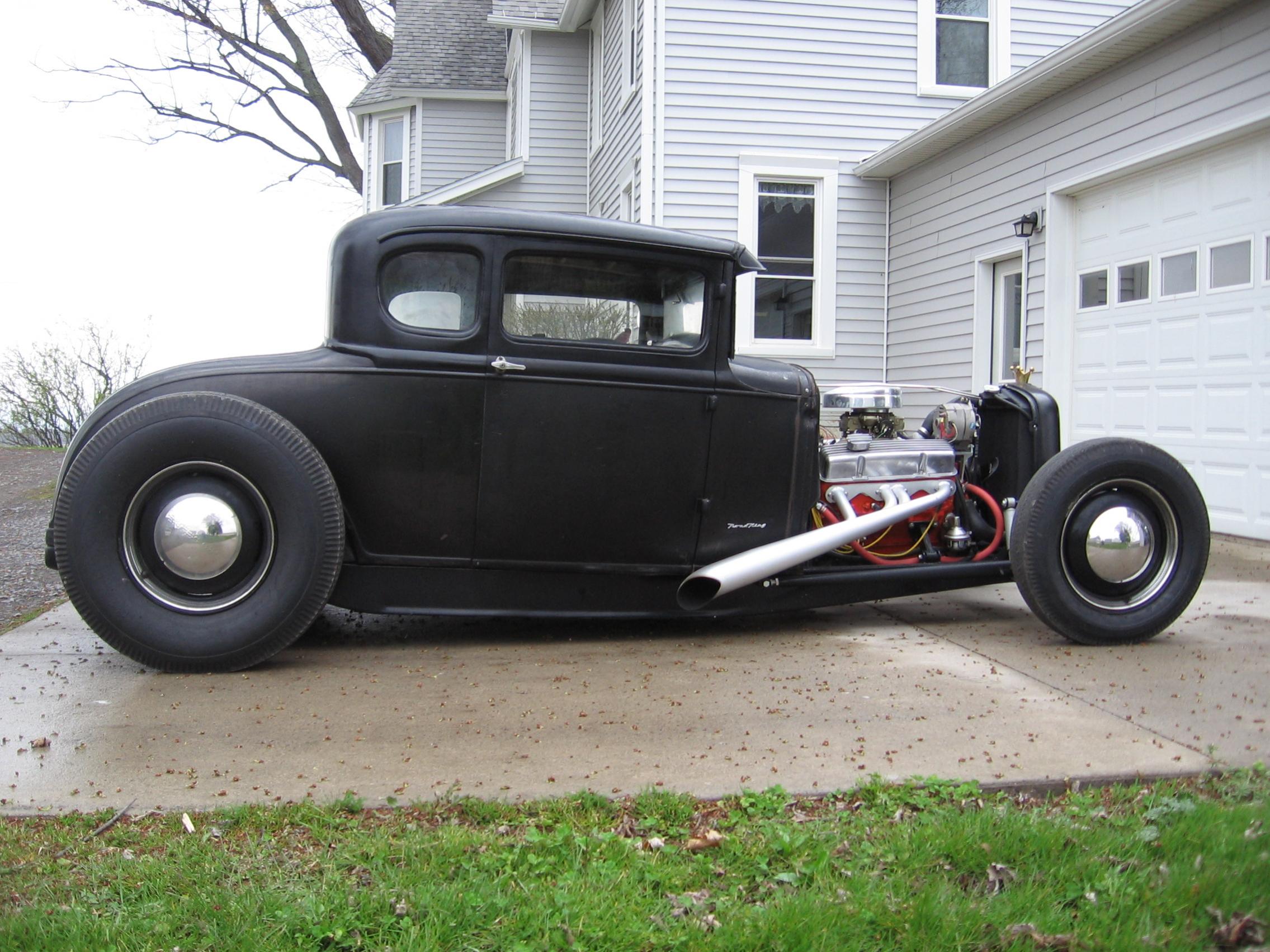

    4'' chop with no channel, 32 rails. I'm 6' and still have to hunt for the light through the traffic light finder if I role to close. I can see it fine on the Harley. Still like the HOT ROD! This car still has a pretty roomy trunk to.

    Tell us about the suspension on this one.
  16. 3030
    Joined: Dec 21, 2010
    Posts: 206
    3030
    The car has torsion bars front and rear. Rear bars run across rear frame, the front run in the frame rails with arms riding in the notch of the wishbones.

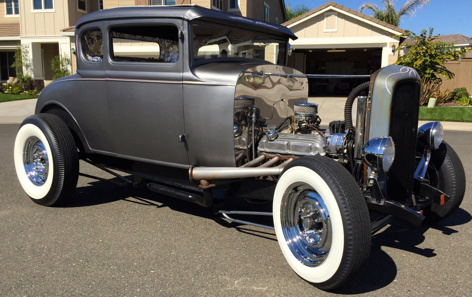

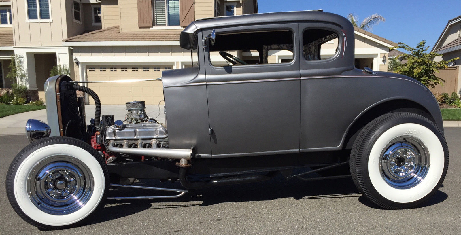

    I was told by the seller that this was a 3.5 chop...after seeing all these great pics I think I have a 4-4.5 chop...is there a window measurement to tell the amount that was removed $_57 (1).JPG $_57 (4).JPG
  21. Hot roders are usually pretty smart, however our forefathers decided that defining what is left by stating what has been thrown away was a great idea.
    Sometimes all you need to know is that it looks good. Sometimes you need to know how much was taken away. Most of the time you'd like to know what's left, but its never ever stated that way. Not once have I seen the perfect proportions stated as such.
    So if you need to know how much its been chopped, you first need to know what the stock measurements are supposed to be, then measure yours, then do math problems.

    Hey Mark,
    Let me know where ya want the measurements taken and I'll measure my 30 and let ya know what I have (still unchopped)

    Thanks...but I think my white coupe is not chopped..I can always measure it, although it looked like it had a slight chop to it when I bought it...just for ****s n giggles go ahead and post your side drivers window since your sure your s isnt chopped..then I can measure both the coupes :)

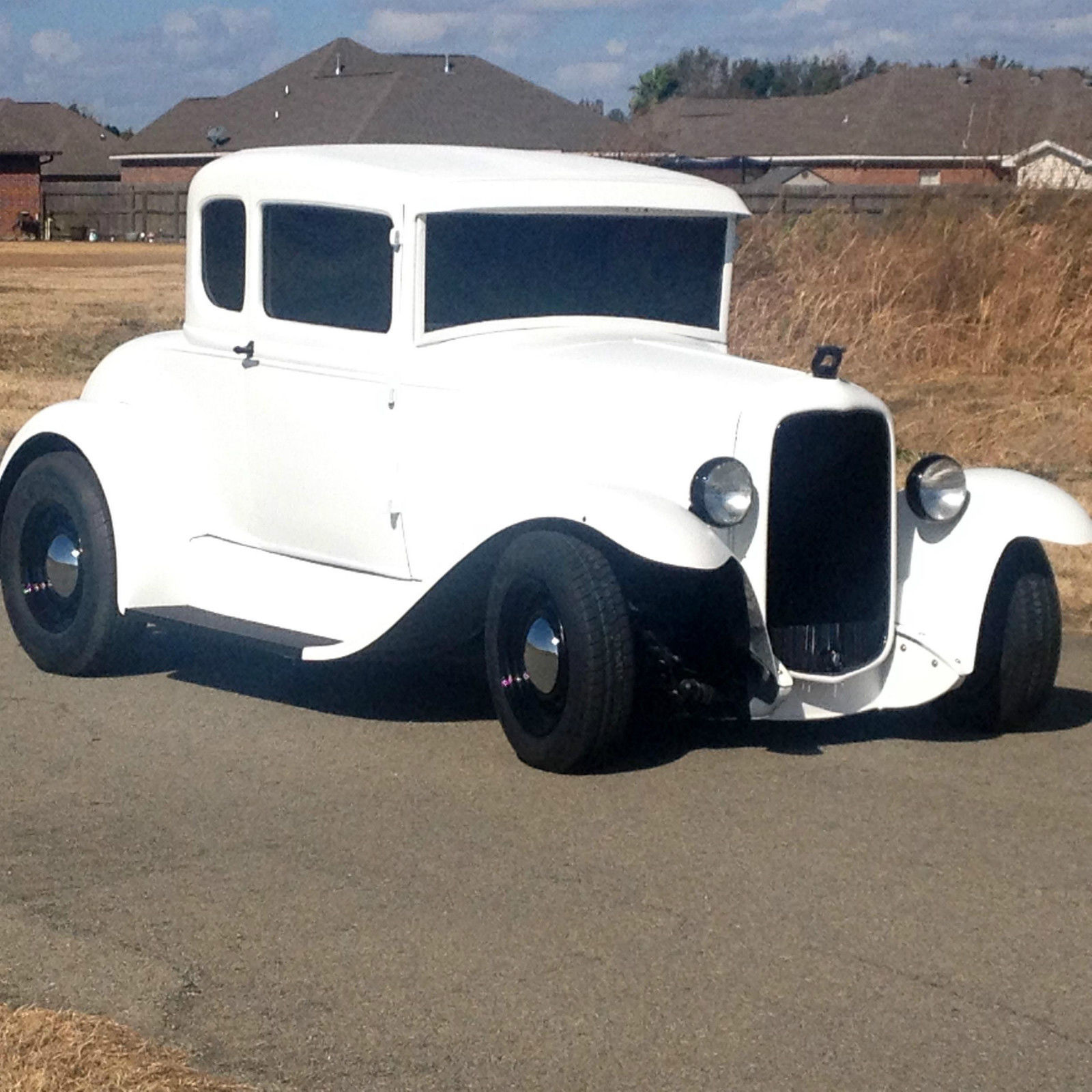

    $_57 (17).JPG heres the white coupe how it looked when I bought it..I dont think its chopped...must be the limo look that gives it that appearance

    <----30 coupe.
    OK, my measurements (height) are all taken @ center of window frame,
    front windshield gl*** height inside the windshield frame 11 1/2"
    Driverside door window opening 13 11/16"
    rear window opening 10 1/4"
    -Pat

    Pat...my white coupe has no chop, same measure ments as yours, my grey one is 4.5" - 5" depending on where I measure. Thanks again for posting those measurements.There was another guy earlier in the thread asking for the same measurements, but without a response, so maybe he will see this post and get his answers:)
