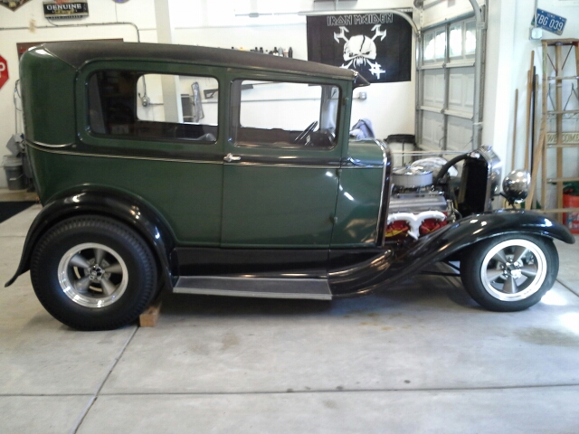

    I have two Model A's, that are hot rods. Both of them use the stock tank.
