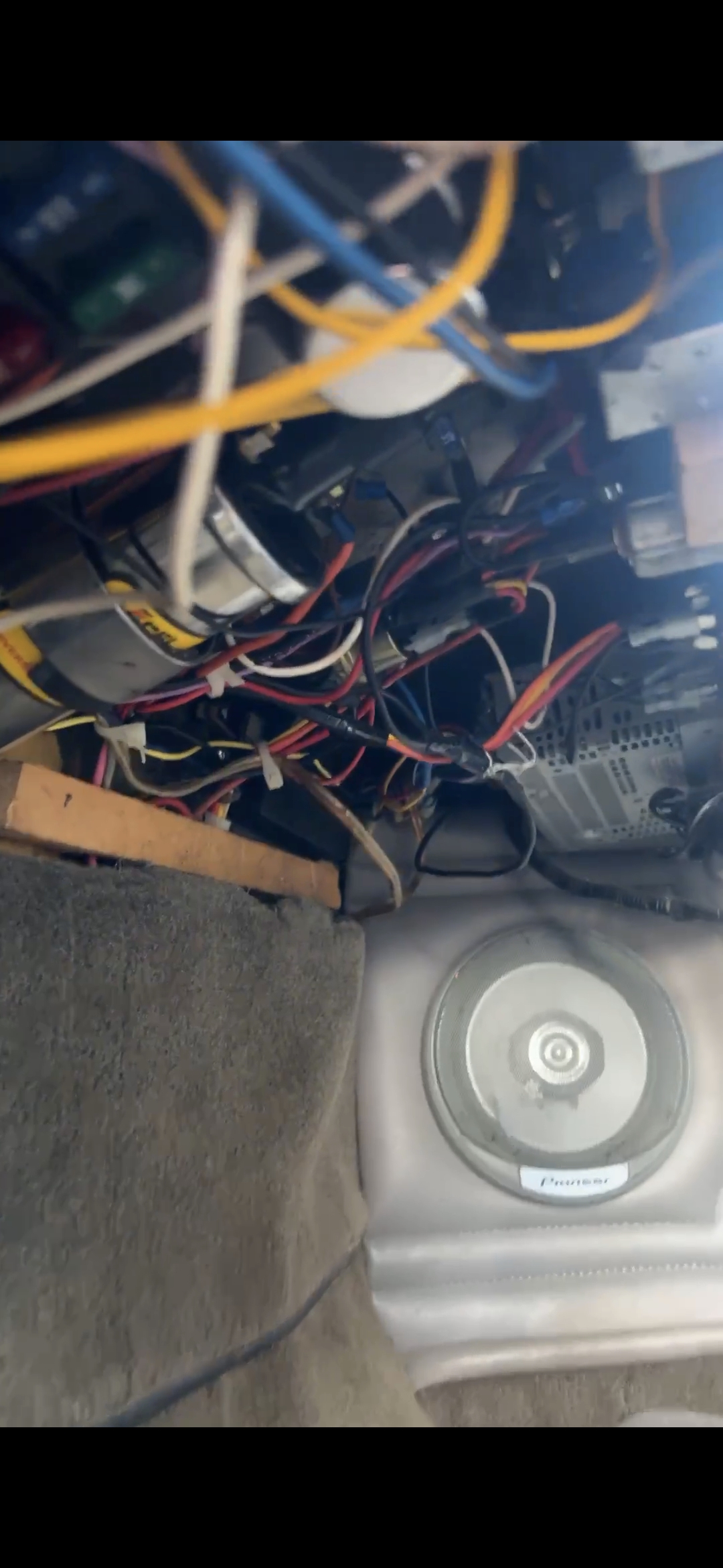

  14. Puka
    Joined: Dec 29, 2011
    Posts: 57
    Puka
    from Arkansas
    He just sent me a video. Here's a few screen shots. I'm not liking what I see. And as for as trade, it's ***le for ***le on a nice 68 C10 I own.
  15. Puka
    Posts: 57
    Puka
    from Arkansas
    The owner is claiming that the fuel tank is still there... Im not seeing it, plus there wouldn't be room for all of the visible clutter, correct?
    The issue is that we're eight hours feom each other. So I'd need to look it over really well first, and I'm not into wasting anyone's time.
  16. Photo of the car does show a original gas cap. Does,nt mean much on this car though. Thats a lot of stuff to hide behind a original dash. Actually if the original tank was gutted all that stuff would be up higher in the gutted tank. I enlarged one pic, do i see the flange for a original speedo cable tunnel which could be the lower original tank. Someone else here might see different. The plot thickens. Twilight zone.
    Puka likes this.

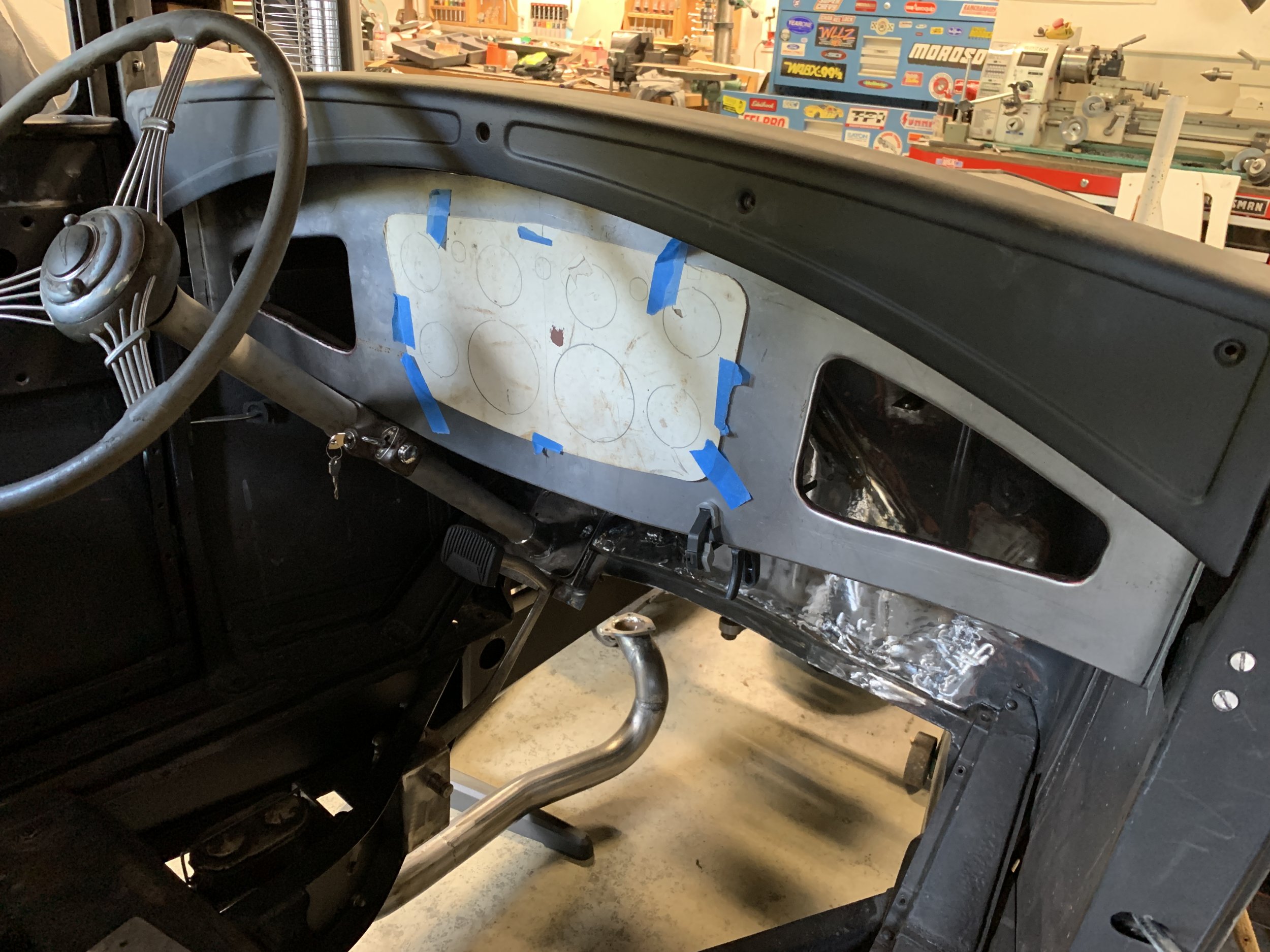

  19. 31Apickup
    Joined: Nov 8, 2005
    Posts: 3,656
    31Apickup
    Ideally you’d want the new dash set back like the original that way you can take advantage of the way the airflow is routed when the windshield is open. There are holes that direct air towards the floor. You can find the upper dash the screws to the upper rail fairly easily. I’m building my own dash for my coupe. IMG_4008.jpeg
    Bugguts and Puka like this.
