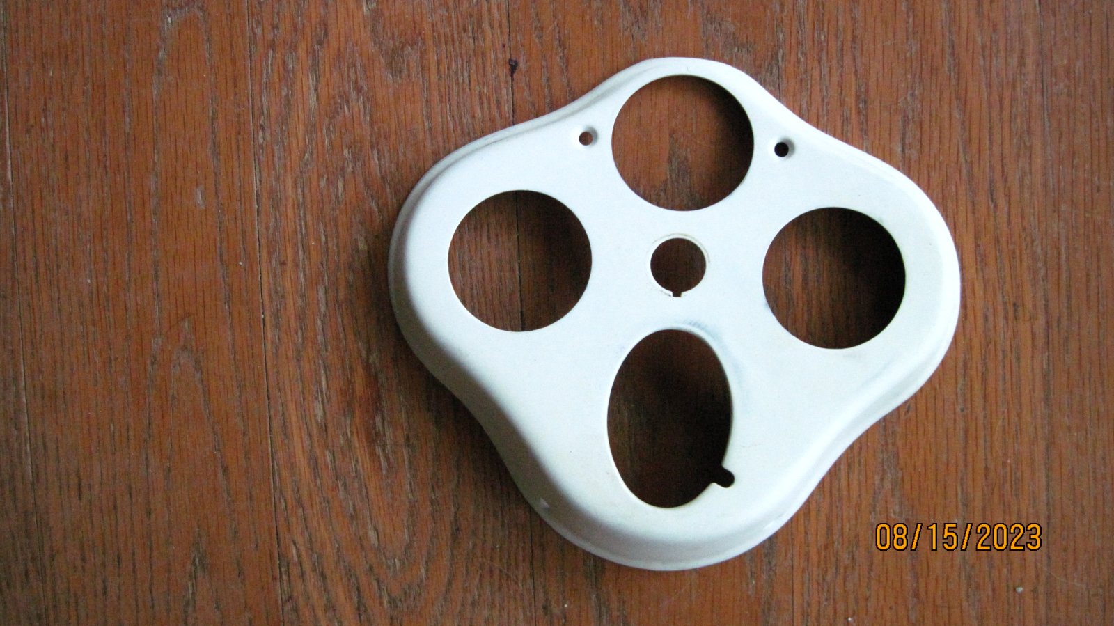

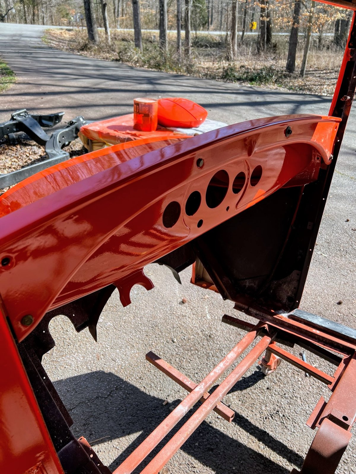

  2. The Aristocrat dash adds two more holes for gauges. Those responding to this thread will show you some examples, I'm sure. There is an issue you need to know about, though. Modern gauges are 2-1/16" outside diameter, which is larger than Model A holes for ammeter and fuel tank.
    If you aren't keeping the stock fuel tank, it is common to open up the holes for the fuel gauge, ammeter and where the stock ignition switch is on the left side of the dash. Seems like us hotrodders always want just one more gauge, or two, or . . . I moved the fuel tank on my '29AA and opened up holes in the stock dash for fuel, voltmeter and oil pressure, then fabricated an overhead console across the inside of the header where I've put the water temperature, transmission temperature and tachometer gauges. Haven't gotten it on the road yet but I think it will put the right gauges where I can see them at a glance. IMG_2286.JPG IMG_2285.JPG

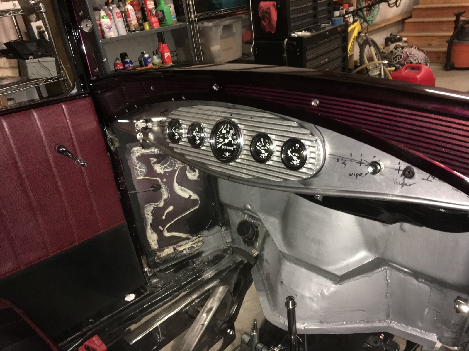

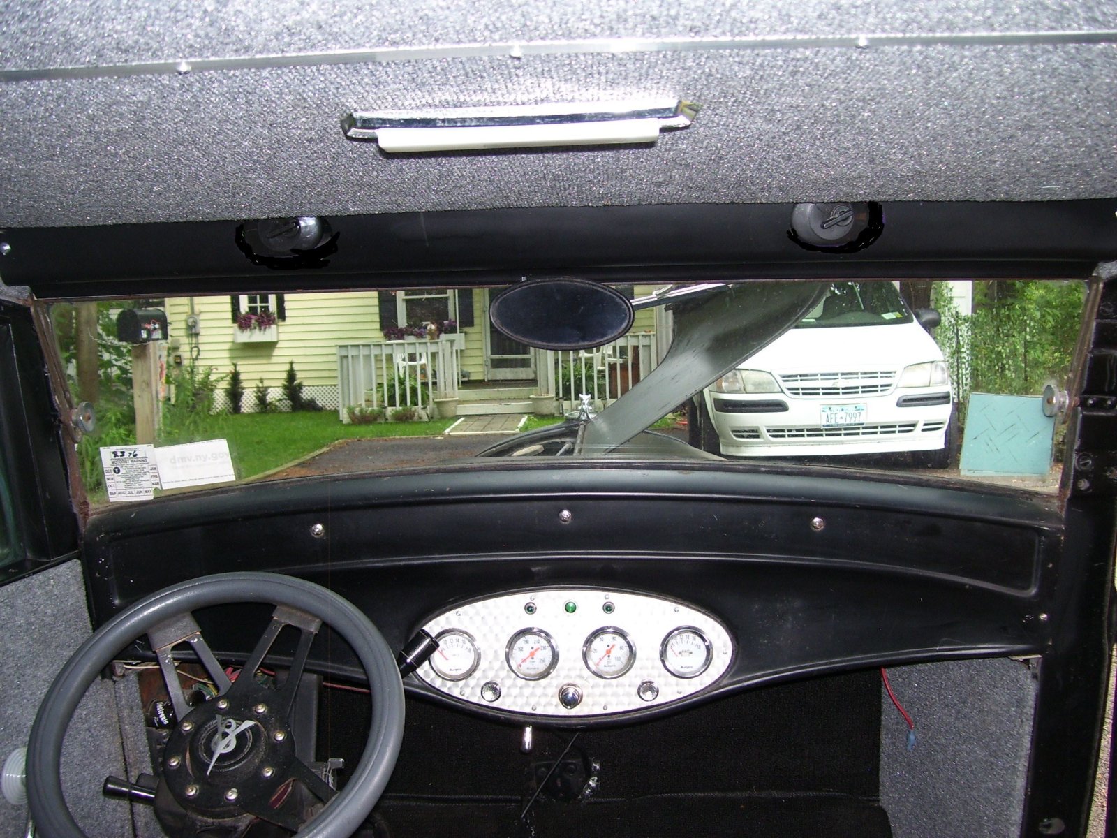

    I did a common method and cut the tank from the cowl, used a ‘32 dash made to Model A width,(from Brookville), and covered the upper edge with the stock A surround. It looks nice, enabled me to add AC and heat, and a 5- or 6-gauge panel easily fits in the middle. Pretty simple, but effective.

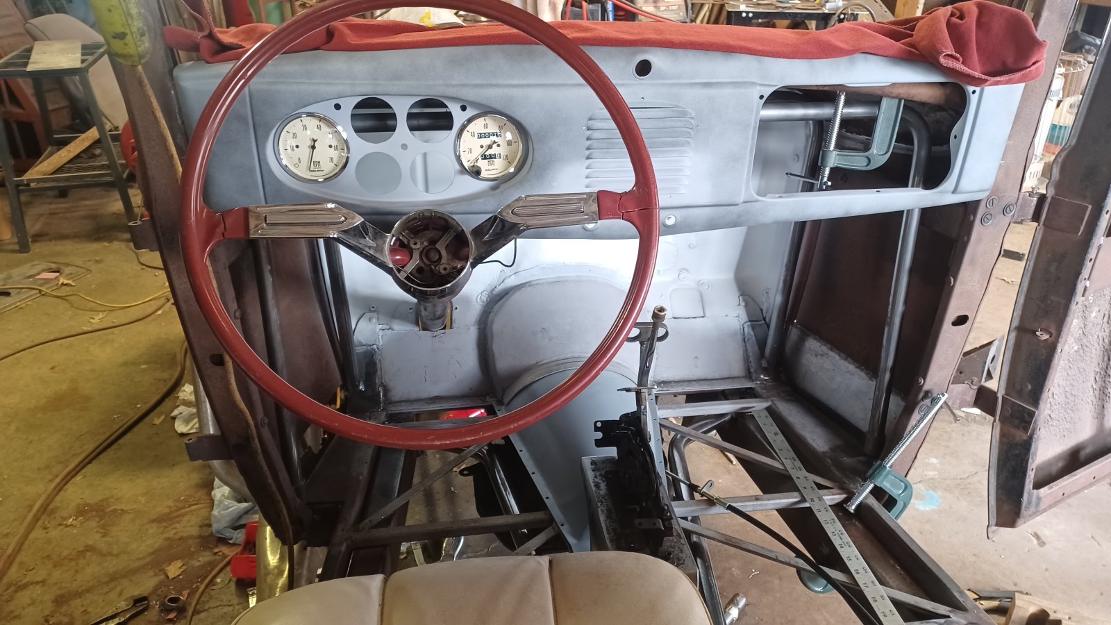

    I used the 32 dash for an A as well in my 31 roadster. I had to do some modification to use this gauge panel but it works well.

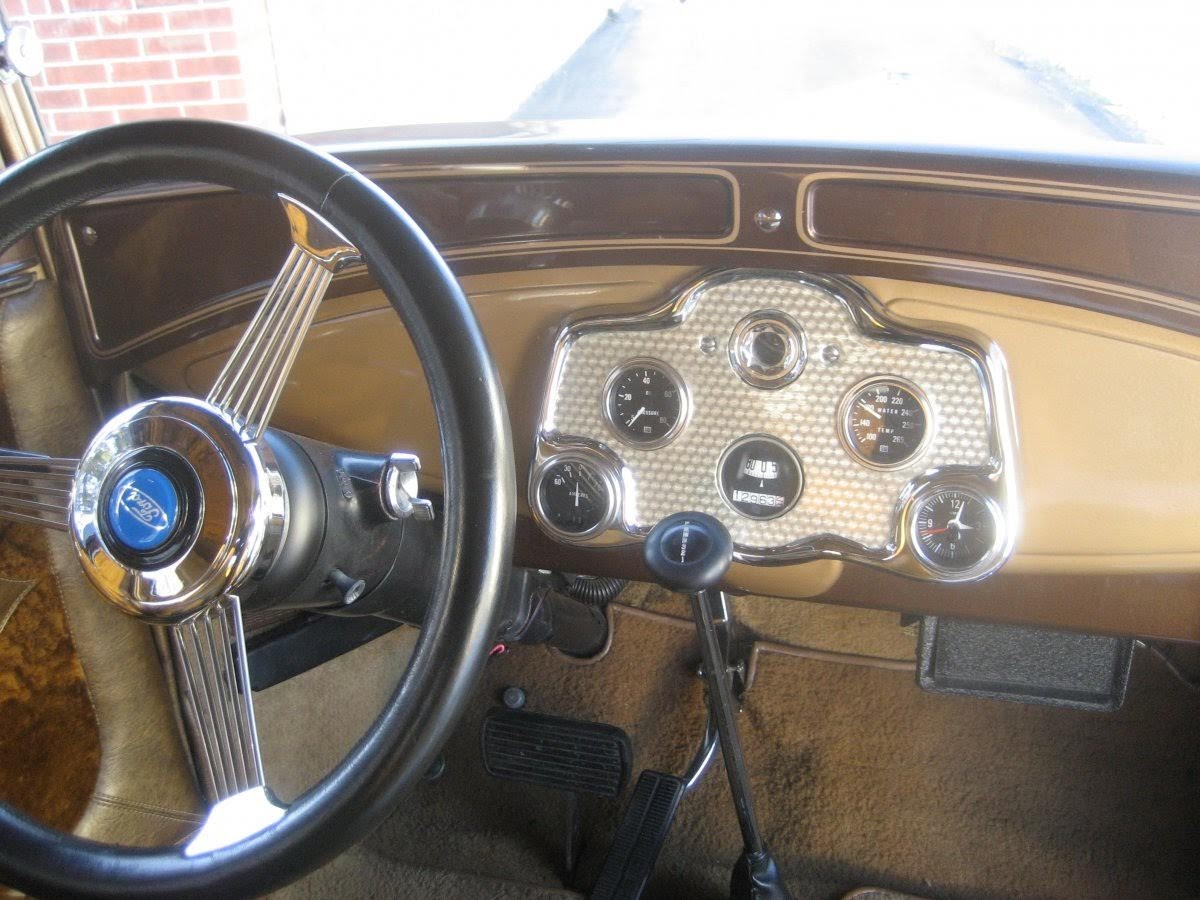

    Is your current tank in useable shape and were you wanting to use it? If not, the options are endless. My sedan had a tank that had already been cut up. I just used the “32 dash for Model As” from one of the street rod vendors. I did add a piece of 2” exhaust tubing cut in half lengthwise and reshaped to resemble a ‘33-‘34 dash rail across the top so it didn’t look like all the other ones. It had a faux “late ‘32 or early ‘33” transition dash look.

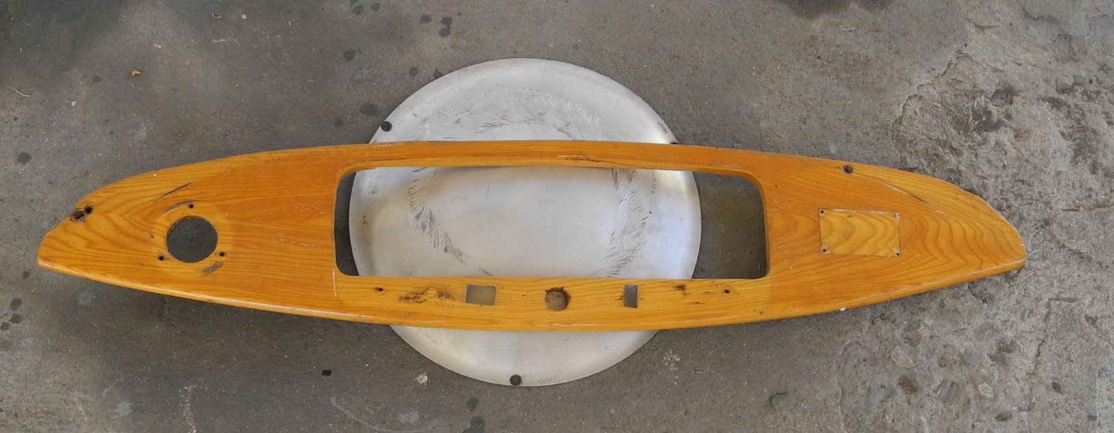

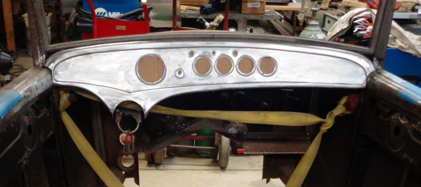

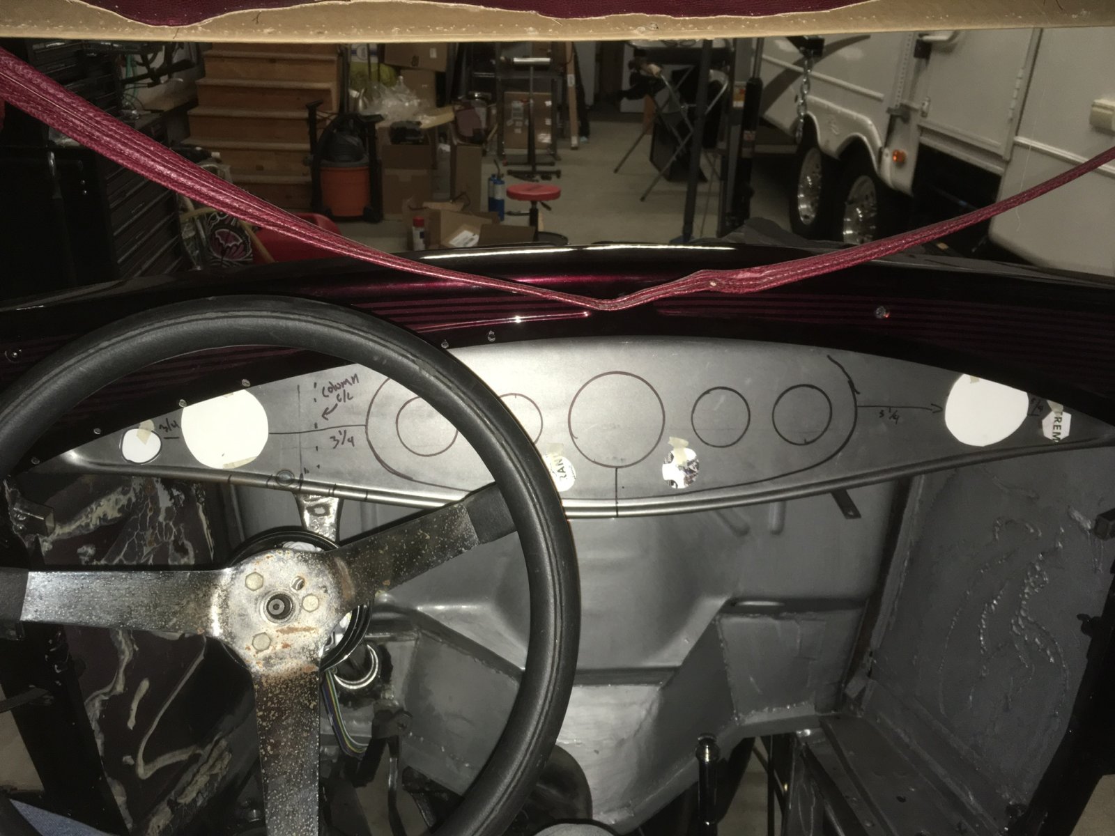

    Still in progress. Victim of the "I know it's going to work, what's the next thing I need to figure out". Bead roller for the recess. Hammer form for the rolled edges. Home made dies for the raised rings around the gauges. Tach will mount to the steering column, left of the speedometer.

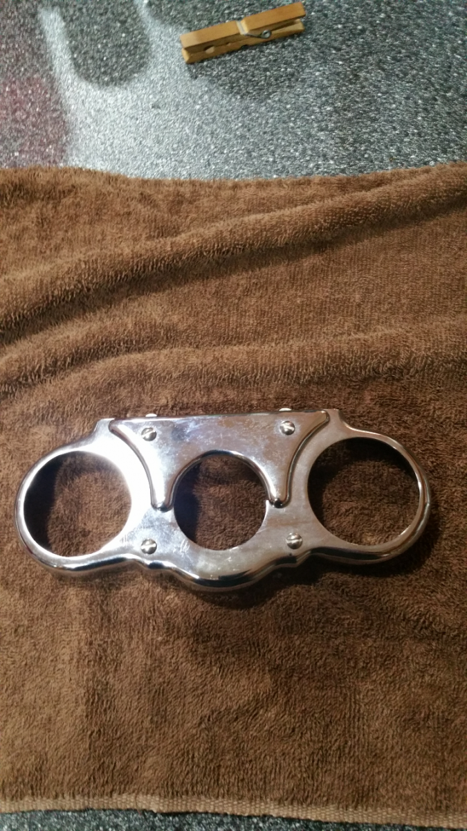

    Many companies make a 2 gauge that bolts to the underside of the stock dash.
    Some other companies make one for the column.
    For a Tach I found a couple of these cups used on eBay since they don't make them anymore. It'll take just a little work to make them less street roddy.

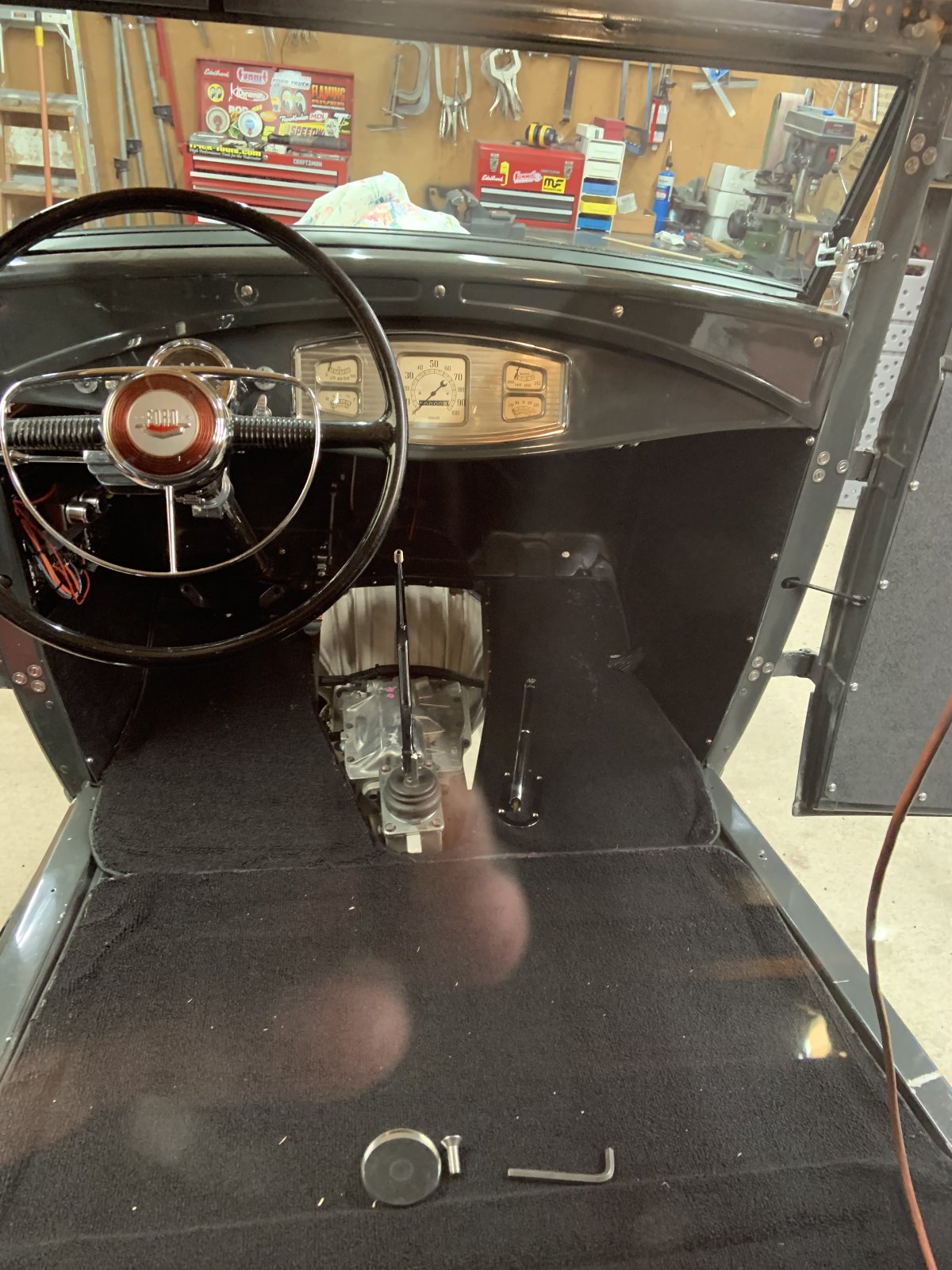

    I used a '33 pickup dash in my '31 Slant-window Sedan...it was almost a bolt-in, once the tank was removed. Sorry about the lousy pic.

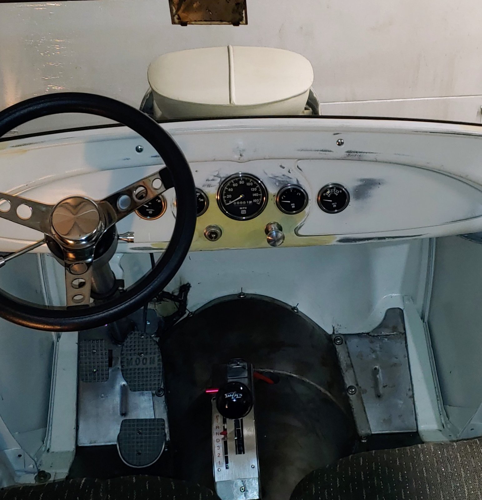

    wandi harry
    Still a work in progress been sidetracked on other projects but I think it will look good

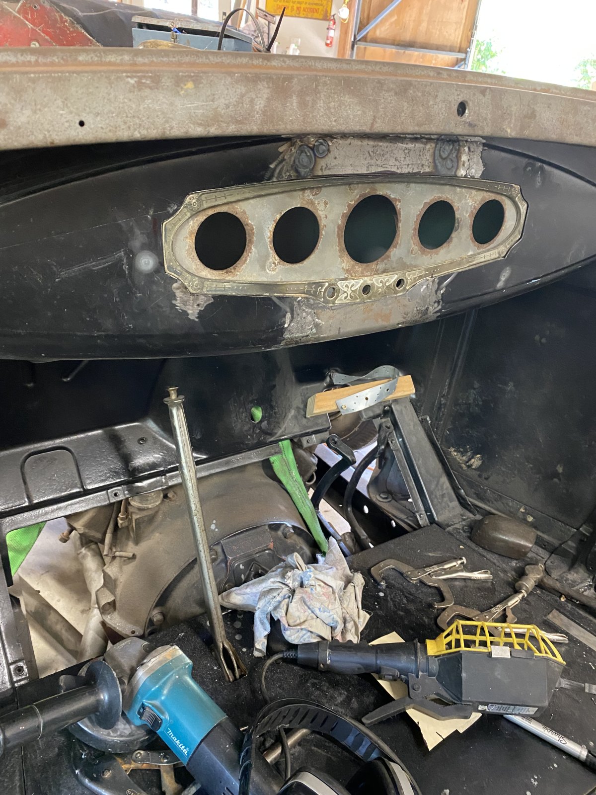

    from UK
    I went for a stock dash install with mods. The original tank is in great condition so didnt want to butcher it.

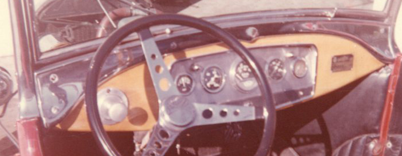

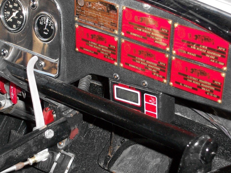

    This one morphed over 57 years . . .
