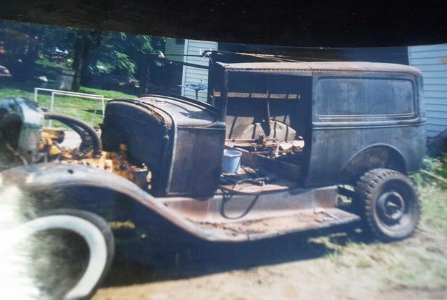

    Well I must have been dreaming when I rebuild this one it's a 1930 deluxe delivery
    I need to start a thread on 1928-1931 sedan deliverys and panel deliverys, I have built and worked on a doz or so of them all year and style and a few 1932- 1948

    Yes, that's a 30/31 but not a sedan delivery, thats a truck based panel.
    To me a sedan delivery is a standard Tudor with the 1/4 windows blanked out and a rear door added, other wise known as the Type 130A Deluxe Delivery Car in 28/29. In 30/31 it was replaced with the Type 130B and had it's own body, not a modified Tudor , it was bigger, and considered a truck. That's what you have pictured here In 1932 the Type 130-B went back to being based on a modified Tudor body. Being based on a Tudor or truck is what I'm referring to, not the name "Deluxe Delivery car".

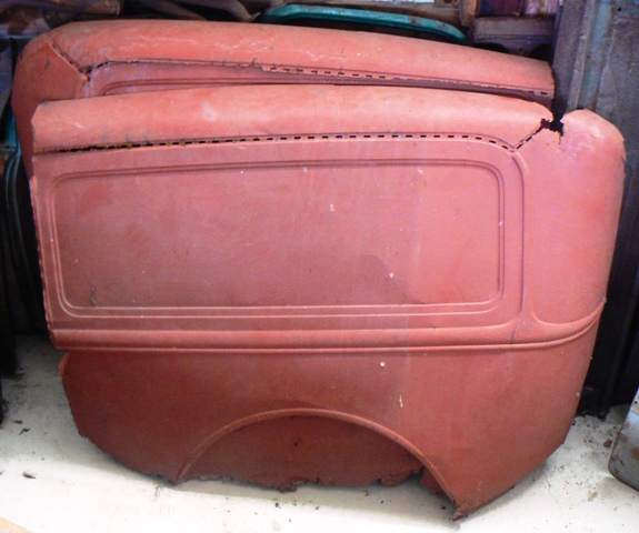

    OK, these are the quarter panels I have, (the lower corner is there, not missing, just bent in slightly)...I'm assuming these are '30-'31 panel truck?

    Mr gasser: Those quarters sure look like 30-31 sedan delivery to me. I have a 31 panel, and the top rear is very squared off. Also the panel truck appears taller.

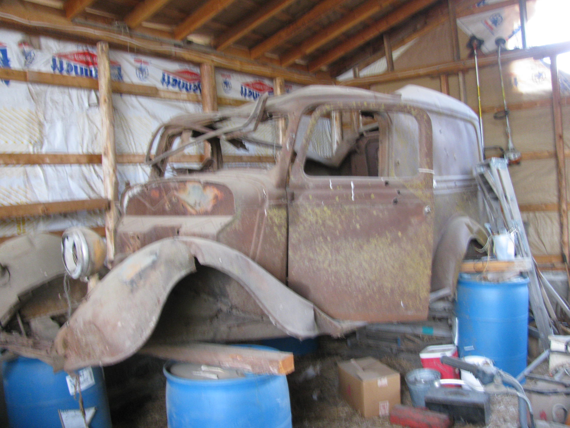

    So what year may this Panel be? The front of the cowl looks 34 ish.

    patterpillar: Sure looks like a '35-'36 to me.

    agreed 35 or 36, 35 grille is thinner and the hood badges are in different places
    37 is a solid roof, grille and hoods are different
