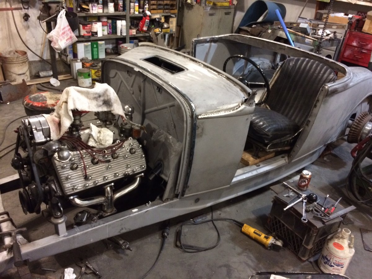

    Looking for some close up pics of the over hang of a Model A body on a deuce frame. Trying to justify whether to pinch the front and rear of the frame to contour the body. Prefer 30-31 sedan

    Both with stock (non pinched) rails with standard width 32 frame. Both with 32 firewall frame2.jpg m11.jpg

    bld3.JPG Also stock width and not pinched. Also with 32 firewall.
