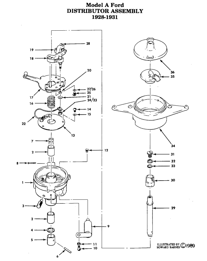

    Here is the diagram I used to guide my ***embly. Looking at it I realized I forgot the #21 fiber washer, but installing it didn't rectify the issue.

    Ahh, the fiber washer DID fix it, I just put it back together wrong afterward. Back in business.
