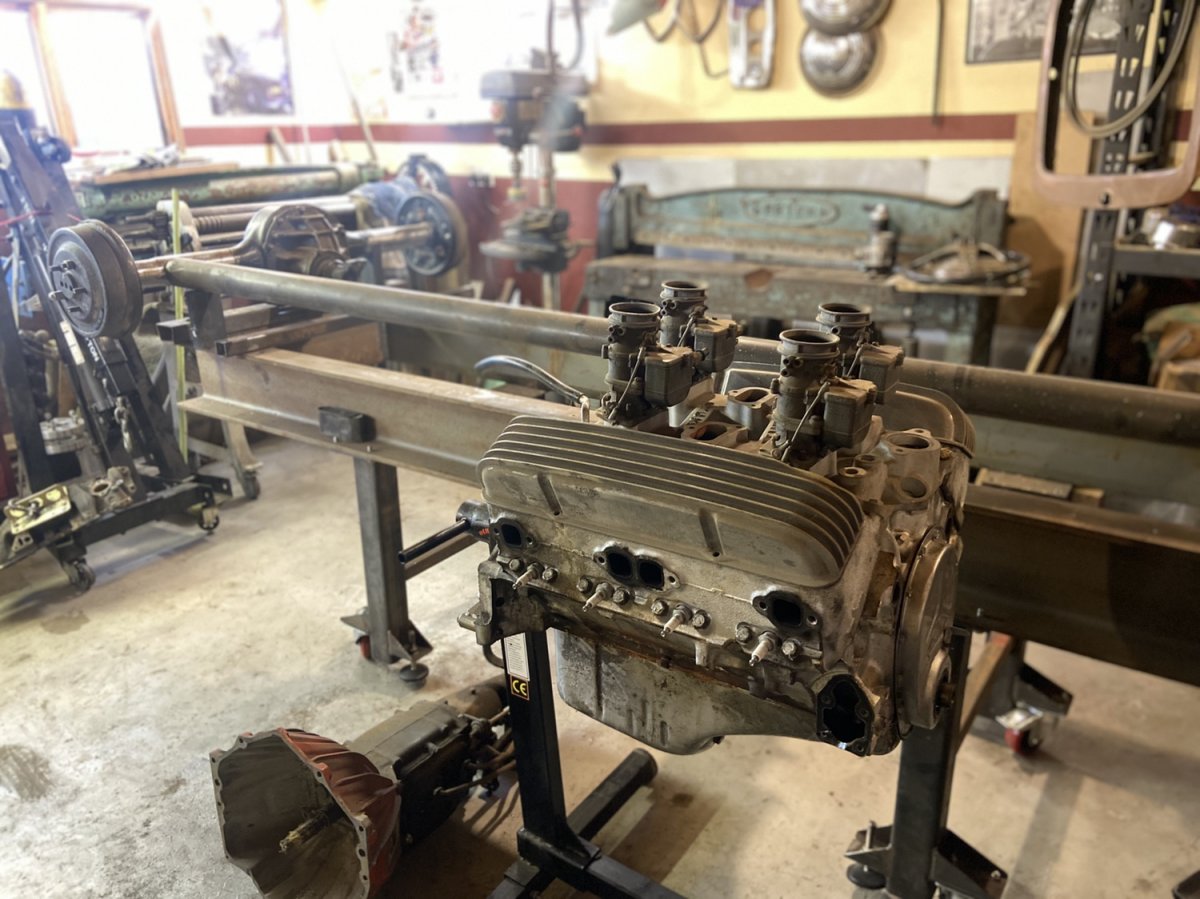

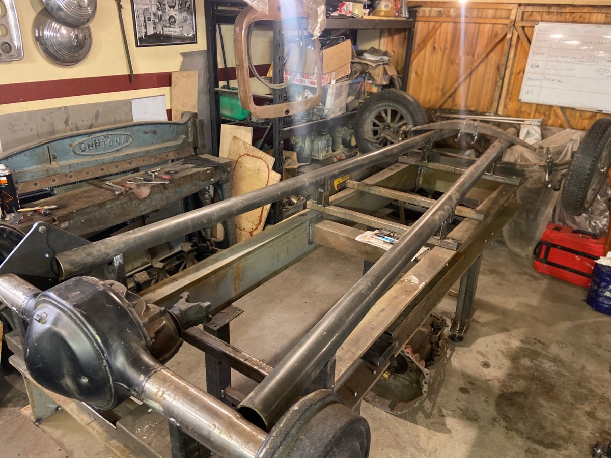

    The big piece I wanted was a big tube ch***is on this car, So I started up with 2 length of 3” diameter seamless CDS tubing for the main rails, got them set up between my axles on the table.

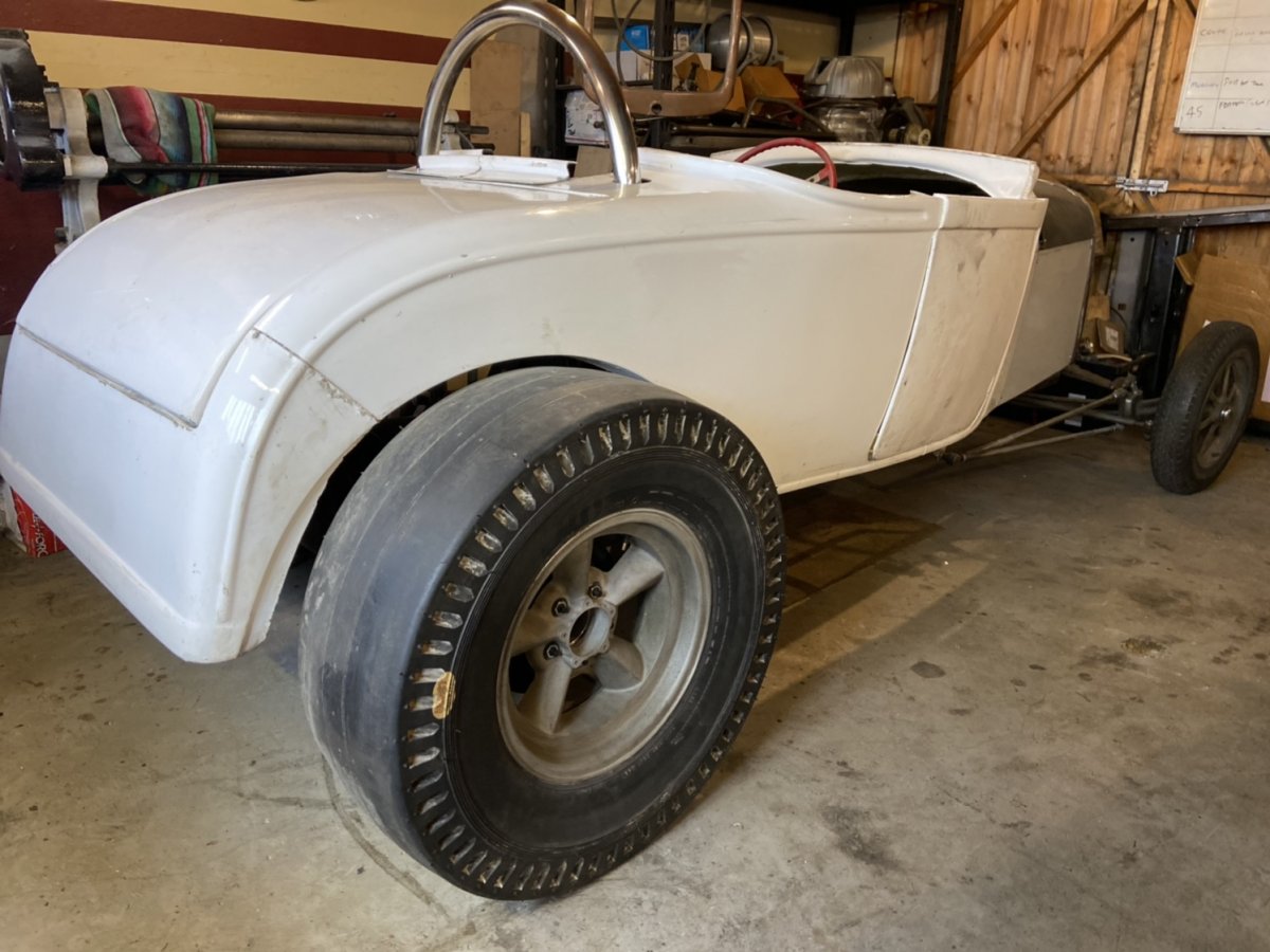

    I then set the body on to get the engine set back set up just right it’s around 15” back from stock’ish so well within the 25% Nhra ruling of the 50’s. and then I got on with working out the prop loop and seat section of the ch***is
    Then with a wheel in the back wheel well to see how the car was looking

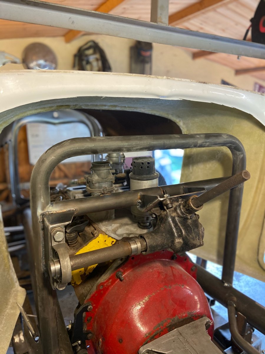

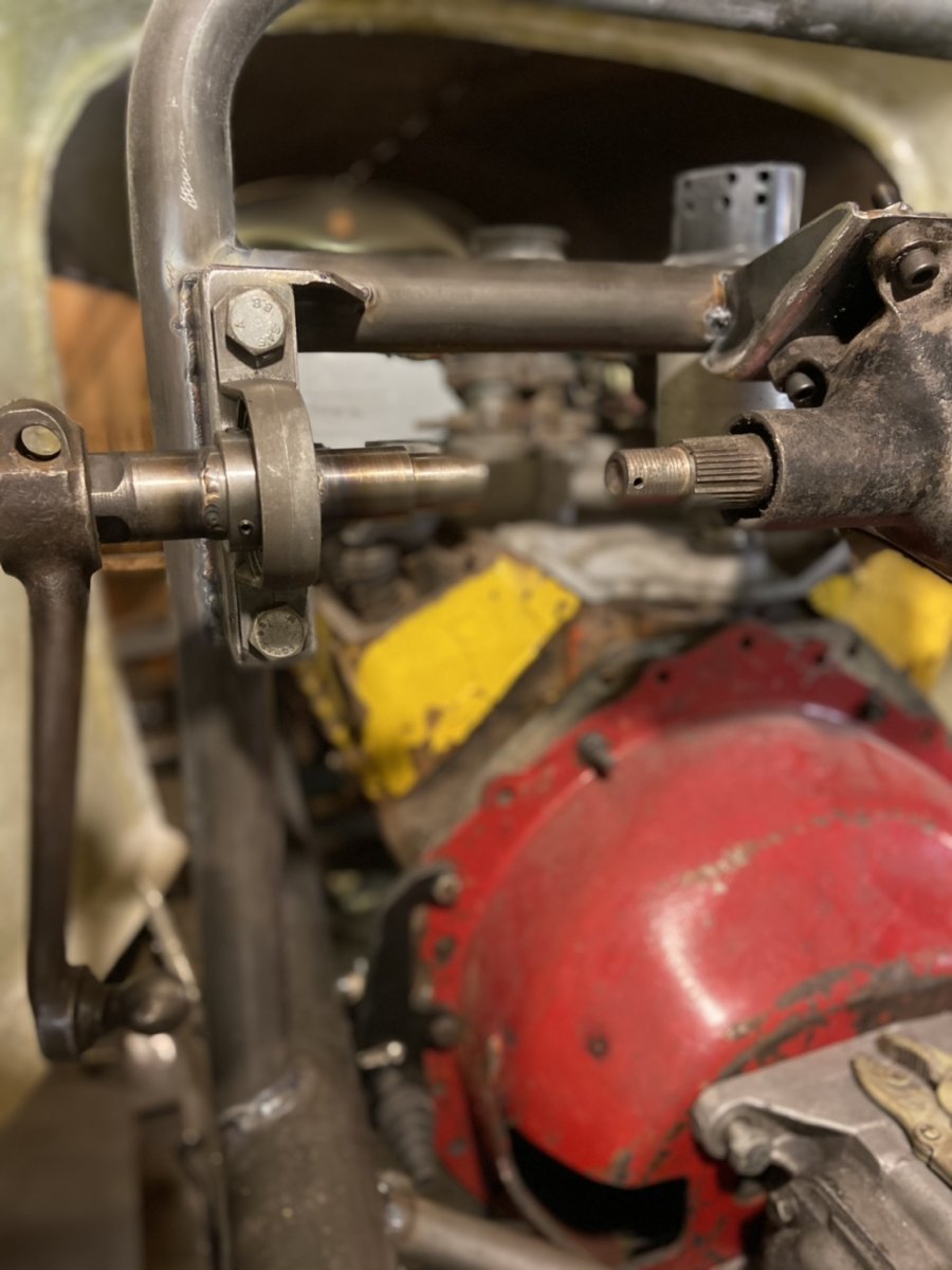

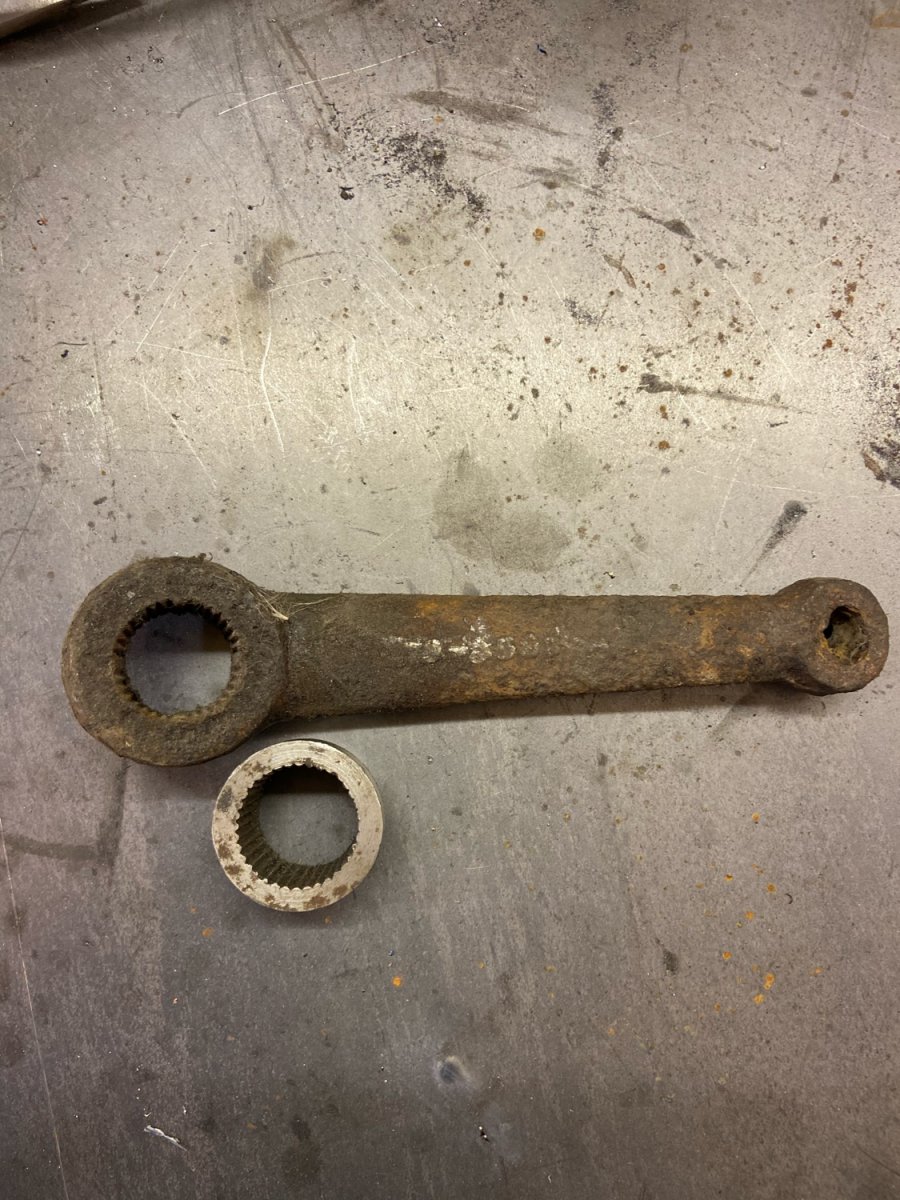

    Next step was the front goalpost and steering set up, this idea has been going around in my head for a few years and I’ve got a stack of steering boxes under the bench so it was good to get these out the way and onto the car.
    Using a 37-48 ford p***enger car box & turned down pitman arm, plus a model A pitman arm and sector shaft. Twinned with some home machining turned out a pretty good homemade sprint car steering set up, the pitman extension will get drilled and pinned onto the ford sector come final ***embly so it will definitely not be going anywhere. And also let’s the box come apart for repair if needed in the future.
    Jigging bar to set up the location of the bearing

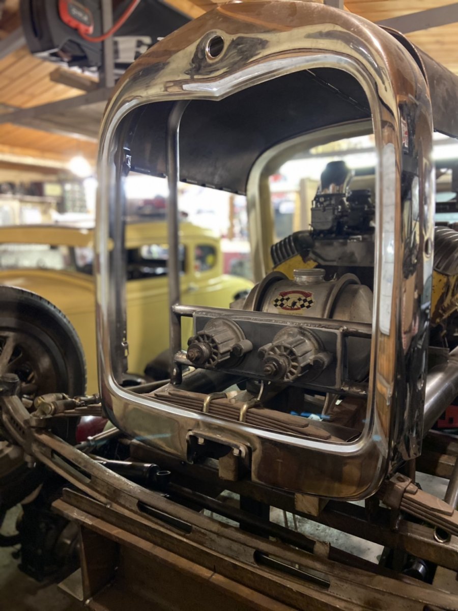

    With the steering box set up worked out next was the front shock and grill mounting goalpost, the back of the shock bracket will also mount the fuel pump and regulator.
    Then made a shifter up, running the Muncie and centre steering made for some fun trying to kick this up the side of the seat, it seems to work good. But we’ll see when we’re taking it down the strip and trying to bang shift it! IMG_7708.JPG

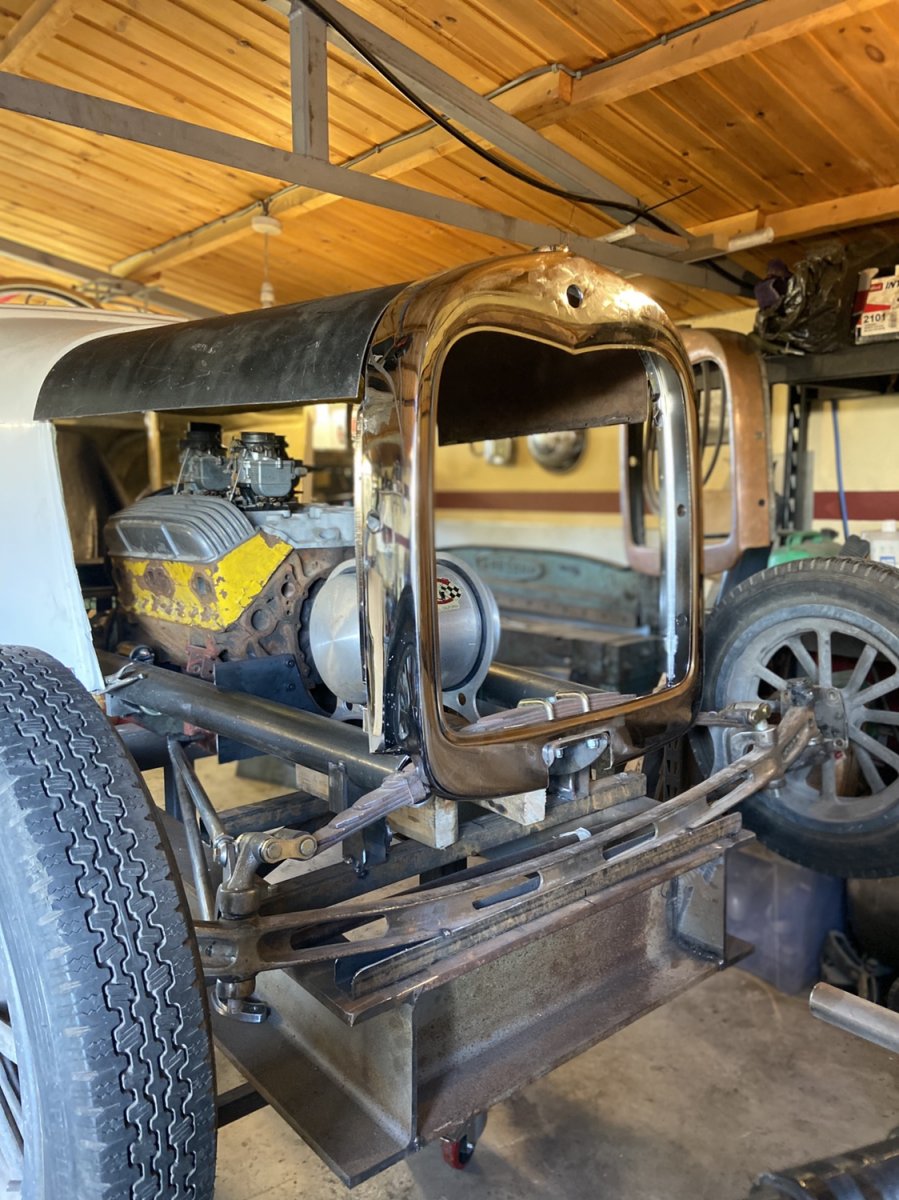

    Got the hoodsides made up, will also make a Aluminium hood top and this will all be bolted together and removed as one piece with the grille. Also got the real tyres I’m running nicked up at the rough height. IMG_7857.JPG

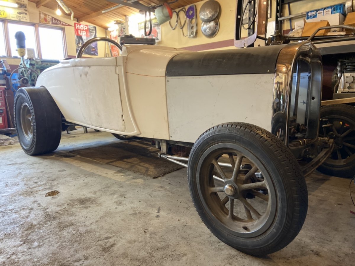

    Now with the wheels purchased too I got them mounted up and in place. Next was to work out the headers, pretty glad with how these look so need to finish up the other side to match.
    That now brings us up to today, with another job for my ch***is table I needed to get the car pulled off so I got that done, a few more bits got done. I’ll try and work on the car as and when I can and keep everyone updated, it will hopefully be out on track some time this year. Just glad it’s all finally coming together how I’ve always imagined it. IMG_8994.JPG

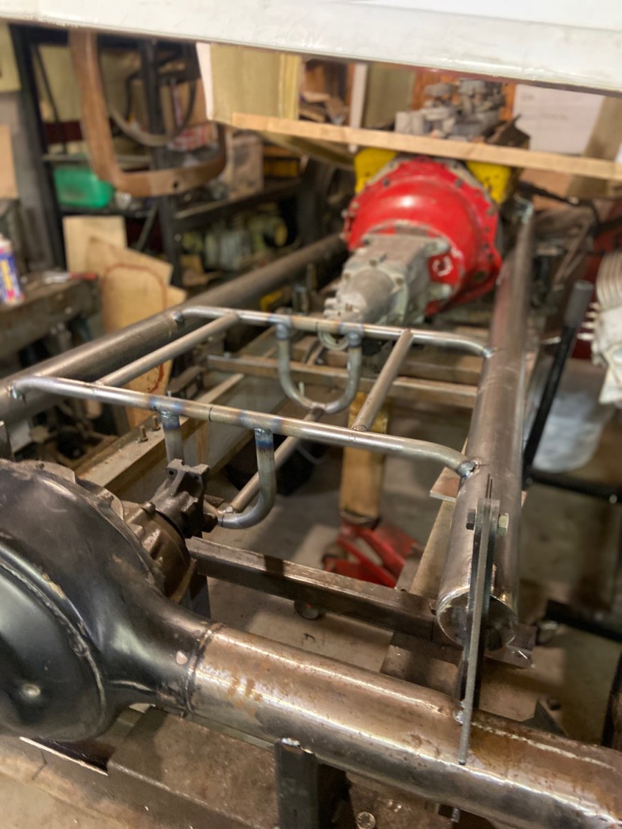

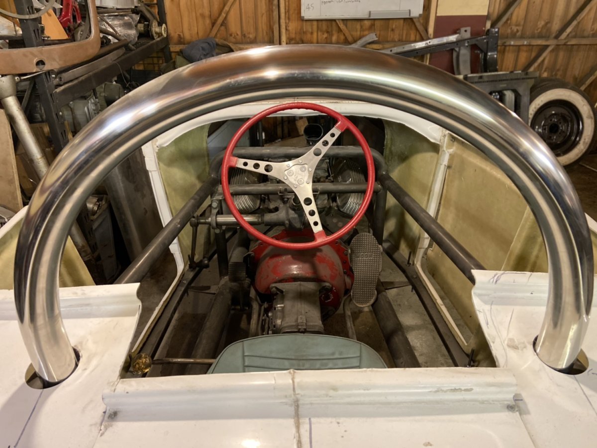

    Top half of the ch***is all roughed up and roll bar set. Radiator to mount & a couple other things to work out and then the ch***is should be pretty much done bar finish welding, then onto the body.
    The stainless hoop will be removable by pins & clips through the solid bosses on the ch***is Tubing and then a bolted plate on the down tube to the top of the diff housing. Then making the body totally removable leaving the ch***is intact, the goal is to have a totally driving ch***is with the body as a just a skin on top.

    Have a question; exactly how do you intend to secure the extension shaft you built to the output shaft of the steering box? Every other time I've seen this done the splined portion of the pitman arm that you cut off and machined round was welded to a tube and a nut used to secure the tapered splined portion of the fabricated extension shaft to the tapered splined output shaft of the steering box. With a solid extension shaft, like you built, I see no possible way of properly securing the extension shaft to the steering box output shaft.
  26. Equipped28
    Joined: Mar 30, 2007
    Posts: 635
    Equipped28
    like I said in the write up on the steering I will be drilling the sector and extension and putting a pin through to tie them together for extra safety, but there is a built in dead stop up against the support bearing, so there is no physical way it can come apart unless the whole ***embly is taken off the car
  27. junkman8888
    Joined: Jan 28, 2009
    Posts: 1,091
    junkman8888
    "Pinning" your extension shaft to the steering box output shaft would be acceptable if you were working with a regular splined connection (like a rear axle shaft in a pinion gear) but you're working with a tapered spline connection which requires a "force fit" to be safe, as in big nut drawing the pitman arm on the steering box output shaft. The way you are doing it will eventually fail.
